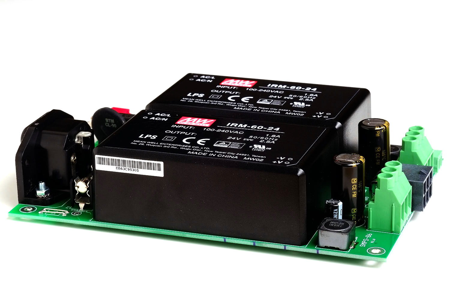

Those of you who are on the fence about the SMPS-86 might consider getting off the fence and onto the internet. I have three boards left and will likely not make more of them. It's a pretty slow seller and there are many more SMPS options available now than when I designed the circuit.
The SMPS-86 is an excellent candidate for a desktop LM3886-based amp, such as the Modulus-86. With that supply, an LM3886-based amp will deliver 28 W into 8 Ω and 28 W into 4 Ω. However, due to the current limit of the switching power supplies used on the SMPS-86, you will only get 2x14 W into 4 Ω if you build a stereo amp.
Thus, the SMPS-86 is mostly suited for mono blocks, for amps driving 8 Ω speakers, and desktop amps.
The SMPS-86 provides ±24 V @ ±2.5 A by default. It can be built for ±5 V (±10 A), ±12 V (±5 A), and ±15 V (± 4 A) as well. Many use it to power preamps and it would be an excellent, albeit a bit overkill, power supply for my Universal Buffer.

Is there a chance you will be making any more of the SMPS-86 power supplies?
It was a really slow seller and many better options exist in the market now. So I'm rather hesitant to make the circuit more broadly available. I can make you a custom run at custom prices, though...
