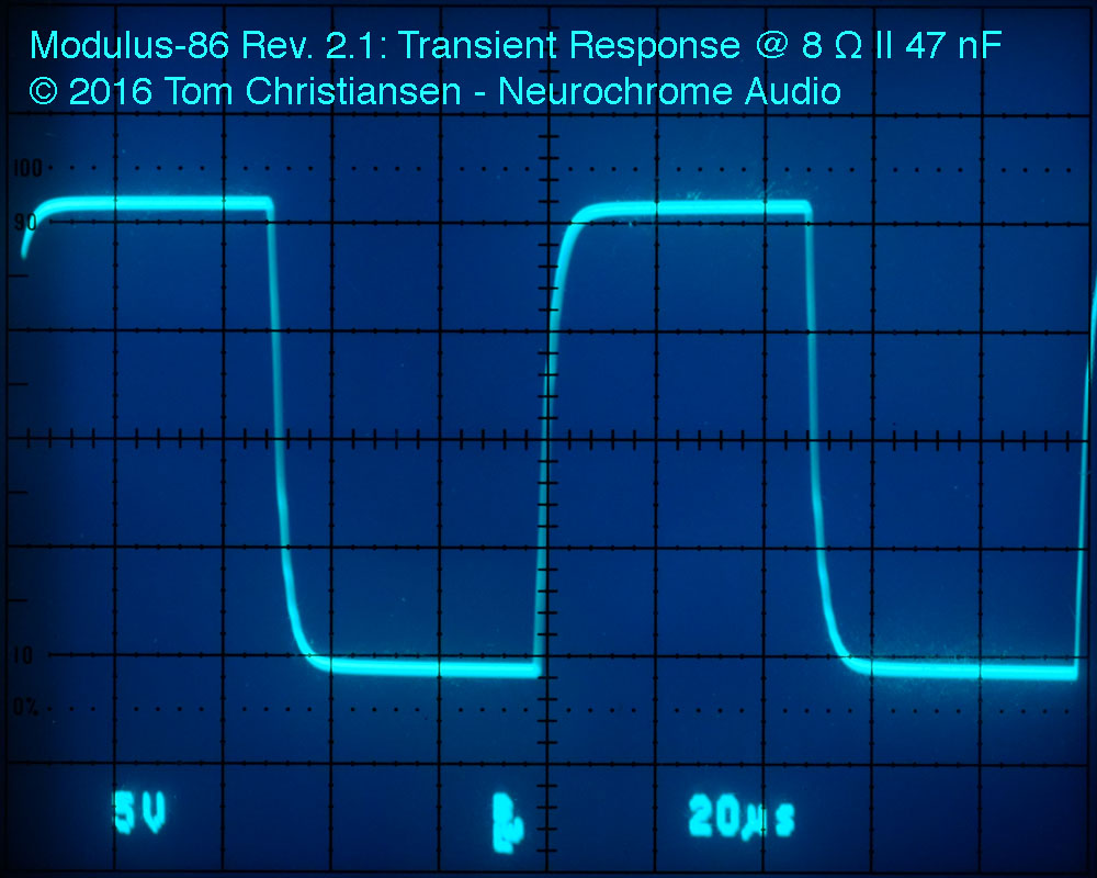

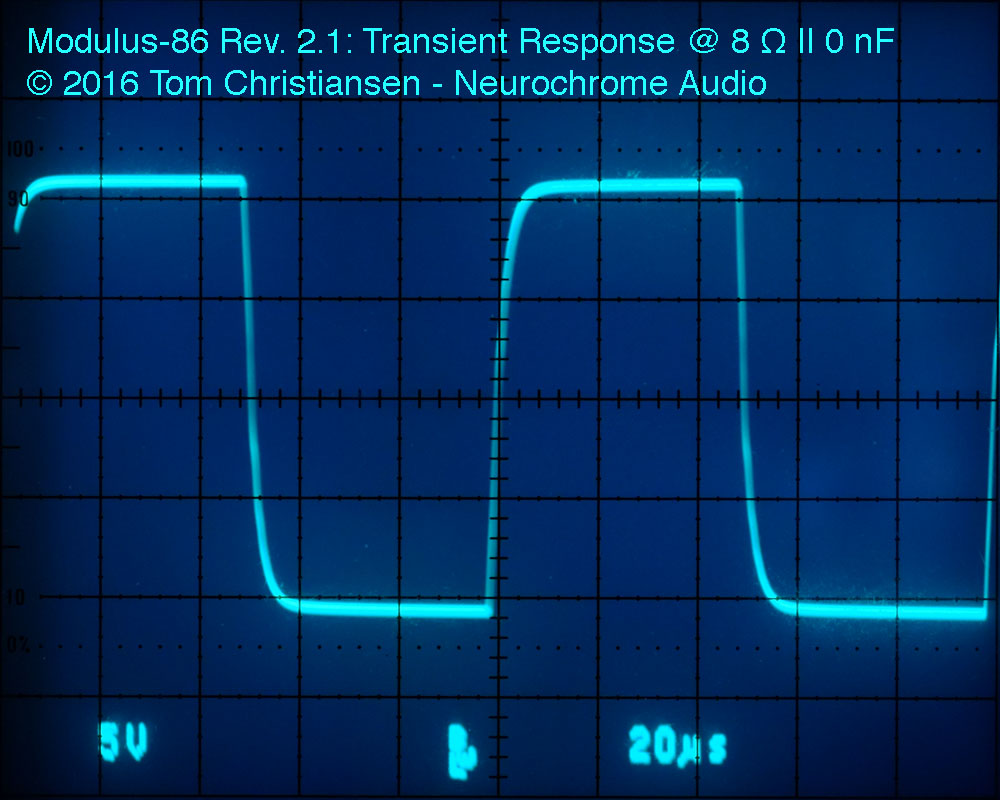

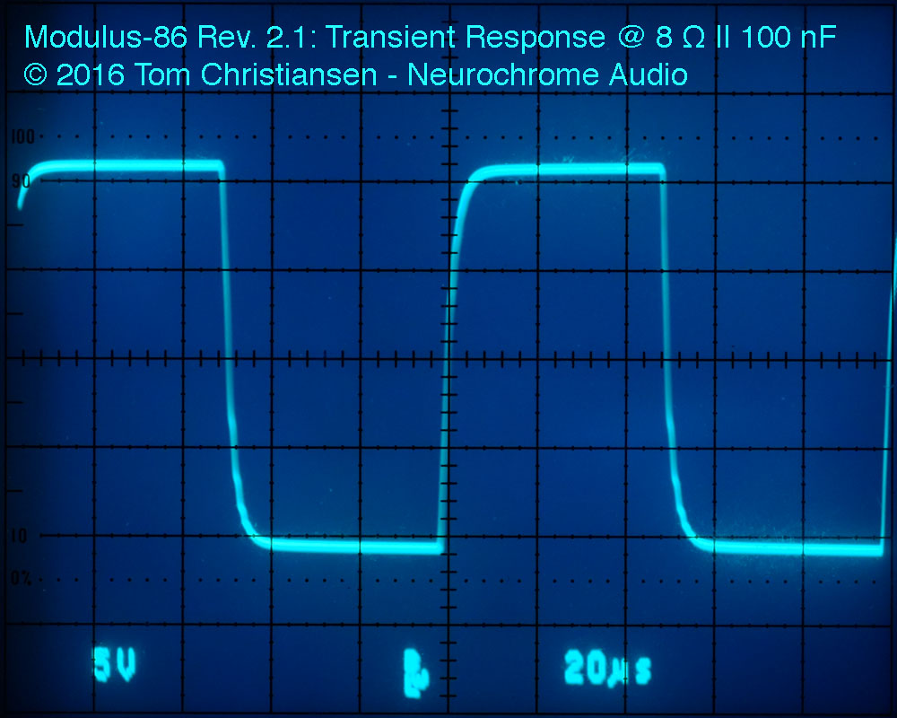

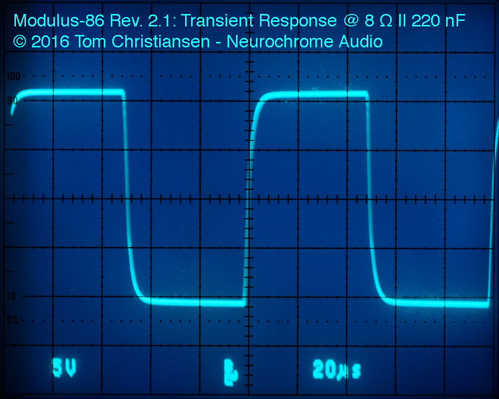

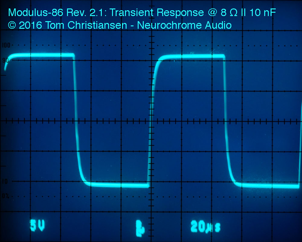

Ok got it. Thanks.
1) One more. Is the Mod286 / 86 ability to drive a 1uF load without ringing considered ok, good or great?
I just don't have a comparison with other amps and therefore no real reference for a judgement. For example the THD values of the Mod286 one can compare with reference values and I guess we all agree the Mods really shine in comparison to other power
2) You said my speakers wouldn't show any ringing when driven by the Mod286 under any conditions. How would I be able to tell by only looking at data for example for different speakers? (Please I don't want to challenge what you said, but just trying to learn)
Thx
SH
I've attached the transient response of the MOD86 driving 8 Ω || 0.01 - 1.0 uF. I'd say it's very well controlled.
Dig up an amplifier review from the 1980ies. It was a common test to run then. At least I seem to recall several magazines using it.
I think you're trying to split hair here. Or maybe I'm over-interpreting. The amp will deliver a clean signal to the speaker. If the speaker is under-damped, it could still show ringing. That's determined by the speaker characteristics and not the amp characteristics. I'm not in control of the speaker characteristics.
"Any conditions"? Even if the amp is submerged in salt water? Where does "any conditions" end?
As far as I can figure, your speaker is a regular dynamic driver in a box. As such it tends to be pretty well-behaved as a load. I know the MOD86/286 well enough to know that it will perform flawlessly when presented with such a load. Therefore, I am confident that it will drive your speakers well.
Had your speakers been an electrostatic type, I'd examine the impedance curve more closely as those types of speakers tend to be rather capacitive. This shows as a decrease in speaker impedance vs frequency. Thankfully, while many electrostatic speakers are rather capacitive and present a low impedance through the audio band, the inductance of the step-up transformer prevents the capacitance from getting out of hand at frequencies beyond the audio band. Thus, this type of speakers aren't as challenging for amplifier stability as many would like to believe.
You can be confident that the MOD86/MOD286 will deliver a clean signal free of ringing to your speakers. What your speakers do with that is beyond my control but can be deduced from impulse response measurements and waterfall plots of your speakers. Looks like pretty nice speakers, by the way. I'm curious what goes on at 15-ish kHz in the waterfall plot, though.
