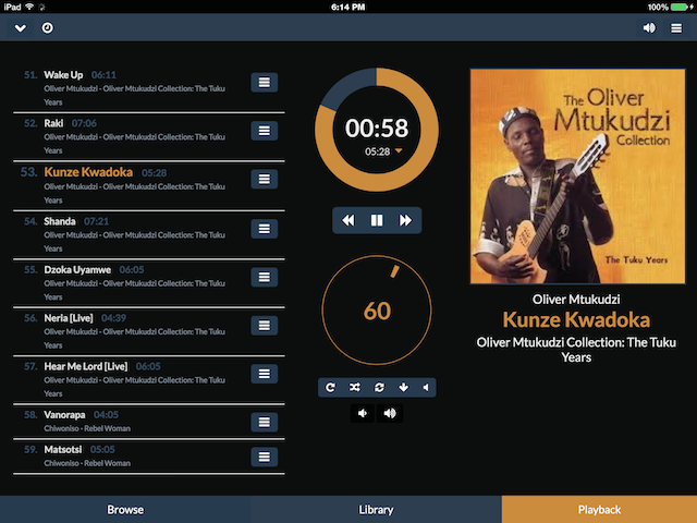

Moode release 2.0 is available for download at tcmods.org 🙂
This release includes Logarithmic volume control with adjustable slope and max volume capping for audio devices with hardware volume controllers, support for IQaudIO Pi-DigiAMP+ and Hifimediy ES9023 audio devices, selectable album art lookup methods and new Linux kernel 3.18.14 with improved ALSA audio subsystem, updated I2S overlay drivers, and other fixes and improvements.
Also included in this release are some great new radio stations and a variety of updates and bug fixes. Refer to the attached release notes for details.
Enjoy!
tcmods.org
Moode on Twitter
TC
2.0 Release 2015-06-26
New features

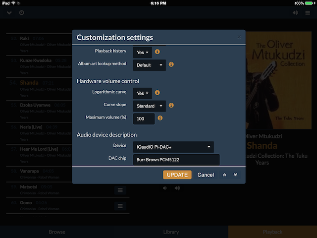

- NEW: Logarithmic volume curve for hardware volume controllers
- NEW: Support for IQaudIO Pi-DigiAMP+ and Hifimediy ES9023 I2S audio devices
- NEW: Album art lookup methods: Default, EAC, Embedded (place holder), All
- NEW: Linux kernel 3.18.14+ (default) and 3.18.11+ added to kernel select

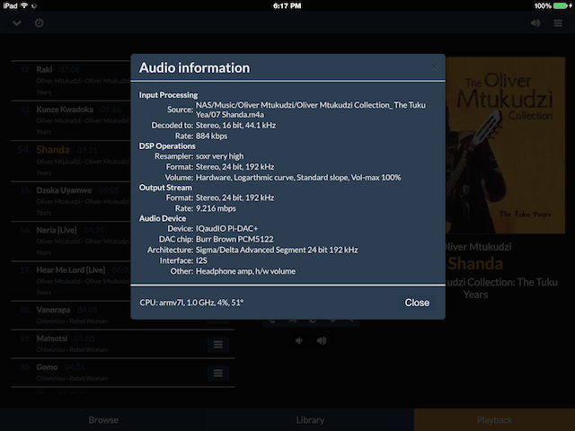

- UPD: Improved volume mute management
- UPD: Add Volume settings to Audio info popup

- UPD: Add first/last page btns to Customization settings popup
