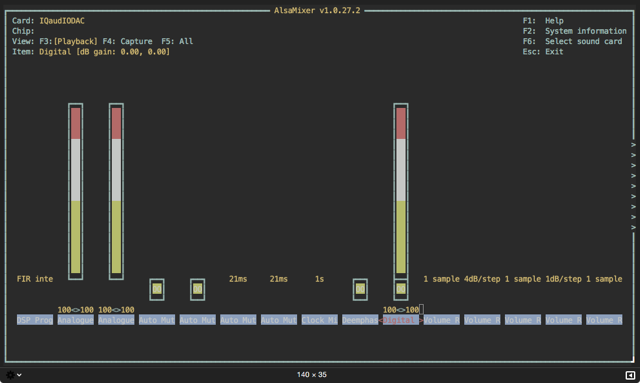

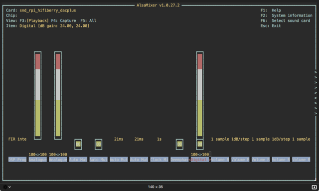

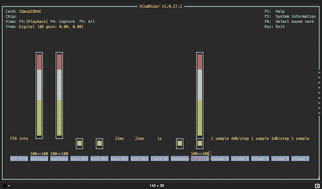

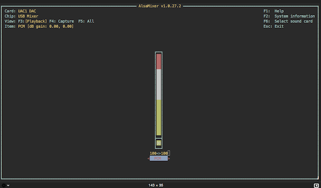

I have 3 DAC's that have hardware volume controllers: IQaudIO Pi-DAC+, Hifiberry DAC+ and JDS Labs ODAC. The IQauDIO and Hifiberry devices use the same Burr Brown PCM5122 DAC chip and so I just test with the IQaudIO and ODAC devices.
Attached are screen shots of alsamixer for IQaudIO and ODAC. They show that for both devices the 0dB point is 100 on the main volume slider. Main volume is named 'PCM' for the ODAC and "Digital" for the IQaudIO device.
The IQaudIO device also has 2 analog volume controls named 'Analogue'. According to IQaudIO guy, these need to be set to 100 for 0dB overall for the device.
Note that the ALSA main volume can be set from Moode System config page.

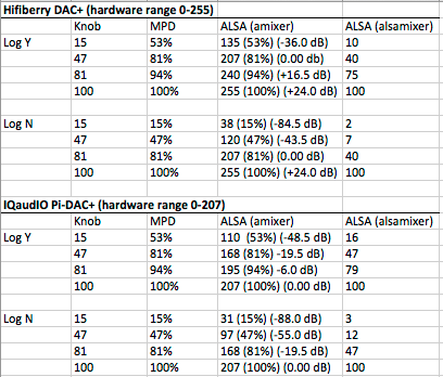

The Moode volume control maps knob 0-100 range to alsa 0-100 range using either a 1-1 (linear) mapping or a logarithmic mapping depending on the Yes/No Logarithmic setting on the Customize popup.
I just tested a Hifiberry DAC+ on 3.18.14 kernel and alsa 100 = a whopping +24dB gain! The 0dB gain point is reached at a very low alsa 40. This suggests an issue in the Hifiberry device driver. I think the driver is responsible for establishing the correct hardware to alsa 100 = 0dB gain mapping, but could be wrong about that.
Here is what the Moode -> ALSA volume mapping looks like for this DAC with Logarthmic volume on/off.
LOG YES: knob 47 = alsa 40 = 0dB
LOG NO : knob 81 = alsa 40 = 0dB
EITHER : knob 100 = alsa 100 = +24dB
A workaround that will achieve knob 100 = alsa 81 (0dB) is:
(1) set Logarithmic volume OFF
(2) set Max volume(%) to 81
NOTE: for the IQaudIO Pi-DAC+ which uses the same PCM5122 chip as Hifiberry DAC+, knob 100 = alsamixer 100 = 0dB gain.
Refer to attached Hifiberry and IQaudIO alsamixer screen shots.
Tim

Can you explain what alsa 40 vs. alsa 81 means?
Isn't it just a different (display) mapping?
I can only see that reducing the alsa volume in the GUI to, for example,
20% just reduces the amixer sget Digital value to 67%. Anything else?
BTW: amixer sset Analogue 0/1 reduces/increases the output by 6dB
I don't know at which point in the signalprocessing this occurs

(1) Volume: Hardware, Logarthmic curve, More (+18) slope, Vol-max 81%
Interesting. I see that selecting logarithmic curve and a steep slope (More +18) also compensates for the mapping issue in the Hifiberry driver.
(2) Can you explain what alsa 40 vs. alsa 81 means? Isn't it just a different (display) mapping?
One of the challenges associated with volume is that there are several different unit scales in use that are all related to one another through math. I should have used the term Alsamixer instead of alsa... Alsamixer units are different than the percentages shown in MPD and amixer. See NOTE #1 below.
The volume mapping in Moode works by taking the knob setting and computing the appropriate logarithmic value then setting MPD volume to this value. MPD uses a percentage scale. If logarithmic volume is set to No then MPD volume is set to the knob value as-is.
Attached is a screen shot of Hifiberry and IQaudIO examples with added volume scales. The data suggests the Hifiberry DAC+ driver might be reporting an incorrect hardware volume range to ALSA.
(3) BTW: amixer sset Analogue 0/1 reduces/increases the output by 6dB. I don't know at which point in the signalprocessing this occurs
Since they are analog controls I would assume they receive the signal after the DAC stage. According to the IQaudIO guy, the two analogue volume controls in PCM5122 should both be set to 100. I assume it's the same for the Hifiberry DAC+
NOTE #1: (from an old 2011 alsa devel maining list)
"Now, alsamixer shows the percentage in a different way. It's
explained well in the source code (alsamixer/volume_mapping.c), but
not mentioned in the man page, unfortunately.
* The mapping is designed so that the position in the interval is proportional
* to the volume as a human ear would perceive it (i.e., the position is the
* cubic root of the linear sample multiplication factor). For controls with
* a small range (24 dB or less), the mapping is linear in the dB values so
* that each step has the same size visually. Only for controls without dB
* information, a linear mapping of the hardware volume register values is used
* (this is the same algorithm as used in the old alsamixer).
The percentage representation in alsamixer corresponds to this
mapping, thus it's neither dB nor linear percent."
