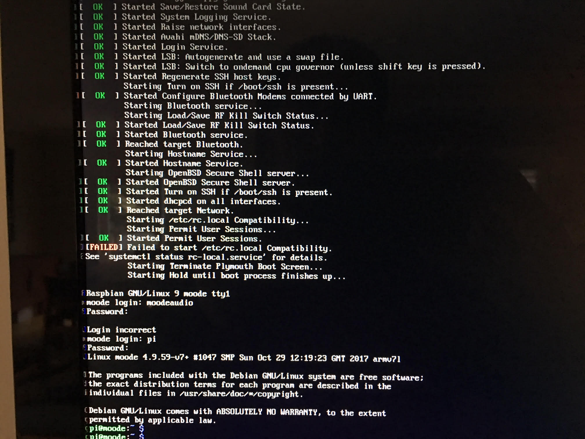

The single card Heeboo method worked very well for me. Loaded Raspian lite onto a brand new SD card in the RPi3. Downloaded Heeboo’s script. Said “yes” to all the options, set it running and went off to watch Harry Potter and the Chamber of Secrets!
Two hours later, loaded card into my RPi-Z W, configured t’ethernet and NAS, and before one could say Expelliamus it was playing music. Job done!
I got my usb-microSD card reader.
After booting with the new Sd card, moode is asking for “moode login”?
I don’t remember setting up a moode specific login?

Thanks Jonners - the userid and password worked.
That being said, not much happened after I logged in. I'm now stuck on the following screen:
I'm connected to the internet via wifi. Does that impact install in any way?
No but something goes wrong !
Could you please post the last lines of /home/pi/mosbuild.log ?
(tail -20 /home/pi/mosbuild.log)
This is the log of the automatic builder
