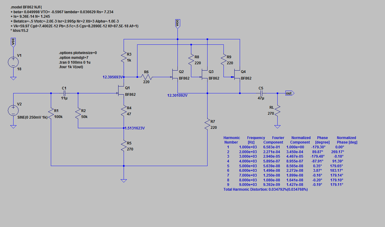

The above amp now simulated "as-built" shows a terrific harmonic distortion profile, which explains why my buddy preferred it immediately over a Super CMOY using an OPA1688. He was so happy listening to it, I gave him the amp as a new years' present.
Schematic and HD analysis with 0.035% THD at 1.2v p-p output, mostly H2 and very little H3, and nothing else:

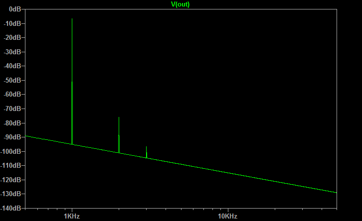

FFT:
![590040d1483637472-mosfet-source-follower-headamp-4-jfet-bf862-aksa-amp-fft.png](https://www.diyaudio.com/forums/attachments/solid-state/590040d1483637472-mosfet-source-follower-headamp-4-jfet-bf862-aksa-amp-fft.png)
At more modest, normal listening levels of 500mV output p-p, THD is only 0.014%:
Harmonic Frequency Fourier Normalized Phase Normalized
Number [Hz] Component Component [degree] Phase [deg]
1 1.000e+03 2.634e-01 1.000e+00 -179.30° 0.00°
2 2.000e+03 3.602e-05 1.368e-04 89.85° 269.15°
3 3.000e+03 1.861e-06 7.067e-06 -179.47° -0.17°
4 4.000e+03 1.758e-08 6.674e-08 -58.31° 120.99°
5 5.000e+03 7.724e-09 2.933e-08 -0.09° 179.21°
6 6.000e+03 6.033e-09 2.291e-08 -0.15° 179.15°
7 7.000e+03 5.088e-09 1.932e-08 -0.23° 179.07°
8 8.000e+03 4.369e-09 1.659e-08 -0.26° 179.04°
9 9.000e+03 3.800e-09 1.443e-08 -0.27° 179.03°
Total Harmonic Distortion: 0.013697%(0.013636%)
I think this 4 BF862 head amp is superb bang for the buck. This amp can be made for literally under $3.

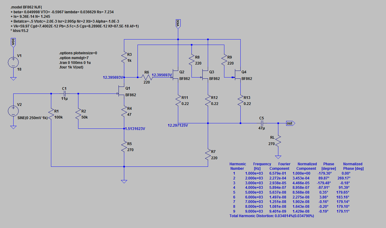

I had a strange idea (with no theory or anything behind it!) so don't laugh -
What happens if/when you add some small local degeneration resistors to those output jfets just like a power amp?

Actually, Cal was the first to call me X over in the Full Range Forum.
I had degen resistors at one point but this BF862 has such a good transconductance that we try to eliminate it and match the JFETs to get the best punch for bass. I can run a quick sim with say 0.22R's and see what happens.
Here is the sim with 0.22R's added:
1 1.000e+03 6.579e-01 1.000e+00 -179.30° 0.00°
2 2.000e+03 2.272e-04 3.453e-04 89.87° 269.17°
3 3.000e+03 2.938e-05 4.466e-05 -179.48° -0.18°
4 4.000e+03 5.894e-07 8.958e-07 -87.91° 91.39°
5 5.000e+03 5.637e-08 8.568e-08 0.35° 179.65°
6 6.000e+03 1.497e-08 2.275e-08 3.86° 183.16°
7 7.000e+03 1.251e-08 1.902e-08 -0.16° 179.14°
8 8.000e+03 1.081e-08 1.643e-08 -0.20° 179.10°
9 9.000e+03 9.401e-09 1.429e-08 -0.19° 179.11°
Total Harmonic Distortion: 0.034814%(0.034790%)

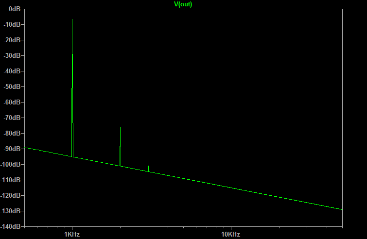

![590084d1483649005-mosfet-source-follower-headamp-4-jfet-bf862-aksa-amp-fft-022r-degen.png](https://www.diyaudio.com/forums/attachments/solid-state/590084d1483649005-mosfet-source-follower-headamp-4-jfet-bf862-aksa-amp-fft-022r-degen.png)
About the same - but would mean JFETs don't need to be as carefully matched.
I'll have to build new amp as I just gave that amp to my friend. I was planning on making another batch. This time with tiny footprint to fit in Altoids mint tin for a true pocket class A amp. I know it runs on two 9v batteries well. Have to wait for my order of 50 BF862's to come in. I'm about all out of them now. Will need to match them and find two triplets again. I will leave space for the degeneration resistors though. Maybe 2.2R even?

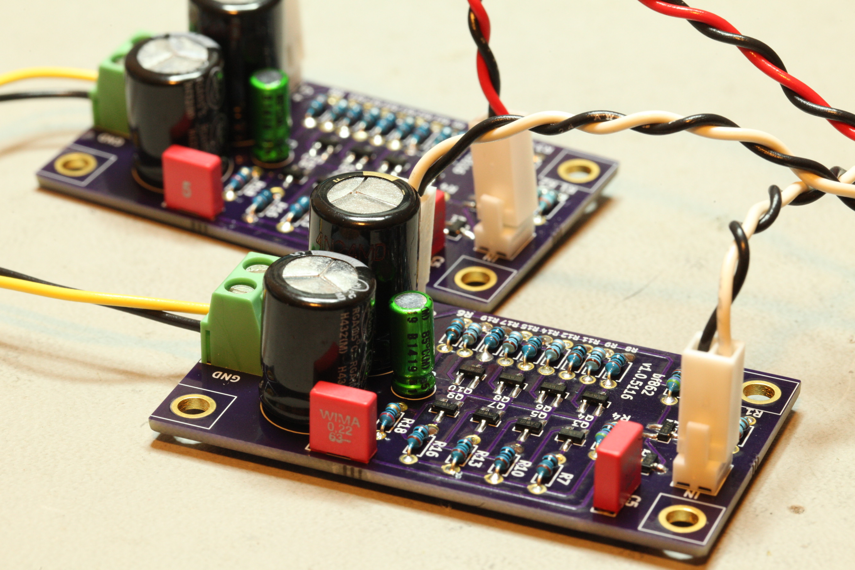

Check out these 10 x BF862 SE Class A amp boards by Mlackey:

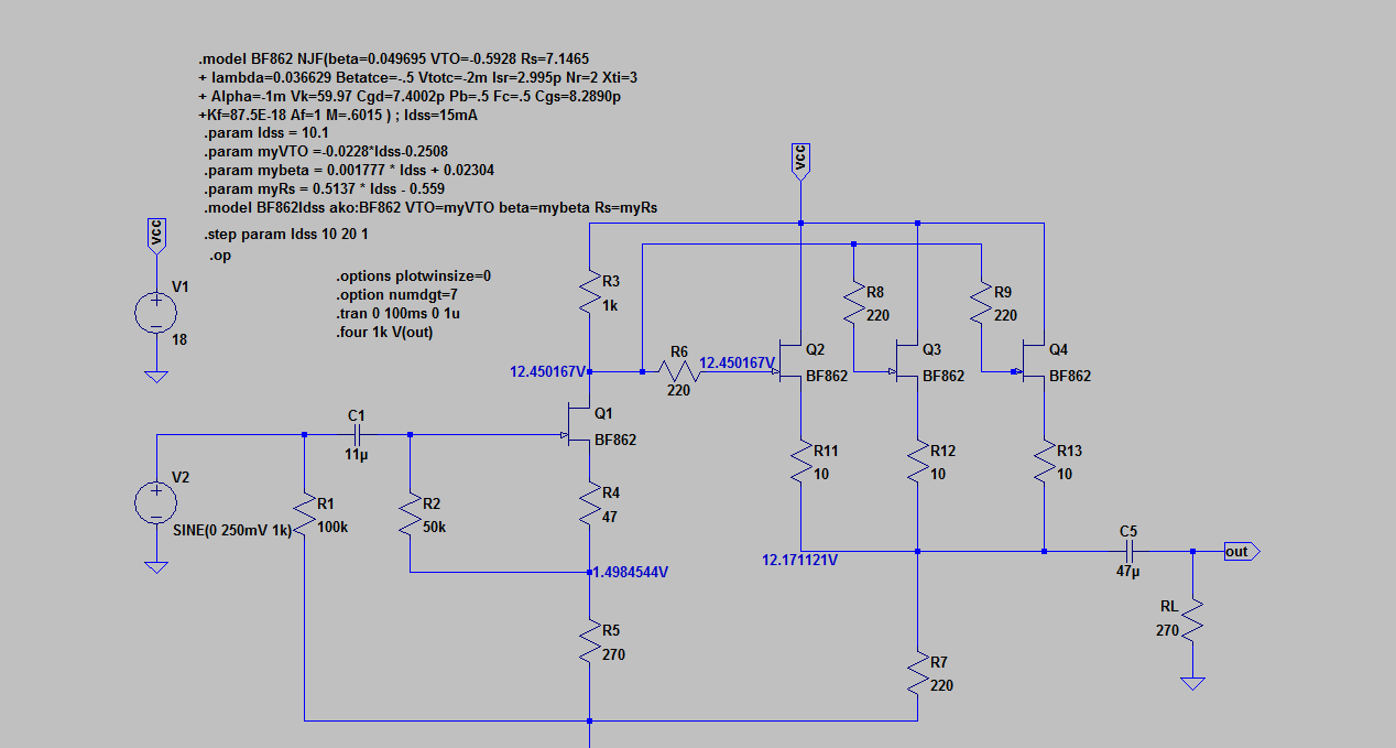

I am trying to simulate the variable Idss over in this thread - but not sure if doing it right.

ran your numbers, if I'm not mistaken.
With R7 = 220 Ohm your parallel JFETs run in forward bias.
This will get you more distortion and lower Zout.
R7 = 330 Ohm would lower the thd by a third and increase Zout by ca 1 Ohm.

There is a GB for the very nice 10 JFET amp (thanks to Mlackey for nice layout) over in this thread:
http://www.diyaudio.com/forums/head...class-headamp-without-heat-8.html#post4942760
Stereo board with mostly through hole except JFETs:
