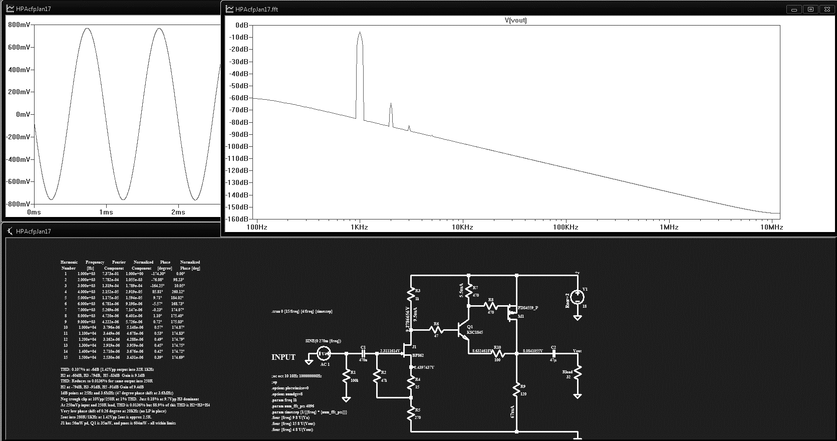

I have worked on a three transistor amp to use a bipolar driving a pmos to replace the LU1014D which appears to be future unobtainium.
Results are good, with very strong Zout of 2R and very good results into low impedance. See the LTSpice analysis.

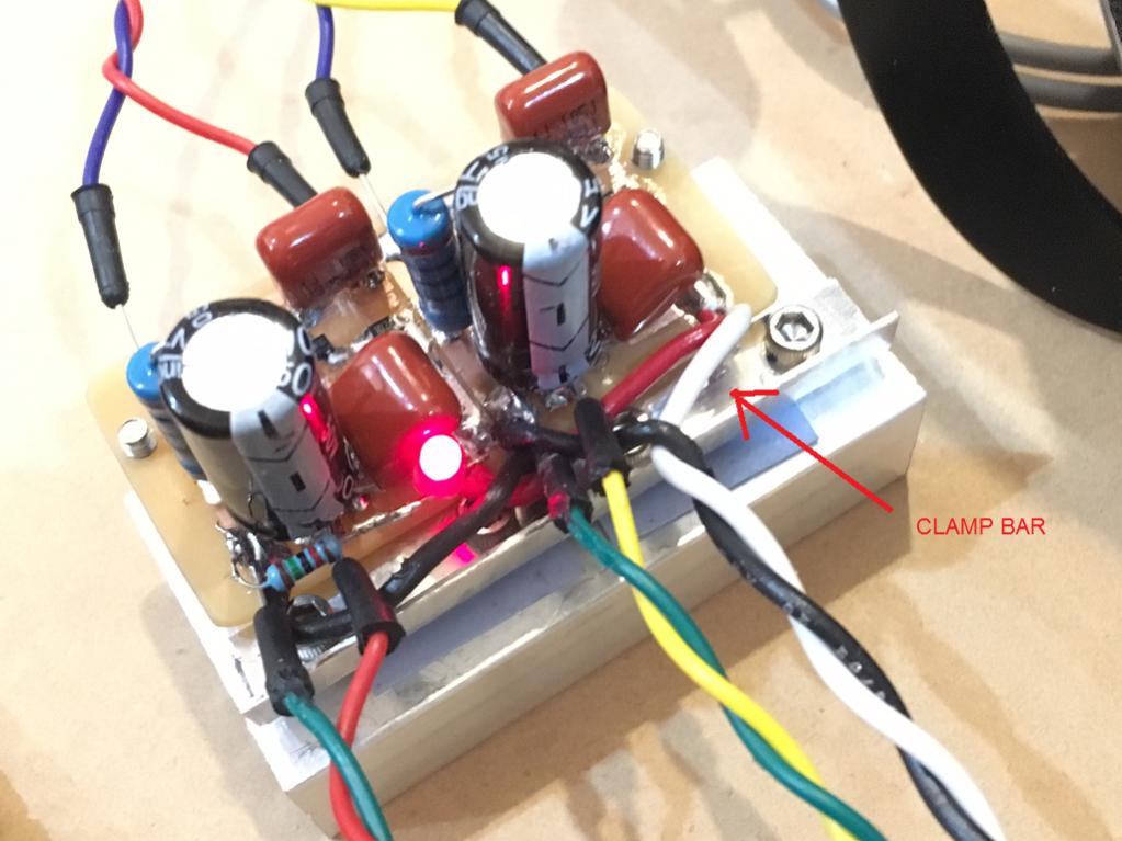

For those waning to build this amp, here is a detail of the L bracket clamp bar used to press the LU104D securely to the heatsink.
![589013d1483295191-pictures-genuine-lovoltech-lu1014d-wanted-lu1014d-clamp.jpg](https://www.diyaudio.com/forums/attachments/pass-labs/589013d1483295191-pictures-genuine-lovoltech-lu1014d-wanted-lu1014d-clamp.jpg)
Be sure to use silicone insulator pads for best heat transfer.

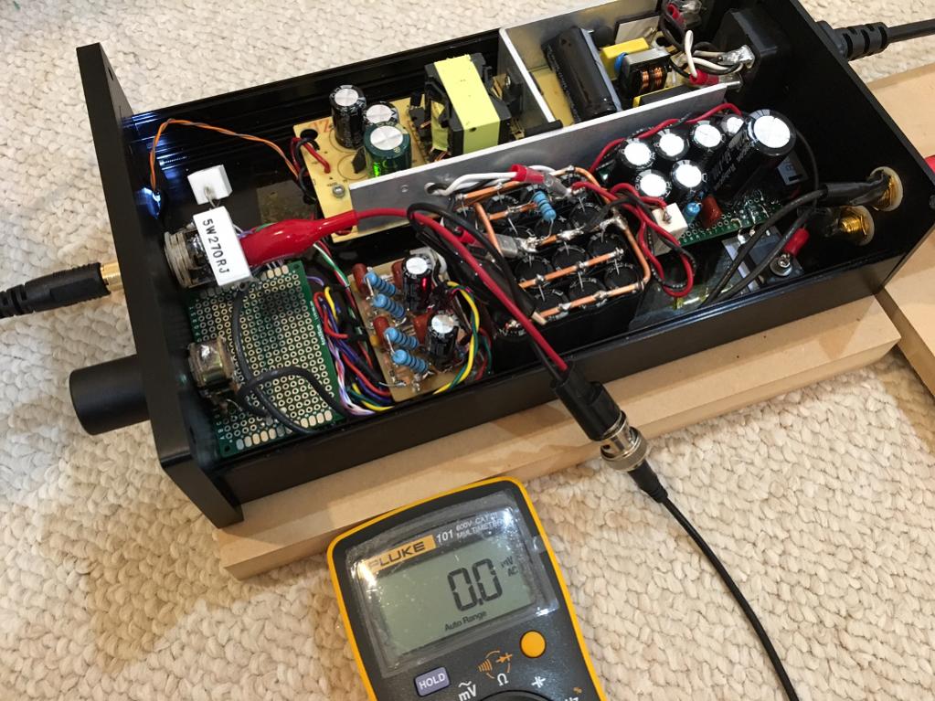

I put this 2 JFET amp in a case quickly so that I can take it with me out of the lab to enjoy music outside the lab. I am using a 24v 5amp SMPS, a Juma cap multiplier, and qnty 16 x 2200uF 25v cap bank for 35mF, that cap bank is connected via 0.33R to 5 x 2200uF cap bank 11mF after the 4700uF cap connected to the Mx. The 16 cap bank has 3.1mOhm ESR - this is good because it about matches the Rdson of the LU1014D for unmitigated bass authority.
The 50k volume pot is mounted on a bare veroboard for addition of future cross-feed filter.
The output at headphones measures 0.0mV noise with the source (DAC) off:

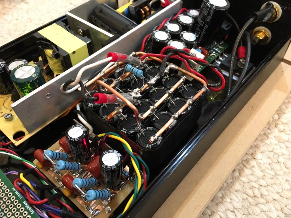

Here is closeup of cap bank and power amp:

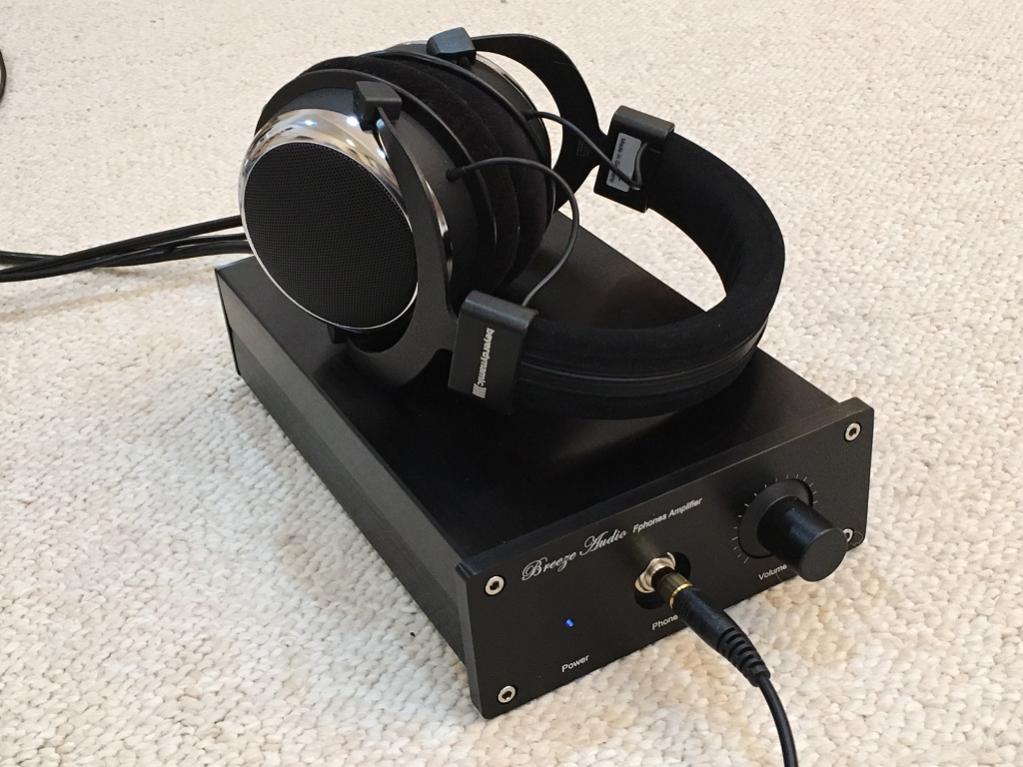

Covered up and completed, ready for enjoyment outside of the lab:
It sounds fantastic, very clear, superb transparency, super duper bass authority. Great sounding amp. Thanks to Hugh for help and inspiration.![cheers :cheers: :cheers:](https://files.diyaudio.com/forums/images/smilies/cheers.gif)

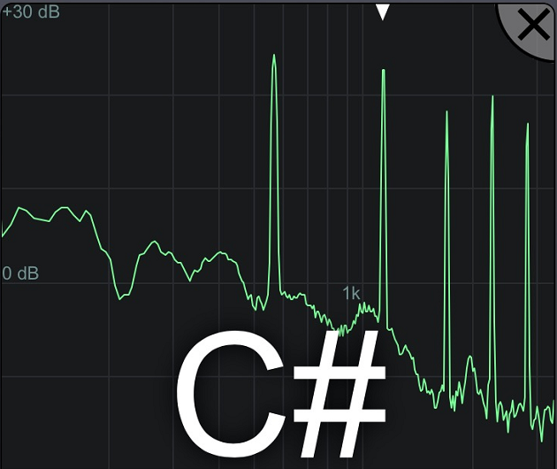

Strange tone upon plugin of headphones
I have been listening to this headamp for a day now and am very happy with the sound quality. Very natural sound, very clear, non-fatiguing and can listen all day, bass if present in source, and is accurately and readily reproduced with authority. Operationally, the amp barely feels warm - cooler than using a trafo and linear regulators as no heat (hardly any) is burned off to get 24v regulated supply at 5 amps. The cap multiplier drops that down to 22.7v at 220mA so hardly any heat there too. Main power stage is about 4w total dissipation which is easily disspitated by the large U-channel 1-piece aluminum base/sidewalls. This cases is very well made and fits together perfecty - nice quality. Only issue are the lettering on the front panel saying it is Breezeadudio and "Fphones Amplifier"
The volume knob is connected to a basic 50k linear pot and is buttery smooth with no scratch or hiss/clicks when changing volume. Thanks to DC blocking input cap and high impedance of input JFET, there is no DC flowing through pot to generate noise. The volume knob works so well, I wonder why anyone would bother to use complicated volume control schemes.
Anyhow, there is one thing that is bugging me and that is when I plug in the headphone jack, there is a momentary buzz sound. This happens when the tip of the jack touches the ring contact on its way to contact the tip contact. Perhaps there is a momentary contact made where tip and ring touch each other? Anyhow there is a tone generated - an oscillation perhaps? But it goes away once the TRS jck is fully seated. I captured the spectrum of the generated tone with my phone and apparently it is rich in harmonic content and has a C# fundamental circa 564Hz. Has anyone had this happen on their amp? In thinking about it, it cannot be caused by the left headphone driver alone contacting the ring as it would mean that right channel (ring) would buzz when fully seated. The fact it is momentary upon insertion has to be a momentary inadvertant circuit is created.
Anyhow, if anyone has debugging suggestions, please advise.

This was raised as a potential issue in a Thread just a week or two ago.................................
A TRS usually shorts across the poles and return as it's being inserted, or removed.
Many amplifier will not tolerate a short and could blow up.
If you are quick then a very short period of oscillation due to the shorting may not cause damage in the long term.
You need a better method for connecting/disconnecting the headphones.
Either one NEVER "hot-plugs" or the designer includes sufficient loading to prevent damage during the shorting.
Thanks. I know this amp can drive an 8R speaker no issues (I use a Faital Pro 3FE22 8 ohm speaker to test the amps to make sure my headphones won't get damaged when building up) - so maybe add a 5R or so resistor in series to minimize impact of having a series resistor but prevent absolute short? So the tip is actually causing a short, in which case why is there sound at all?
If your headphone amp is designed to drive 8ohms speakers then a 2r resistor may be sufficient to prevent damge due to shorting the output.
This 2r resistor will affect the performance of an 8ohms headphone.
Whereas a 10r resistor will have virtually no effect on a 300ohms headphone.
It was really designed for 250R to 125R headphones, lower impedance 8R heaphones will require a new source resistor and perhaps some other adjustments. The 8ohm speaker test is ajust like 5 seconds to confirm music comes out before plugging headphones.
Like you say, a 10R resistor would be insignificant with 250 ohm headphones. I will give that a try and see if it helps. A 2w metal thin film 10R or 4.7R should do the trick I think.
