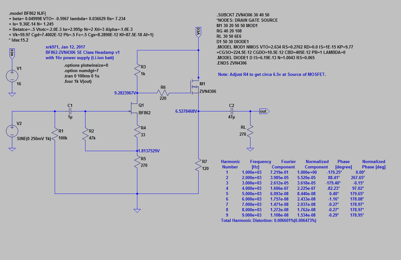

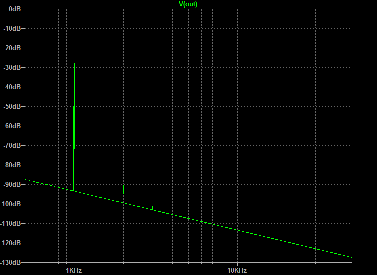

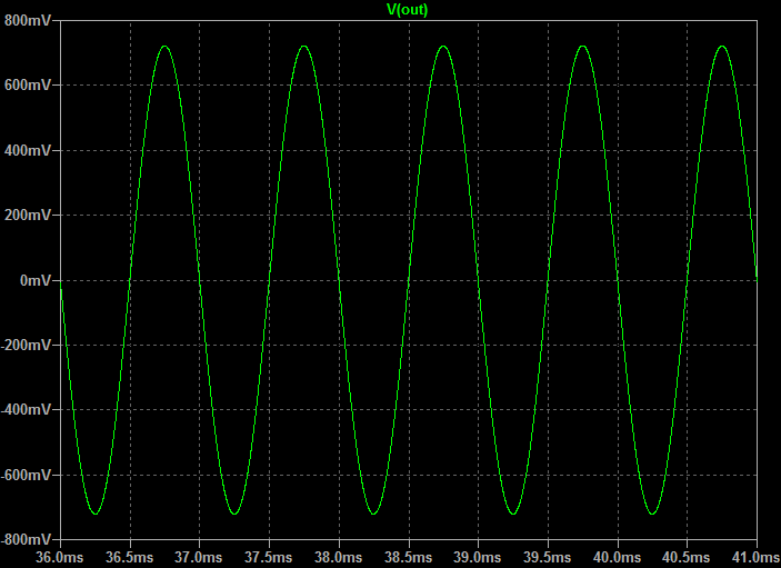

As built circuit with 47uF output cap, 1uF input cap, assumed 16v rail for 9vx2 Li-ion batteries. THD is now predicted to be 0.0065% at full output of 1.4 v p-p.
http://www.diyaudio.com/forums/head...lass-headamp-without-heat-16.html#post4949133
Oh, and before someone flames me for "this is predicated on a possibly bad model of the actives..." the model is from the manufacturer and has been revised once (2007) - so may be better than just a first guess from the company. Also, I have ordered a decent sound card and will measure the performance into a 270R resistive load and we will see how close we get.

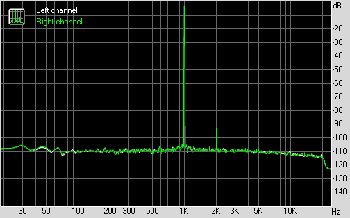

I tried using RMAA software with my cheap Behringer UCA202 and here is the loopback self HD FFT - not too bad with -110dB noise floor and a couple of peaks at H2 and H3 with 15dB height. These 15dB peak values will have to be subtracted from an amp measurement:

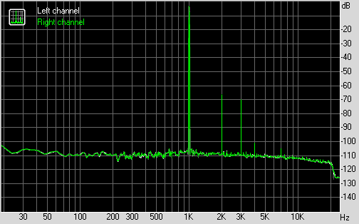

Here is the Pocket Class A BF862/ZVN4306 amp as measured using the UCA202 as the interface - with 270R load equivalent to headphonesc (amp is pretty quiet and if you subtract 15dB from H2 and H3 peaks, you get something a bit higher than the theoretically predicted FFT - but profile looks similar):

This is my first measurement with the Rightmark software - pretty easy to use but I may be missing a setting or not doing something right. It requires you to set the ampitude at a pretty high level - so that may drive distortion up higher than what one would actually listen to at. I will repeat with the Focusrite 2i2 gen2 interface when that comes in - it should b cleaner.
... and if you subtract 15dB from H2 and H3 peaks, you get something a bit higher than the theoretically predicted FFT - but profile looks similar):
You can't subtract like that. You need to do a root mean square subtraction of the figures instead.
Your soundcard has loopback of -95dB H3 =10^(-95/20)=1.78e-5
Your amp measures -70dB H3 =3.16e-4
Your amp's H3 = 20*log(sqrt(3.16e-4^2-1.78e-5^2)) = -70.01dB -> the H3 contribution of your soundcard is negligible in this case, as your amp has an H3 that is 25dB (18 times) higher than the soundcard.

Ok thanks for that reminder. So amp's H3 is higher than predicted. There is an interesting knob to dial here with putting a pot for R4 and dialing in the relative H3/H2 contributions.

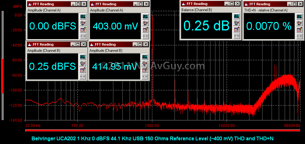

Help me, the UCA202 is a 16-bit device, right?
Also it is specced at 89dB SNR for D/A. How do you get 110dB?
Here is a screenshot of NWAVGuy test showing -120dB noisefloor of headphone out (which is what I was using).
