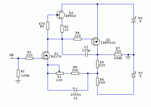

Eric, Bangla,
it's actually very easy to adopt well known CFP gain block to dual rail PSU with no coupling capacitors.
In schematic shown below, Q3/R3/R9 make an active load for Q1 - you can use just a 330-390R resistor instead of it - the distortion will be higher but maybe you'll like it.
P1/R8/C1 build the DC-shifter sub-circuit that sets output to 0V DC. (P1 should be multiturn pot.)

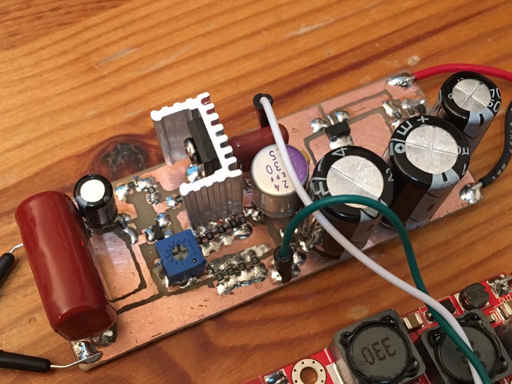

Ok, I had some time and thought I would whip this up on a solderless breadboard first as the last time I did it on P2P veroboard it did not work. Well it works well and gets quite loud too so I obviously had something wrong the last time I did it. I am using 2SK170BL and all through hole components this time. I put a 100R trim pot in series with a 47R resistor to get a baseline 100R +/-50R adjustment range for the niceness knob. The solderless breadboard is kind of flakey - noisy with occasional crackles due to poor connections. So I will have to wait for a more permanent amp before measuring FFT and adjusting "niceness" knob. I know it works now so may just go ahead and hand-etch via Sharpie a small PCB for through hole/SMT as the SMT resistors are way easier to solder and require no drilling. I will probably make this as a "tea box" sized amp - a bit bigger than mint tin just because.
592603d1484603003-mosfet-source-follower-headamp-aksa-jfet-bjt-headamp-solderless-bb.jpg

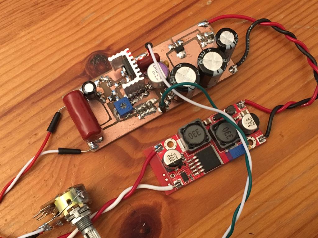

Implementation on PCB with Cap Mx:
I etched a little PCB using a Sharpie marker to hand draw the layout. This one has a Juma cap multiplier using a ZXMN6A11 SMT MOSFET and a couple of 2200uF caps and a 470uF cap. I even have a niceness knob (100R pot) to dial in the harmonic distortion profile when viewing the output through an RTA.
Using a BF862 and BD140 with 2.2uF input coupling cap, and 330uF 25v OSCON output coupling cap with 0.56uF bypass cap.
Just one channel but sounds very nice. Cap multiplier is used to filter the output of a DC-DC converted needed to provide a 20v supply from 5v to 24v input. I am currently running 12v but foresee using 5v USB jack to power this amp. The cap Mx uses the PCB copper as the heatsink. BD140 has local heatsink, SMT resistor banks help spread heat over larger area. Currently running 50 mA bias current.
System with cap Mx and DC-DC converter:
Closeup of main amp board:

It came up low on bias current (the 4.14v was good) but depending on the Idss (13.3mA on this particular one) of BF862 - I was getting only 40mA through R5. Adjusting the niceness knob changes bias by 2 of 3mA. But I increased supply voltage with D.C. To D.C. Converter and at 20v supply out of cap Mx, bias is 50mA. I will take careful measurement of operating points tomorrow.

I managed to sneak in the lab before departing this morning and got the DC measurements. I readjusted the supply to 18.00v exactly (input of cap Mx is 19.90v so this particular MOSFET on cap Mx has nice low Vgs).
I get values quite close to the simulation (with fluke 101):
4.454v at voltage divider and 4.449v at gate of JFET
17.330v upstream of base stopper of BD140
13.800v at collector of BD140
4.559v at junction of niceness pot (R6) and two power resistors R8 & R9 (200R and 90R actual values). So about 45mAbias current through BD140 and 51.8mA total current through system for 6.8mA bias through the BF862. This is only about 50% Idss so looks like I may need to readadjust 3.3k/10k ratio tongetncloser to 75% Idss for better performance?
Although for my power resistors I am using qnty 5 x 1k for 200R (although I noticed the exact value did not change current through it) and using qnty 4 x 360R for 90R equivalent.
I forgot to measure exact value of niceness pot value but probably 70R is what I think I have it set at.

I think we cross-posted. Current through BF862 was about 6.8mA. I forgot to add a resistor in series my 100R pot - so 100R is the entire range of niceness adjustment at present. It was late and with one test track I could not easily detect an audible difference with one ear and a dance track from Daft Punk playing :) i was afraid I would fry something if source seven went to zero ohms?
Subjectively so far, it sounds very nice and close to MOSFET version - which is to say, exceedingly nice. I think the gain feels a tad lower as it is not quite as loud. That must be a function of BD140 Hfe? Perhaps cherry pick one with higher Hfe for more gain?
It is very quiet even when running with DC-DC converter and cap Mx. Bass extension is excellent and highs and mids are clear and transparent. No harshness or sibillance detected (I listened to 5 tracks - jazz trio, fenale vocals (2), hip hop dance, rock). Very nice amp from what I know of headamps!
