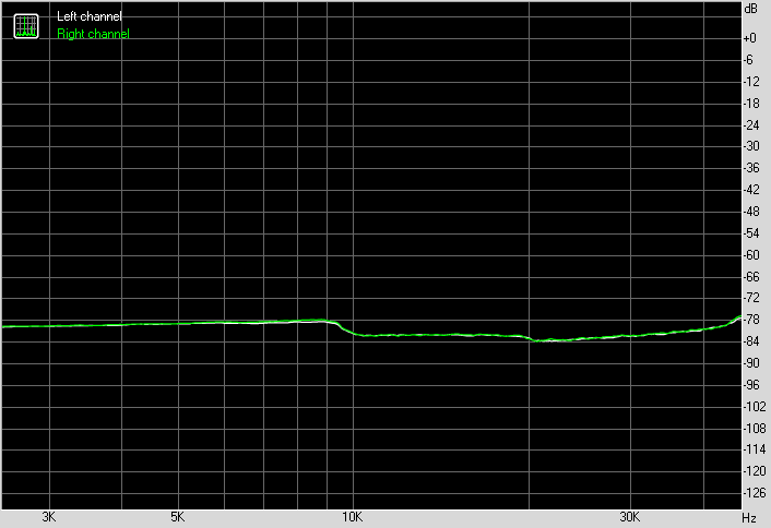

Adjust R6 Knob for Balanced HD

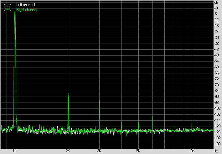

Using a real-time FFT, I adjusted the R6 pot to get the same exact HD components, and adjusted for the H2 to be about 10dB higher than H3. The overall THD increased a bit to 0.0072%, but I think that this gives the best balance for musicality. The overall levels are still quite low with H2 at -86dB and H3 at -96dB and all else at -114dB. The stereo cross-talk is -88.5dB, the IMD is also very good. The dynamic range is 93.5dB, and intermodulation distortion is 0.0032%.
Here is measured FFT with 1kHz and 700mV into 270ohm load (note exact match of harmonic profile of left and right channels - R6 pot is maybe ~30% difference (visually):
Here is measured IMD:
Here is measured Frequency Response and THD vs frequency:

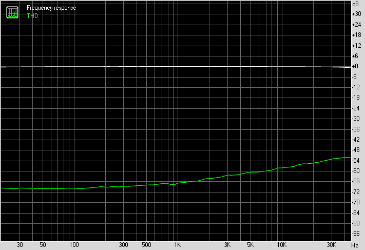

![596758d1486177751-mosfet-source-follower-headamp-bf862-2sa1837-headamp-balanced-fr-thd.png](https://www.diyaudio.com/forums/attachments/solid-state/596758d1486177751-mosfet-source-follower-headamp-bf862-2sa1837-headamp-balanced-fr-thd.png)
I have been listening for several hours now with this new balanced niceness setting (-86dB H2 and 96dB H3) and it sounds superb. I am using the Focusrite Scarlett Solo 2G as the DAC and it works wonderfully as such - able to get super high speed bit rates, low noise, built in volume control knob, it also has quite a high level output that can drive this amp to very loud sound levels (pain threshold but still clean sounding).

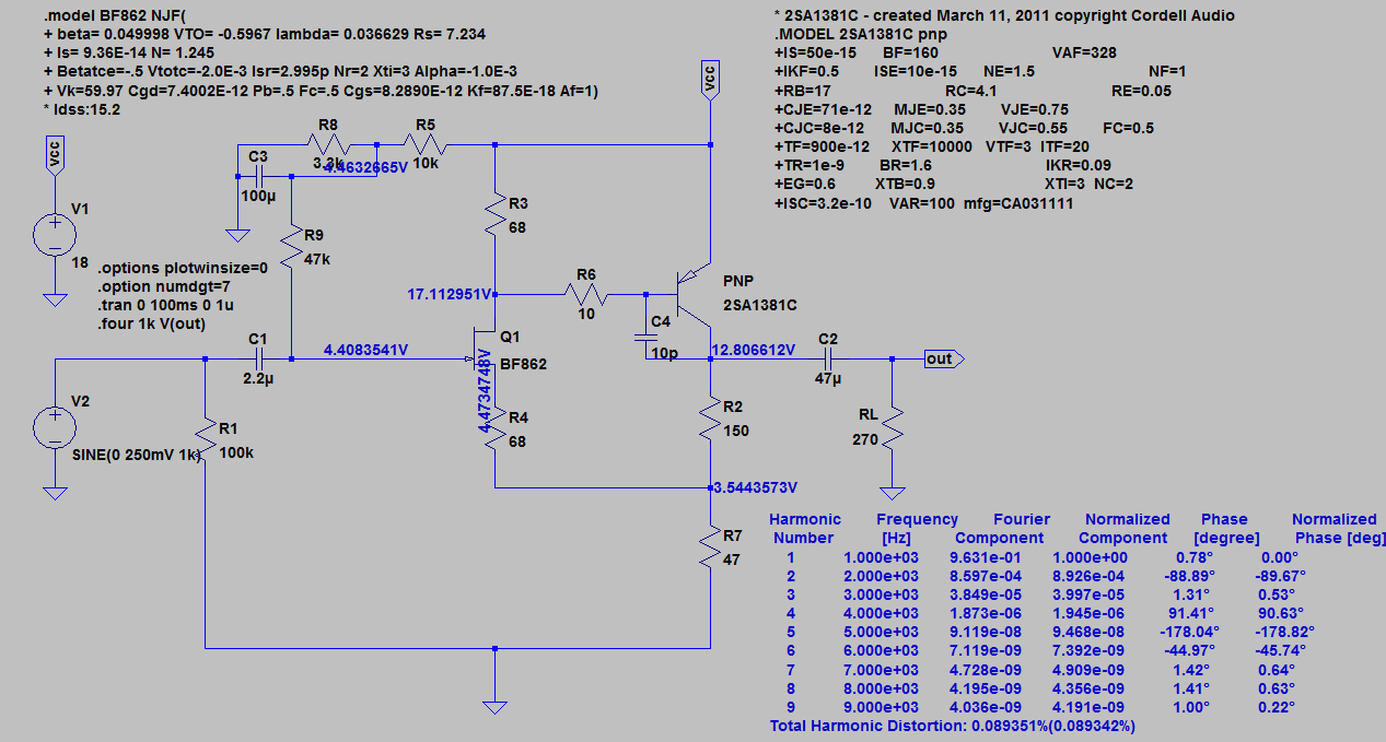

First cut at 2SA1381 portable version

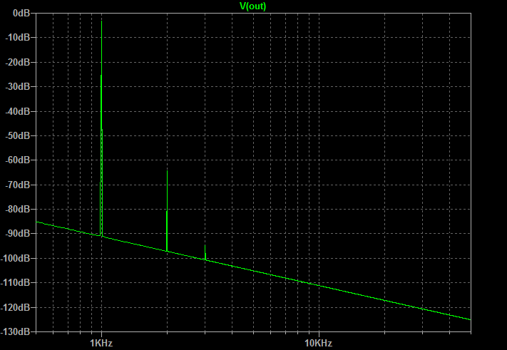

Here is what I am getting so far for the bias settings with the KSA1381/2SA1381. I am having a hard time getting THD less than 1% though. This is with about 50mA bias current. Although HD profile looks really nice...
![596806d1486217771-mosfet-source-follower-headamp-bf862-2sa1381-headamp-sch-v4.png](https://www.diyaudio.com/forums/attachments/solid-state/596806d1486217771-mosfet-source-follower-headamp-bf862-2sa1381-headamp-sch-v4.png)
![596807d1486217771-mosfet-source-follower-headamp-bf862-2sa1381-headamp-hd-v4.png](https://www.diyaudio.com/forums/attachments/solid-state/596807d1486217771-mosfet-source-follower-headamp-bf862-2sa1381-headamp-hd-v4.png)
Hi XRK,
You asked about how to set up the DC points.
1. Aim for 12V at the collector of the slave, using Vcc of 18V. This will maximise the output voltage range; the point at which the waveform clips.
2. Chose current through the jfet (master, 10mA) and the pnp (slave, 50mA).
3. Add the device currents through the master and then select the slave resistor, let's select 68R. This will mean (60mA x 68R = 4080mV, ie 4V08 wrt ground.
4. Knowing you will have a gain of 3, select the collector resistor on the slave as (Av - 1)x68. This is 136R, so nearest preferred value would be 150R. The gain will now be (150+68)/68, which is 3.2, around 12dB a good figure for a HPA.
5. Now select the master source resistor. Running 10mA, I would shoot for 68R to your feedback low to profile the harmonics. With the 10mA Id current through this device, it will drop 68Rx10mA = 680mV.
6. The operating voltage reference at the gate of the master will be the 4.08V at the midpoint of the collector string plus the 0.68V dropped across the slave degen resistor minus the Vgs on the jfet, around 150mV, not more. This would then deliver around 4.51V at the gate. This will be very close to the voltage reference on the offside of the gate 47K resistor; since the current into the jfet is very small (3000 times less than a small bipolar running around 10mA Ic). You choose the 10k/3k divider off the supply to create this reference voltage.
7. In practice, your npv of the collector resistor, 150R, is different to the 136R calculated. So you could expect and additional (14R x 50mA = 700mV) on top of the collector voltage; you will have 50mA across this new 150R, which is 7.5V. Add this to your 4.08V and you have 11.75V at the collector of the pnp, bang on!
8. I have chosen 68R at the lower collector string; you chose 47R. Your selection would give you a gain of (150+47)/47 = 4.19. I think this is a bit too high; better would be 150R and 68R.
9. You can adjust the correct voltage, around 12V +/-0.5 at the slave collector by setting a different reference voltage at the jfet gate. This is affected by changing the 3k3 R8 on your LTSpice up or down; a small 5k pot here would be good to set it initially, then fix the resistor when you are happy with it.
A CFP with gain has very low distortion and very easy operating points, quite amenable to simple math. As the gain rises, the local fb drops, and with this the THD rises. The 2SA1381 is a high voltage, low gain, low collector current device and the distortion might be limitations operating it higher than it's designed; the gain bandwidth peaks at about 30mA and the hfe drops at 50mA. This compares to the 2SA1837 which has GB peak at 200mA and hfe starts to drop at 300mA; a more robust animal. In any event, XRK, the THD of 0.0893% is well under 0.1% and 99.9% of this thd is SOLELY H2. I would say this is a warm result, and it should sound very engaging!

Hi Hugh,
Thank you so much for the detailed explanation on how to calculate the set points. I got close by trial and error and now much better to know the steps. I will have to re-read and do a few examples for this to sink in fully. This post is definitely another one of your many gems! It seems that there is not much to be gained by going with 2SA1831 but loss of current headroom and larger size. If I can still get the 1837, perhaps best to stick with it then for best sound, even at 50mA bias.
Thanks again.

XRK,
I goofed a few times! Here's a retake:
1. Aim for 2/3 Vcc at the collector of the slave. For Vcc of 18V. This will maximise the output voltage range with 12V at C of slave; this sets the highest waveform clip.
2. Choose a suitable current through the jfet (master, 10mA) and the pnp (slave, 50mA). The jfet current should be 2/3 of the Idss, while the pnp current is determined by the lowest impedance load you wish to drive. 16R cans need around 150mA.
3. Add the save current to the master current (10+50) and then select the slave resistor, let's select 68R. This will drop (60mA x 68R) = 4080mV, ie 4V08 wrt ground.
4. Knowing you will have a gain (Av) of 3, select the collector resistor on the slave as (Av - 1)x68. This is 136R, so nearest preferred value would be 150R. The gain will now be (150+68)/68, which is 3.2, around 10dB a good figure for a HPA.
5. Now select the source degeneration resistor. Running 10mA, I would shoot for 68R to your feedback low to profile the harmonics. With the 10mA Id current through this device, it will drop 68Rx10mA = 680mV, making the source (0.68+4.08) = 4.76V wrt ground.
6. The operating voltage reference at the gate of the master will be the 4.08V at the midpoint of the collector string plus the 0.68V dropped across the slave degen resistor minus the Vgs on the jfet, around 150mV, not more. This would then deliver around 4.51V at the gate. This will be very close to the voltage reference on the offside of the gate 47K resistor; since the current into the jfet is very small (3000 times less than a small bipolar running around 10mA Ic). You choose the 10k/3k3 divider off the supply to create this reference voltage as a start; trim it empirically after you have it running.
