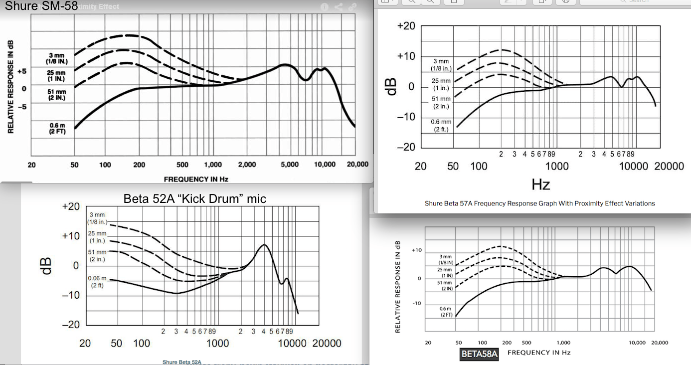

The primary difference between an SM57 and the SM58 is the windscreen, the 58 having more "pop" and wind noise immunity. The SM57 cartridge is slightly closer to the screen than the SM58, so the proximity effect and output level is slightly greater when "kissing" the source.One funny thing in the beginning of the video, he says it's a SM58, and it looks like it, but later he refers to it as SM57 (that looks different than the 58), maybe I'm missing something..
The proximity response of a mic of this type would make distortion levels of another source difficult to determine, as the fundamental tone may raised +15 dB (or more) compared to the harmonics, depending on distance, around a 20% distortion difference.
Condenser and back electret mics generally have a hard SPL limit where the output actually clips, distortion may go from a fraction of a percent to over 100% in a just a few dB.
Dynamic mics generally won't reach a hard limit, but their transformer saturation and diaphragm asymmetry does progressively add harmonic distortion at higher SPL levels, all a part of the "sound character" that still makes them a staple for recording.
As far as the signal to noise ratio between mics, if the distortion components of the driver under test are so low as to be masked by the noise of a omni condenser mic with a decent S/N, they probably won't be noticed in a listening test.

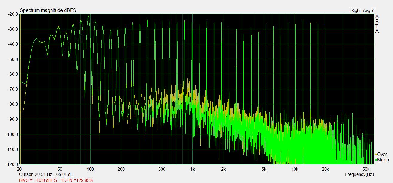

I have a feeling that the mic distortion and background noise are the main limiting factors here, looking at the measurements I posted. Looking at JC's video posted here on the previous page where he compares with the Shure mic, is a clear indication of mic distortion being a problem. Even the B&K I'm using is probably masking with it's own distortion if the driver is performing well. This is a learning experiment for me, and I have already learned that driver distortion is lower than I thought, or should I say I was led to believe by many of the measurements I have seen. One example would be Troels distortion measurements, since I measure significantly lower distortion than he did on the same driver, even if I'm using multitone, so IMD is added to the mix.

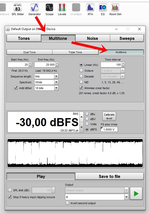

REW is also good with signals, including multitones!

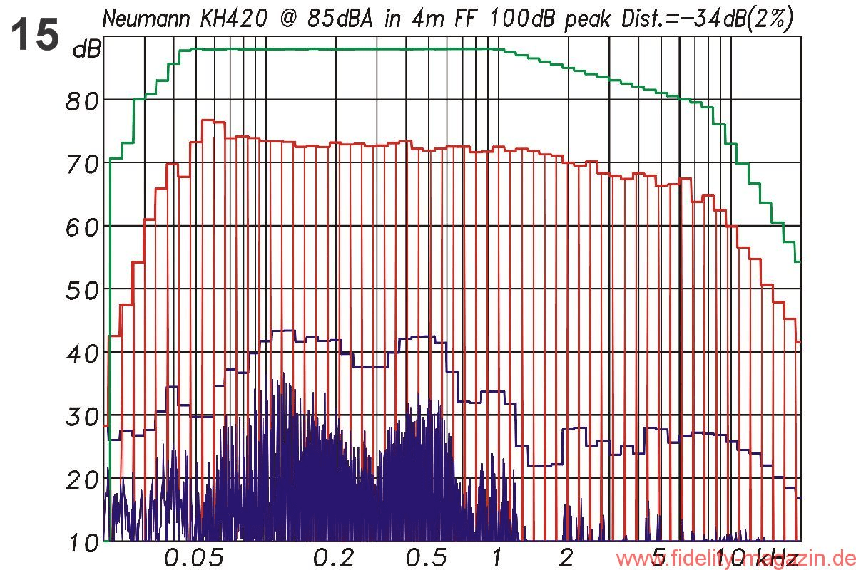

German reviewers use often Klippel systems, and often show multitone measurements too. But I can't get a grip of those, various levels...
https://www.fidelity-online.de/test/lautsprecher/lautsprecher-messungen/
https://www.soundandrecording.de/thema/studiomonitore/
Ebenso erwähnenswert wie die Maximalwerte ist der gleichmäßige Kurvenverlauf. Schwachstellen, wo die Kurve einbricht, gibt es beim KH 420 nicht. Die zweite Messreihe wurde zum Thema Intermodulationsverzerrungen mit einem Mittlungspegel von 85 dBA in einer typischen Hörentfernung von 4 m unter Freifeldbedingungen durchgeführt. Der Spitzenpegel bei dieser Messung, ebenfalls in 4 m Entfernung, betrug 100 dB, entsprechend 112 dB in 1 m Entfernung. Als Testsignal wurde ein Multisinus mit 60 Anregungsfrequenzen und einer Gewichtung nach EIA-426B für ein mittleres Musiksignal genutzt. Das Signal hat einen Crestfaktor von 12 dB. Die Grafik aus Abbildung 15 zeigt dazu das Spektrum des Anregungssignals (grüne Kurve), das gemessene Spektrum des vom Lautsprecher abgestrahlten Signals (rot) und die daraus extrahierten Verzerrungsanteile (blau). Beides wird sowohl mit einzelnen Spektrallinien wie auch in 1/6-Oktavbandbreite aufsummiert dargestellt. Der Gesamtverzerrungsanteil (Harmonische und Intermodulationen THD + IMD) liegt A-bewertet für den Abhörpegel von 85 dBA Leq in 4 m Entfernung bei sehr schön niedrigen -34 dB, entsprechend 2%. Auch hier ist wieder gut zu erkennen, wie die ohnehin schon geringen Verzerrungen oberhalb von 500 Hz noch mal deutlich geringer werden. Ein Dreiwege-System kann hier seine grundsätzlichen Vorzüge ausspielen, wo die Mitten nicht mehr durch die großen Auslenkungen im Bass beeinträchtigt werden. Hinzu kommen die Verzerrungsarmut und die hohe Sensitivity der beiden Kalotten.
![REW generator multitone.jpg REW generator multitone.jpg](https://www.diyaudio.com/community/data/attachments/1013/1013939-edb0c6783c54715497c448b34e30679a.jpg)

@Juhanzi As i understand it from the text, green is the FR of the signal, red is the FR output of the speaker, and blue is distortion. But I don't really see corresponding SPL in the graph as they mention in the text. I also don't understand that there are blue bars and blue 'grass' for distortion..
OK, now I see distortions. Another problme is why they use so different spl levels... Is it to set max. distortion to 2%, then to see the "clean" output capacity (in spl)? As benefit of this 3-way speaker they mention the low midrange IMD.
