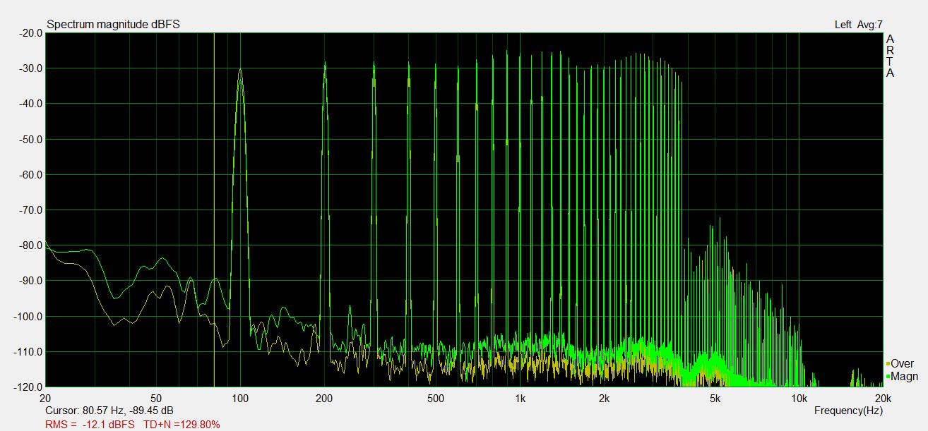

I have to check the mic model later, but don't look at that graph for distortion. That's the ITU... multitone we discussed just before you joined (on the previous page) where all the harmonics are hidden by the test tone itself, starts at 100Hz, and tones are with 100Hz intervals so all harmonics are hidden.
The only visible distortion components are from 4k and up where there is no input signal. I'm thinking this could be used to reveal the actual noise floor of a running measurement (reflections with altered frequency that you mentioned in your video, background noise, noise from measurement gear etc)
The best actual measurement has been around -60dB distortion on tweeters so far, and I don't know if its the mic or the drivers limit. I'm also not sure if the mic distortion rises when frequency goes down, and that could be a reason mids show significantly higher distortion. but, again, I don't have any 'low distortion' drivers to test. This is why I'm curious about the SM mic, since you got around -80dB with that if I remember correctly? Easiest would be if I could just borrow a SM58 from a friend and compare, saves me buying one.

He is measureing the noise of the microphone. ALWAYS start with a proper noise floor measurement - unplug your speaker, make a measurement, replug and have a look. Then you know if it's a signal from the speaker or from your mic/environment/preamp/....
Dayton USB mic is one of the worst microphones when you need low noise. But there is a reason why NO CARDIOD microphones are used for measurements, ESPECIALLY in close distance! They change their frequency response A LOT in the nearfield cause they record sound particle velocity and not sound pressure.
Not the IMD performance of an SM57 is better - it has less noise. That's a completely different thing.
If you wand to measure distortion without noise - use the right measurement method. You CAN measure THD (summ of overtones) instead of THD+N (sum of everything minus the stimulus).
There actually ARE omni dynamic microphones (MD42, M58, EV 635A...) and even when their linearity doesn't qualify them as measurement mics (but all these cheap USB mics or Behringer mics arn't good enough either without calibration) at least they have a stable behaviour. Use these if you have to.
In these posts so often noise is mistaken with actual IMD or overtones ... be SURE what you measure and when it's not working use a different methode.
