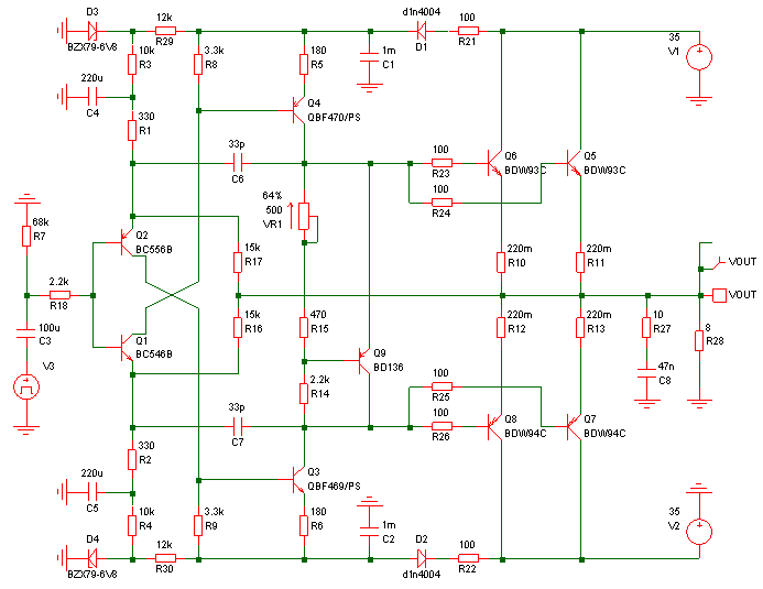

It has thermal problem specially if I set up the bias 200-300mA.
The warmer the amp get the higher the bias goes and so on until self destruction.
Until now I compensated with over sized heatsink.
I assume that the BD136 is mounted on the heatsink, if not the case
what happens is logical.
The nominal 200mA bias is to be set only when the amp has warmed ,
so let the amp getting hot and set the bias.
Try this way , if it keeps going in thermal runaway then something
else is fishy , perhaps it oscillate .
If oscillations occur connect 100 to 220pF caps from base to collector
of the darlingtons.
The TIP darlingtons are not good performing devices , we can
summarize them as being some kind of TIP29/33 and TIP30/33
arranged as darlingtons , and overall they can be prone to
oscillations.
The BDW83/84 are the same devices but with european

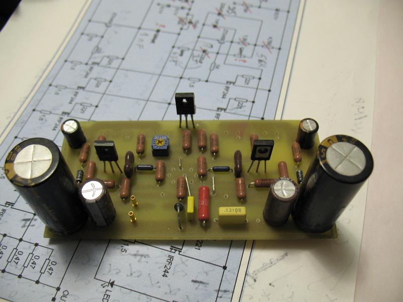

I used to set up the bias when the amp cold and keep check it until it warm up.
To be honest the amp was designed to run it about 30mA/ channel.
But it sound better if I increase the bias.
I don't know if is oscillate, to check that I would need scope.
I can't hear any strange sound...I know that not a proof the amp is not oscillate.
Yes BD136 is mounted on the same heatsink where the power transistors.
BC414C/416C input, BF469/470 driver, and BDW83C/84C
Also I will try ON semi MJ11015/16 darlington it has more power more rugged.

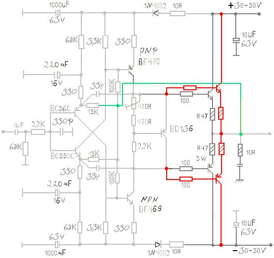

If you intend to rebuild this amp use 0.47R resistors as in your
schematic , it will help prevent thermal runaway if it s DC conditions
related.
That said , TIPs are not the best devices for amps along with the BDV64/65 ,
both rugged but notoriously slow , the BDW83/84 being of the same vein.
BDW93/94C are somewhat a little better but they are only 80W or so with
a TO220 case that do not allow for high power over long periods.
The MJ11015/16 should be better candidates if you already have a few.
What appear in simulations is that this amp is sensitive to the output devices
speed , the slower the output devices the less stable , the other transistors
having far less influence.
Unfortunately there are not cheap good quality power darlingtons ,
at least not known of me.
Old types include the MJ11015/16 , MJ2501/3001 or BDX66/67 , all being
quite average and overhelmingly outmatched by more recent products
notably Sankens.

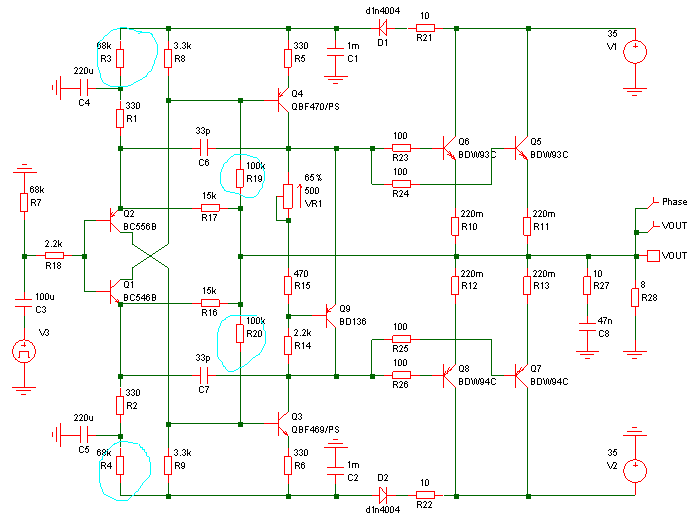

What appear in simulations is that this Darlington amp is sensitive to the output devices

BDW93/94 have higher frequency limit than the BDW83/84
but both pairs can have low and variable gains , hence there will be
some difference even among the same parts.
Another problem the BF VAS transistors only available from India and sound awful. So I picked the MJE243/253 which gave me a lot of improvement to.
Only problem there is huge Hfe difference between the NPN & PNP device.
On the circuit there is no offset adjustment so I have to do that with the input JFet or transistor. I have to select (MATCH) them to get read of the offset.
The 2SA1360/2SC3423 pair used in the mosfet project amp suit
perfecly the task as VAS and are way better than the MJE2XX or
even the BF4XX.
As for iddle current , this amp is sensitive to voltage supply variations
since there is biaising currents that are not regulated.
Particularly , the two 100K and 68K resistors (cercled in blue in the schematic
below ) will see variable currents with varying voltage , hence there will
be both quiescent current variation (the 100K influence mainly)
and output DC offset variation (the 68K mainly);
To adjust the DC output offset just use a resistor parraleled with
only one 68K resistor , the exact one depend of the offset polarity.
Start with a 4.7 meghom resistor and progressively reduce its value
to the next E12 steps , that is 4.3MR , 3.9MR and so on.
Hello wahab
I will replace one of the 68K resistor with a 100K multi turn (20X) trimmer. I'll set up to 68K and from there I can go both way until I get read of the offset. After I measure the trimmer and I replace it with resistor.

Yes and no....
This would work but not until the PS voltage has reached a couple volts
over the zener voltage so this reduce the supply voltage range accordingly.
Anyway ,in simulation Jfets do no better than Bjts , quite the contrary.
The main problem of this amp is in fact the point discussed above ,
that is , supply voltage highly dependent quiescent current.
For technical discussion , i post a variant where the 100K are suppressed
while 68K resistors are replaced by two resistors with a zener in the middle
to keep the emitters current stable.
In simulations , with the PS voltage increased from +-35V to +-40V ,
the original version has iddle current increasing from 124mA/pair to 180mA ,
that is almost 50% higher quiescent current for a meager 14% higher PSV.
In the modded version such a voltage variation yield 5% higher Iq , wich
is one order of magnitude better , while perfs are on par or even better.

Due to the way it was designed there s a chain of dependencies between
the stages , first being the eventual low gain of the darlingtons that could
stress the VAS to the point that it can enter class B mode while
stressing the input stage to supply more current.
The 100K resistors do not only increase drasticaly the Iq sensitivity to supply
voltage variation , they also provide a local NFB loop from power output
to the VAS input , hence reducing global NFB to about 13db even at low
frequencies, wich will result in average damping factor , a behaviour magnified by the power transistors eventualy low gain.
That s a possible explanation to the variations in bass and sound quality you witnessed when swapping active parts.
I was toying with the idea of trying out the circuit with changes in the feedback. Since both the 100K and the 15K provided feedback I figured it would be OK to get rid of one of them. And as Wahab has done the 100K is the one than could go as the 15K determines overall gain.
For all the 'CFB' circuits that we have been seeing here , they are all actually only sensing output voltage and not current and feeding it back to the input device emitter which accepts it as a current. No matter how one looks at it or calls it , it does what one wants it to do !
A JFET at the input would see the feedback differently (?). Would that affect the sound ? Maybe we have to try it to find out.
