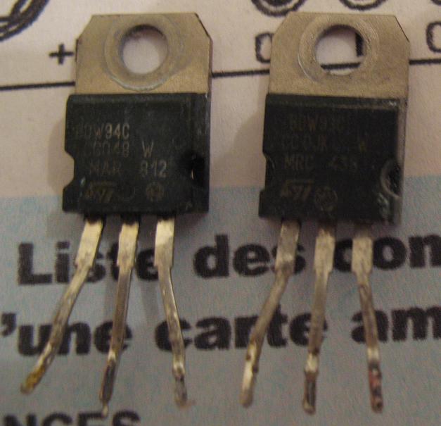

As for the darlingtons , if vintage models are to be used then it makes
no doubt that the BDW93C/94C are the best choice thanks to their 20Mhz Ft.
TIP have only 4Mhz Ft and BDW83/84 are just slightly better or rather
less worse with a FT that is in the 8Mhz range at most and perhaps
only for STMicro parts , informations in datasheets being uncomplete.
Whatever the choice the parts must be close enough VBE wise ,
wich shouldnt be a problem for components originating from the same batch.
Hello wahab
To prove it I did tested the BDW93C/94C I made a picture from the used parts.
Yes there is a minimal difference in the favour of these devices but they are only good max 30V rail voltage and you get about 30W 8Ohms or less.
To be honest someone has to be great ear to hear the difference between the BDW83C/84C and the BDW93C/94C

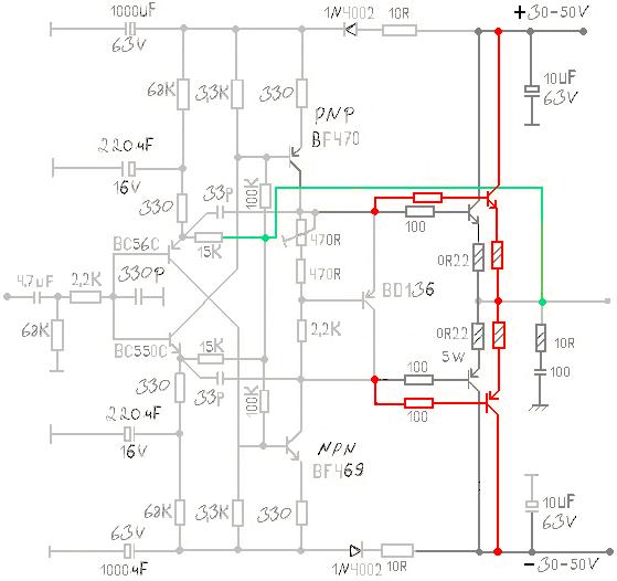

I made some mode in the circuit please let me know what do you think.
I took the feedback to the input only. I increased the input device voltage, they run on very very low voltage!
Probably I supposed to get read of the 100K resisters but I'm not sure.
Unfortunately I'm unable to run any simulation and to build it for a test in real life that would be a never ending something.
Would you be so kind please take a look and let me know your opinion
Thank you very much
Again I do not want to make the amp sound better, with the sound I'm more than satisfied but if I could make it more stable under those extreme circumstances (0R22 emitter resisters, 250mA bias etc) that would be an extra
Greetings Gabor:)

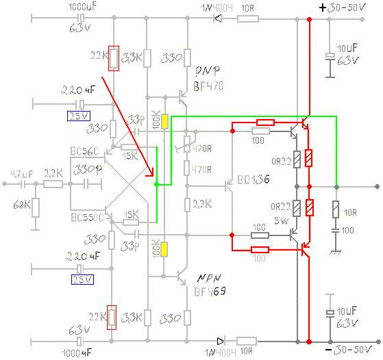

The first circuit the orig!
As connected in your mod the 100K resistors will no more provide
local feedback but they will still conduct a VA dependent current
from a base to the other , hence the iddle current variation
will stay exactly the same.
I think that the original designer didnt fully evaluate the consequences
of implementing such a biaising/local NFB loop using this scheme.
About the 100K feedback resistors, you can remove them if you can get low DC at output. This topology has issue with bias stability. Those 100K resistors will help balance the symmetry. You can use slightly different value (e.g 92K on the top, 100K on the bottom) to zero DC offset.
In SSA, input cascode is used instead of extra feedback resistors.
Thoses 100K resistors have no similarity with the SSA cascoded input,
the role is not the same.
In the SSA the cascode are used as voltage shifter to reduce the input
stage effective supply voltage.
Here , those 100K resistors are a local frequency independent local
feedback loop from power output to VAS input but since it is DC coupled
there will be a current flowing from output to the VAS bases and it is
obviously proportional to the supply voltage value , hence the VAS
current will increase dramaticaly with increasing VA wich will increase
the output transistors bias.
I think that the designer underestimated the effect of theses resistors.
You can lower the feedback resistance to lower distortion. In SSA amps, value around 1K is usually used. Stability is the price. Your amp in its current state is very stable (with such a high feedback resistance). With "stable" darlingtons such as 2N6284/87 you will have less problems lowering the feedback resistor.
The output devices are slow so it is counterproductive to reduce thoses
resistors values below 10K.

Thoses 100K resistors have no similarity with the SSA cascoded input, the role is not the same.
Yes they are different. But I have used both to solve the same issue.
In the SSA, due to low FB resistance also (current feedback), the bias are very interdependent between input, VAS and output. Input bias is determined by the resistor supplying too low current (in the original schema) to the input emitter or feedback junction. This is affected by the high feedback current.
Very high feedback resistance is actually partially a solution but a compromise soundwise. AND also the input cascode is a compromise imo. These cascode and resistors are only solving electronics issue. Soundwise they are NOT NEEDED!
I think that the designer underestimated the effect of theses resistors..
Who knows? He put it there and it is not a common approach. Meaning that he wanted to solve something. I have used the same trick and it worked.
Despite many issues, this topology has something good. It is a good idea to experiment with newer darlingtons (but I couldn't find their spice models)

Hello
The 22K resister from both side will lower the voltage I think enough.. My rail voltage will be 40V...... At first I used 51V......
Right now with the 68K resisters I only get a couple volt, way under 10V on the input..
I think 10-15V min. need for the input... I can increase the 22K resister in case if it need to be..
I was worried about the current on the input not to over load the rest of the circuit (amplifier).

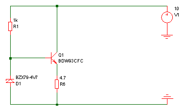

That is the million dollar question how to measure the VBE of the Darlingtons
At Budapest when someone (technician)did matched the darlingtons he used a special circuit at his work place to do so.
If you have advise about these please let us know.
Peoples like DX Carlos and others asked me how you match the Darlingtons..
Good question:)

Hello
Reducing the 68K to 22K will only increase the input stage current
by a 3 factor , hence completely changing the DC operating currents ,
so a lot components values should be changed in the same time.
As already said , the problem do not arise from theses resistors
values but with the fact that they see a voltage rail dependent
current , a problem adressed in the mod i posted where the input
stage current is still the same as in the original , hence all other components
have the same values apart from the VAS emitters resistors that are modded
such that the VAS current stay the same as in the original , about 5.5mA.
The input stage current is about 0.5mA while the VAS has 5.5mA , so using
for VAS devices that have a gain of 100 will yield no more than 50uA extracted
from the input stage to drive the VAS.
That s a good question.....:)
Given the integrated resistors a classical diode tester will be innefficient ,
the devices have to be measured at relatively high current mounted
as emitter followers.
The schematic below should be adequate if a regulated PSU is used.
The device dissipation is about 5W so it must be mounted on a heatpreader
with the voltmeter connected to base/emitter before powering since the Vbe
will deacrease with increased temperature.
