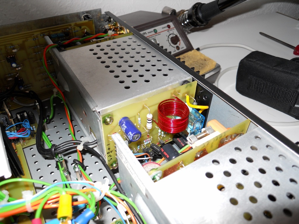

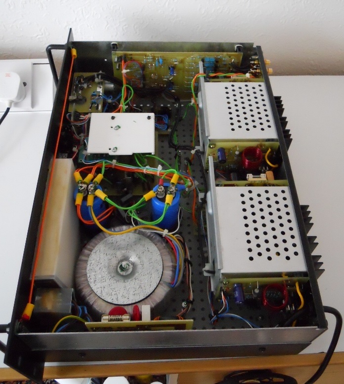

Mooly,
In a second I thought it was the amp pcb outside the cage. So you put the output coil in the protector pcb.
The sub casing looks like a faraday cage. I don't know how to design a faraday cage yet but i plan to use it everywhere in my amp. In the past i just used random shape more or less like your sub case.
At audio frequencies, a "Faraday Cage" is simply metal sheet. The holes you see in Mooly's pic are for cooling air circulation and don't form part of any design relating to Faraday's discovery. At VHF and higher frequencies, we can consider the hole or mesh size to be important and subject to appropriate design.
Sure, people like to use important sounding names to be cool but you don't have to design anything. If we need to shield our audio gear from EMI, RFI etc. we simply enclose it in a suitable size, grounded metal box as radio, audio etc. manufacturers and serious DIYs have done for around 100 years.

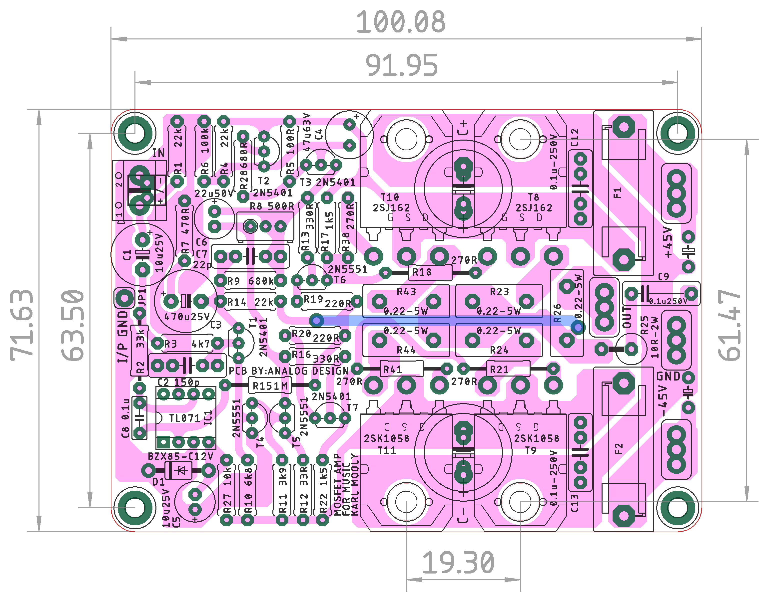

Hello Mooly,
If a 2U case such as the one (dissipante) available from diyaudio store to be used, the width of PCB needs to be less than 80mm. This got me thinking that I need to reduce width at the same time keep the length to less than 100 mm to take advantage of PCB costs from China. Many compromises had to be made to achieve this.
So I came with the attached plan of layout, by reducing component package options . It would be challenging to fit components and solder them, but should be doable if care is taken and properly planned. Test and measuring would be critical too with compact layouts (no shaky hands).
600mW resistors can now be similar to https://www.mouser.in/datasheet/2/447/Yageo LR_MF0_2013-775182.pdf with 6.8mm length, 2.6mm dia, 1%, with TCR of 50ppm can be easily fitted. Power resistors can be BPR58 low-inductive current sense series.
I have a few queries, would be grateful if you could answer them.
1. if one were to use 45V psu, is the distance between the o/p pair ok for proper dissipation? My thinking was that, 2 pairs mean a larger area of contact in which to dissipate the heat so would be ok.
2. If fitment of decoupling caps between the mosfets is too inconvenient, can they be fitted at the supply input and ground (see additional pads provided provided near -45V and GND connectors and also near +45V and C9) and hung off board horizontally? In order to isolate these caps from heat of the heatsink, some thick foam tape could be used on the heatsink. 105 Deg. parts preferred here.

Prasi,
I absolutely laud your efforts in trying to optimize PCB sizing in order to make it cost effective as possible for the DIY enthusiast to undertake such projects. On the other hand isn't the PCB cost only a small part of the total outlay in actually building an amplifier?
I am making this post NOT to offend or criticize the hard work folks like you do for FREE for the DIY community - it is rather to make a point for folks like us who buy the PCBs for the group buys, that we should focus on the total cost and not only on the PCB. I would rather pay a little more for the PCB if the form factor allows easy assembly and it's possible to use with more widely available /low cost chassis.
This project is a good example of such a case - the 100 mm x 100 mm PCB would require a 3U chassis, whereas a 50mm x 200 mm PCB can fit into a slimmer 2U chassis if thermal characteristics of the amp allow that. The 50mm x 200mm PCB size is just a stated dimension, I am not claiming that it would be possible to do a good design using those exact dimensions - that is for the layout artists like Prasi to decide on.
I have stated my understanding / point of view, would love to hear from other folks.
two or 3 things
1. There are many people who still do home etched PCBs, so thats why single sided design is maintained and pdf's are posted. Not all people have time and resources for group buys OR manufactured PCBs.
2. less than 100mm length allows people order PCBs for themselves individually without having to depend on anyone else or the GB to go through.
3. 2U case is considerably cheaper and widely available especially old amps or from scrap dealers, old instrument cases etc.
first design is 2 pair o/p > 100mm length and 3U case
second one is 1 pair o/p <100 mm length and 3U case
third one is 2 pair o/p <100mm length and slimmer width (vetting by designer awaited)
I purposefully designed them such that all three can be done at home without having to depend on manufactured PCBs either through GB or individually.
I think people love choices to see what they have and what can be used from existing stock and existing chassis.

There should be no thermal problems as long as the heatsink is sufficient. For normal use (music) the single output pair amp runs very cool. A dual pair will run hotter due to doubling up of the static dissipation.
The decoupling looks OK and you can always mount small caps under the board.
Trimmers can be a problem for long term reliability and particularly where relatively large currents flow in them. Although the VAS current would be within the spec of many trimmers my personal recommendation is to always replace with a fixed value part.
Hello Prasi,
I have one question about all these PCB : why every body put the power transistors completely under the PCB ?
As you know I have decided to build the Quasi (an other amplifier) but as I wanted to put it in a very low profile chassis even smaller than the 2U dissipante : Boitier DIY 100% Aluminium avec dissipateur thermique 271x226x70mm - Audiophonics . I redesigned the PCB because the four others, including yours, were too big. To keep the PCB small enough, to have a better cooling and an easy mounting, I put half part of the power transistors outside of the board
One other possibility to keep vertical size small is to put the power transistors on left and right side of the PCB instead of top and bottom side, this will also improve cooling since they will be more space between them and the bottom transistors are actually warming up the top ones
An other way to save space could be to remove fuse that can be fitted on an external protection module with a DC protection relay.
As an example of these modifications, I show the PCB that you kindly improved for me

Hello Marc,
If one has an idea of the actual case and heatsink, then a better custom PCB can be designed considering mechanical constraints, such as your case of quasi complimentary amp as you already knew what case and which heatsink.
Remember, quasi is double sided, whereas this one is single sided. So, simplest layout with minimal jumpers and with minimal trace lengths is priority and it also depends on circuit complexity, type of components and number of o/p transistors.
Fuses: I place them on amp PCB or PSU PCB, to minimize wiring and connectors.
If something very specific is required by someone, then there is always the link given in my signature.
