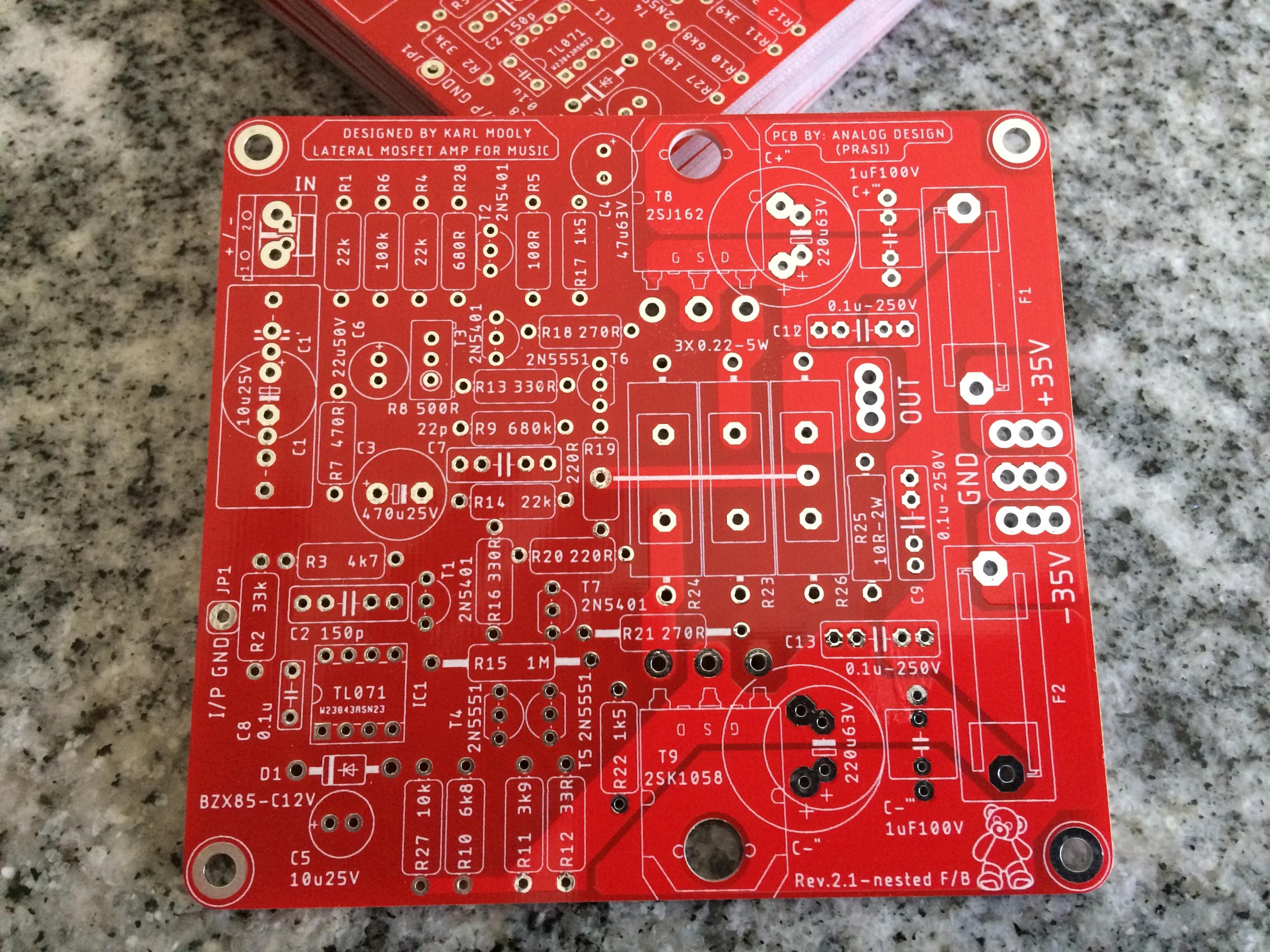

Hello Marc,
Completely under enables more effective utilization of space inside the cabinet as well as on PCB.
If the power transistors are out, although PCB looks small, the area covered by PCB+ Transistor body is the actual real estate used.
So, if transistors are completely under, then you can put components everywhere on the PCB. I am not so good in describing, so please try to imagine.
I would imagine side to side or up and down are more or less equal and again as I said depends upon case you are planning and circuit and number of o/p transistor.

What is the bias for this amp, I’m ordering the output devices tomorrow but would like to know the approx required C/W of the heatsink for each channel.
Since my load is 4 ohm, is it best to use a +/- 35v supply instead of +/- 45V ?
My output will be a single device, ECX10N20 / 10P20 per channel.
Eric
Eric
Aim for around 100ma (for a single pair) which is the optimum point for bias stability for a circuit such as this.
-/+35 volts sounds fine for a nominal 4 ohm load and should be able to deliver around 60 wrms into that impedance. Heatsinks for normal music duty (as opposed to 24/7 sine testing) would be around 0.7C/W. The heatsink requirement is no different to any other AB amp and is usually a compromise between size and cost.

Since you didn’t mind, I sent the Gerber files to PCBWAY and got them back today.
Special thanks to you and Prasi !

Nice red PCBs Eric - assuming you got a few extra boards? If yes, how much would it be for a pair?
If I remember correctly the cost was $15 usd delivered to my door so 1.5 usd per pcb.
So basically $3 usd for a pair + price of padded envelope + shipping
I do not intend to start a GB but I’ll sell at cost 3 pairs.

Hello Mooly,
If a 2U case such as the one (dissipante) available from diyaudio store to be used, the width of PCB needs to be less than 80mm. This got me thinking that I need to reduce width at the same time keep the length to less than 100 mm to take advantage of PCB costs from China. Many compromises had to be made to achieve this.
So I came with the attached plan of layout, by reducing component package options . It would be challenging to fit components and solder them, but should be doable if care is taken and properly planned.
