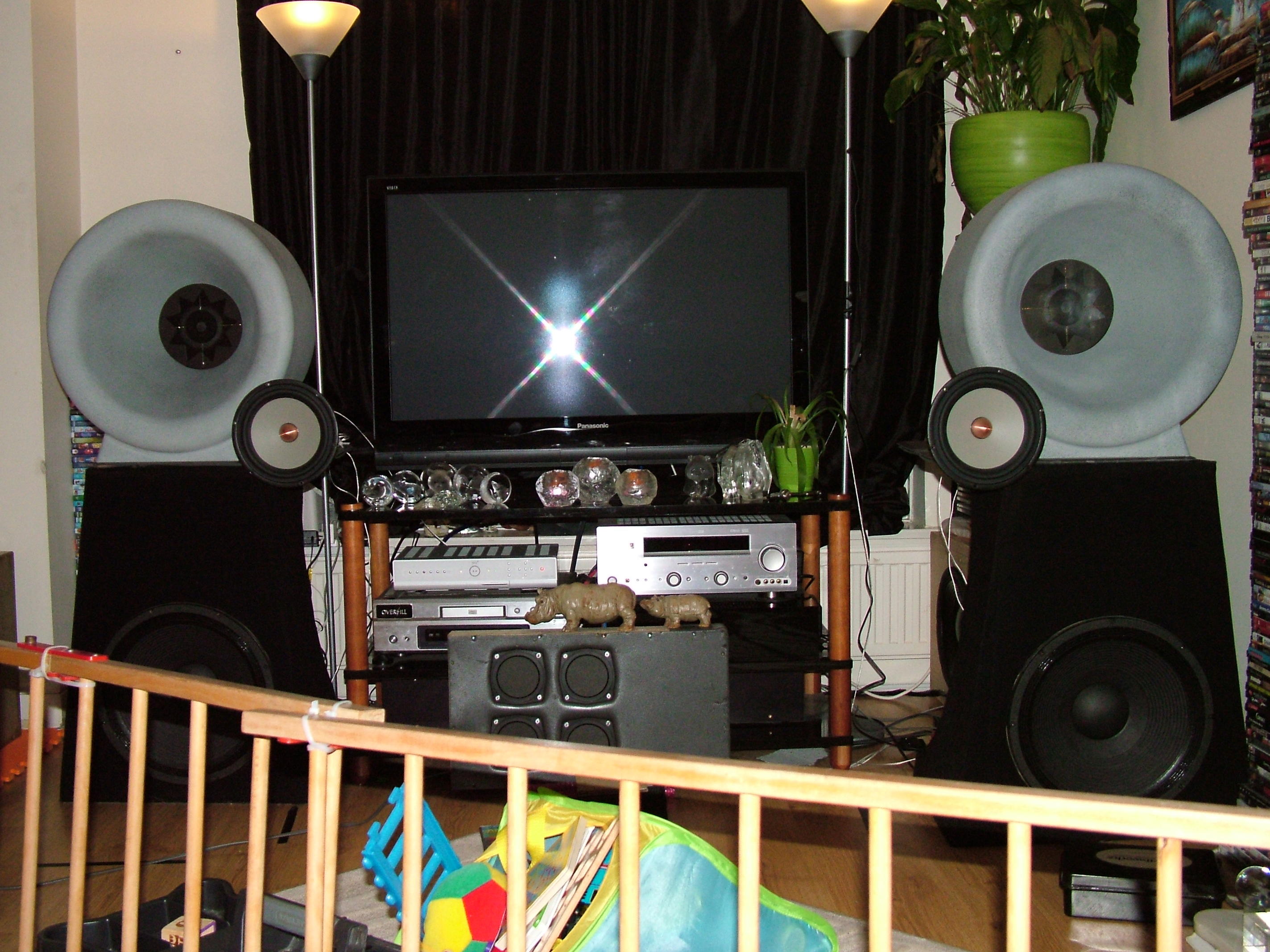

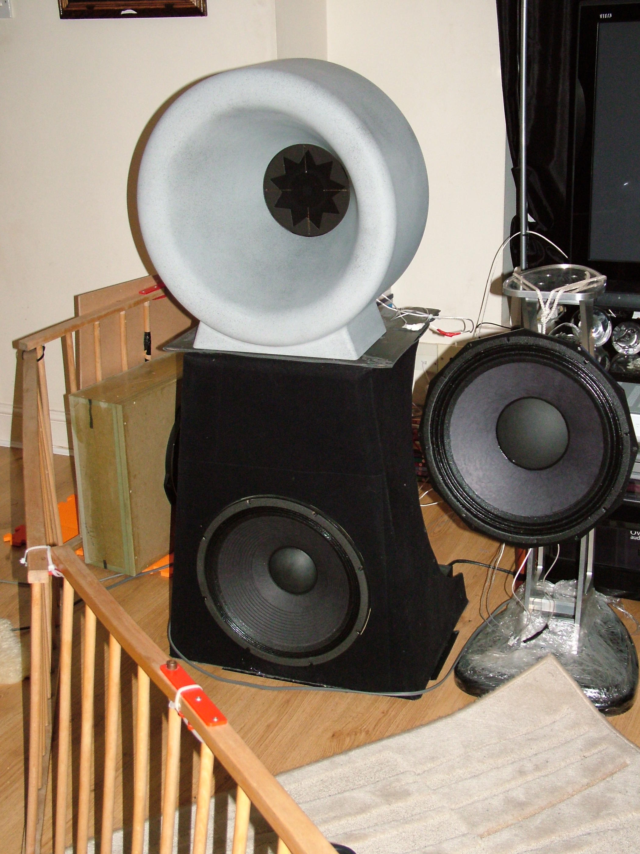

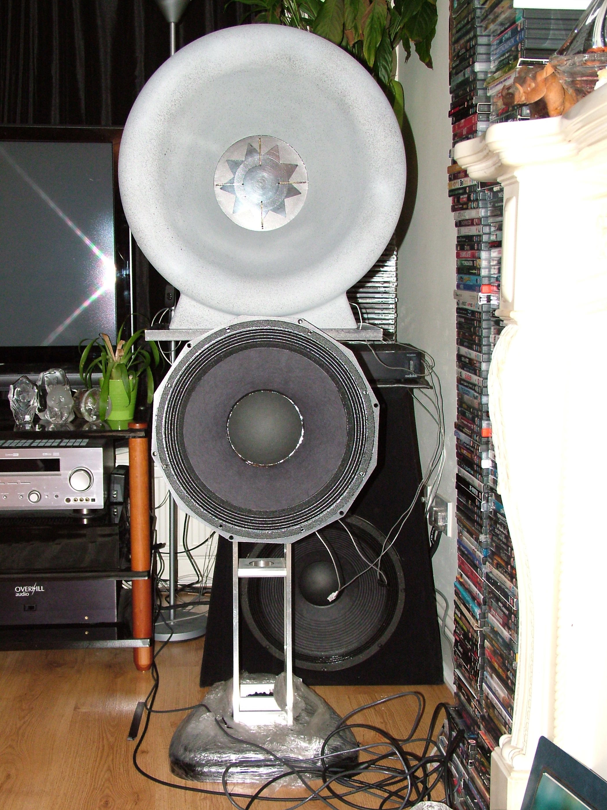

A bit back on topic.... the 21" woofers I use in H-baffles are capable of low distortion response to 30 Hz. I just wonder how much bigger they must be to go even lower.... say 25 Hz?
Anyway, I would like two of them per side! They produce the best bass I have ever heard, but I want MORE and LOWER.

How about mouting that 15" a bit lower to avoid the floor bounce suck-out in the 300 Hz region?
I did try a 15" as well, worked very well, but I like the lower midrange of two 12" better, although they cant go as low into the bass as the 15".
