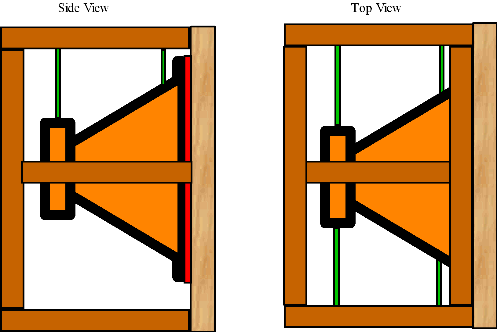

I remember seeing a guy that designed a frame type of construction and using rope suspension to hang his speakers from. If I remember correctly I saw this around 3 years ago but I don’t recall on which forum and of course now I cannot seem to locate anything about it. His design was open baffle and the baffle was isolated from the speakers by foam seals. The speaker was hanging from several ropes from both the top and sides of the speaker. The use of ropes from the top as well as the sides allowed him to align the speaker for mating with the baffle.
I have done a simple sketch to try and explain the concept but it is a quick effort on my part and you would need to adapt it for your individual use – if you used it at all.
Just some food for thought.
Yeah, yeah, yeah. Over on the open baffle section of Audio Circle. Who was that? Rudolf? Sash cord to hold the drivers in place. I can picture it....
EDIT: Oh, no it was Skorpion, of course!
Here's the link. http://www.audiocircle.com/index.php?topic=40594.0

That isn't the one I had in mind - The one I saw had a framework behind the baffle the the speakers hung from and the baffle got shoved up to the frame but was isolated from the frame and the speaker with soft open cell foam. Skorpion had a nice effort tho - something to think about.

.... thought I slap together what I suggested and do some "revolution of rope & hot melt glue" and show some pix for inspiration ...
:D
a one hour work - plus shopping
Michael
