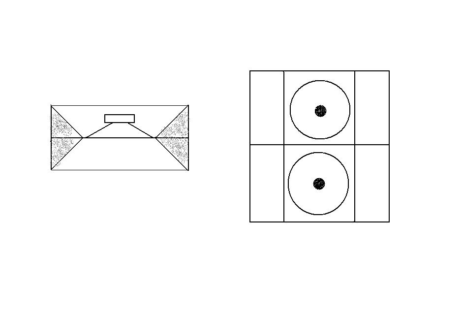

Virtually the same frequency response as the smaller H-baffle I had before, but 8 dB higher in level. 6 of those dB is because there are two drivers wired in parallell. The baffle is also 10 cm taller and deeper, and twice as wide. That's where the last 2 dB comes from I guess.
Some years ago I had two 18" in large bass-reflex boxes... they were a lot louder than this! However... its more than sufficient low bass now, can also reach 20 Hz easily.
The weakest part of the baffle is the top and bottom plate. They're not stiff at all, but I'm amazed at how little they actually vibrate. This is a prototype though, built from cheap 19 mm MDF. If I do a "production" version, it will probably be in birch ply that is stiffer than MDF.

OK... here are some observations of the dual 21 H-baffles.
a) They are loud enough!
More than sufficient for church organ, synthbass and other extreme stuff.
b) The baffles should probably be build a bit stiffer... easy to fix
c) I have -6 dB @ 16 Hz with 26 dB of EQ. A loooot of EQ, I know.
d) Eady to get 20-100 Hz +/- 1 dB without much more EQ than dipole compensation. That would be impossible with closed box woofers.
