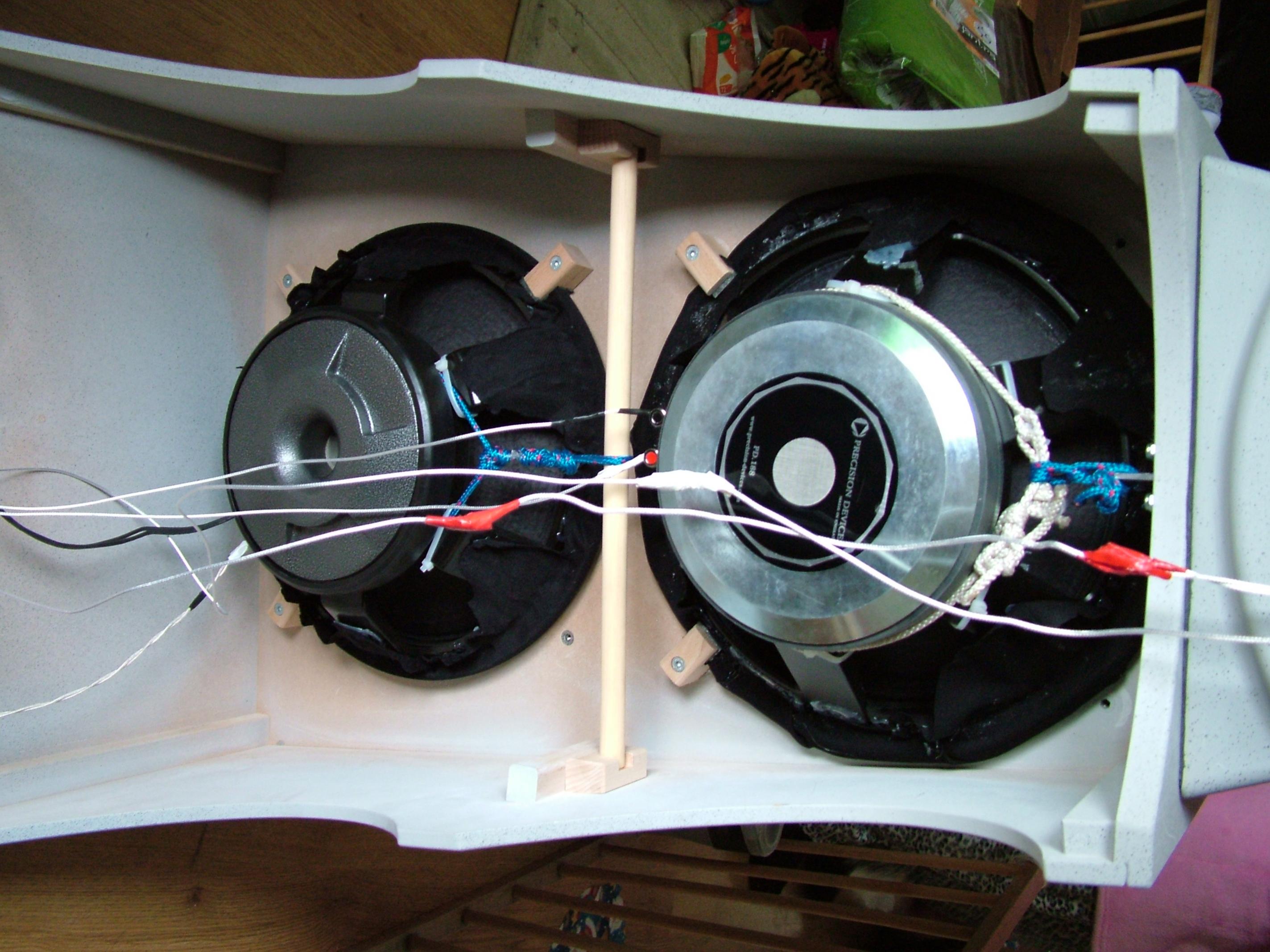

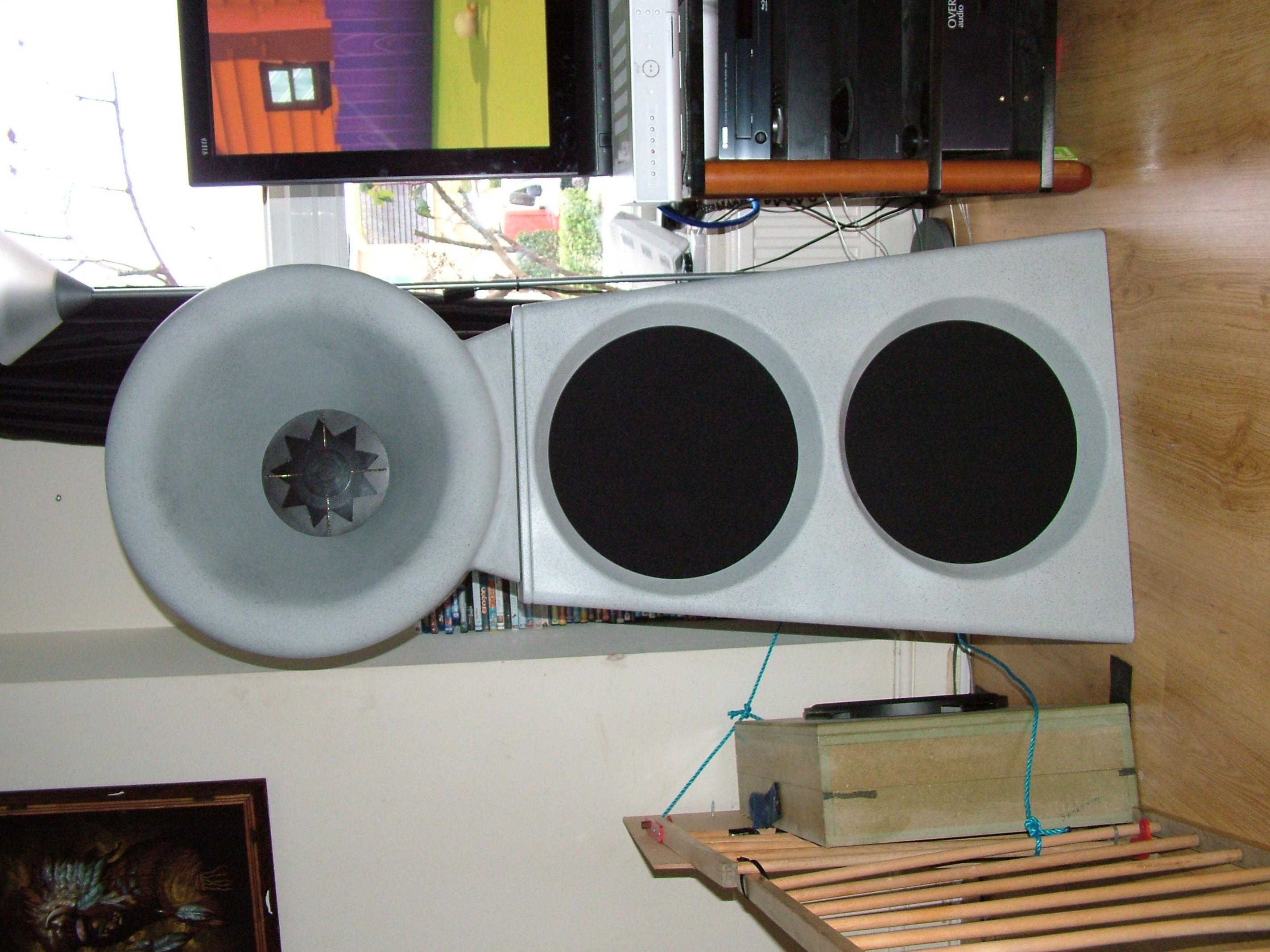

I have attached a couple of pics of my Christmas project, still developing it but I can’t stop listening long enough to any more work....!

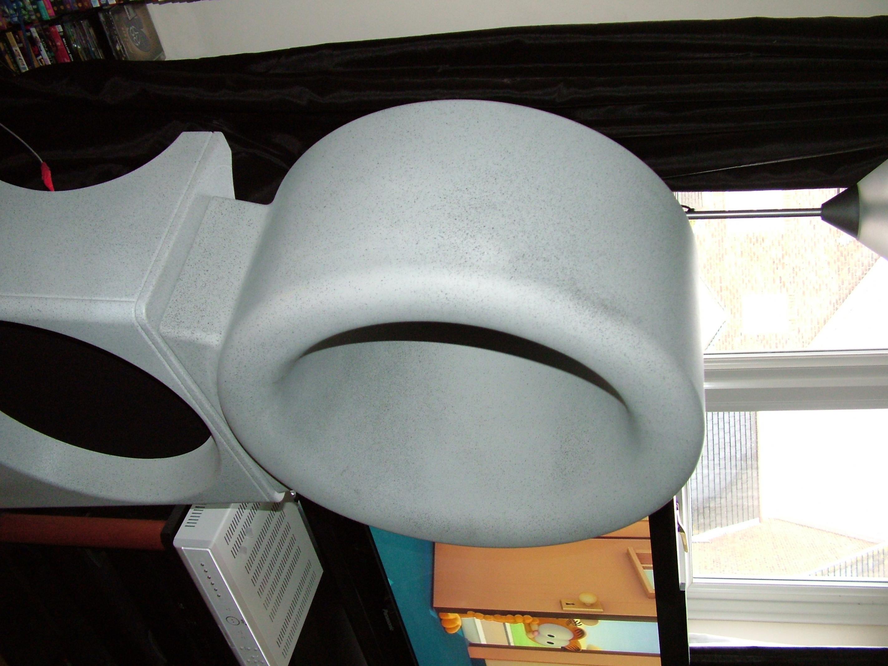

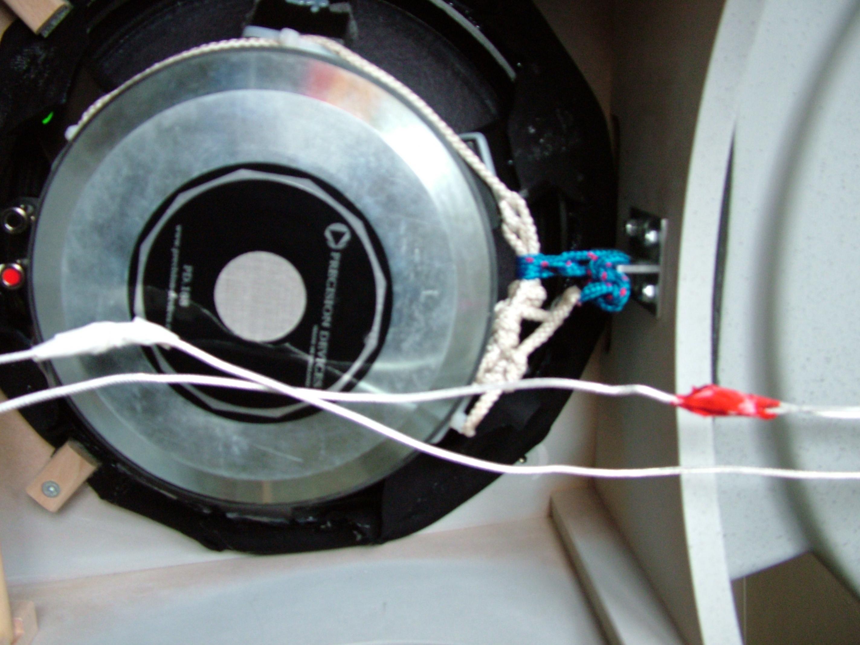

Hi All,
VPL sides give effective baffle width of over 1 meter with none of the cuppy, boomy tunnel effects of a backless box.
Also the greatly reduce the audible effects of the baffle step as the "step" is now a gentle slope...!
Front baffle is 60mm thick with CNC machined mini wave guides on the Precision devices 15 inch low mid and Beyma 15 inch SM115K bass. Changing this to a 15 inch Precision devices driver, twice the price but worth it for sure.
Will use stainless steel wire to hang the drivers, the rope is too ugly!
Planning some changes to Manger horn profile / dimensions.
Performance is off the scale, too many old audio clichés spring to mind so all I can say is I am very, very happy...!
How about trying Stigs design with a pair of Mangers replacing the TPL / ribbons, Seas 5 /8 inchers?
Manger down to 400Hz, a single 15 inch or pair of 12 inch driver covering 400Hz down to 60Hz to 80Hz and then Stigs "mother of all OB subs" (love them!) covering low / sub bass?

Very nice work there Derek!

Hi All,
Derek.
How you like hanging drivers so far?
Michael

Hi Michael,
I agree with Stig Erik, very interesting ideas you have.
I really appreciate the way you give clear and simple analogies / experiments (i.e. PC mouse / rubber band angle the desk) to explain your technical points which obviously comes from your much deeper ( than me anyway..!) understanding of Physics. Thanks!
In my system I rate the sonic improvement from " hanging the drivers " very highly. Bigger upgrade than doubling the amount of money you spend on drivers. The main sonic improvements are:
(1) An obvious reduction in lower "hash and noise" that I didn’t notice until it was gone! This was more audible with the 15 inch cones than the Manger.
(2) Much better focus ( and it was great to begin with!)
(3) More "liquid sound" i.e. so easy to get lost in the music and forget to analyse the sound.
(4) Astonishing transits and slam. Really wow stuff on percussion and big band brass / horn sections!
I am using a large SD of driver to relatively small cabinet area ( twin 15 inch drivers close together, 60mm thick solid MDF trapezoid baffle, shallow VPL sides and small top)
The improvements will vary with Sd total Vs area of baffle / speaker cabinet.
Cheers
Derek.
