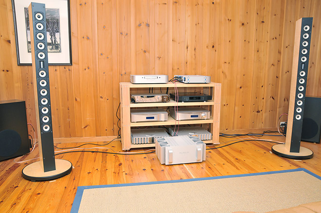

Do you have any experience with line arrays and if so, what kind and what are you impressions and comparisons?
Have not tried a line array at home, no. I am thinking about it of course, but the costs are a bit frightening.
I've heard a few, one of them quite good actually. That one is not a true line array though, only in the midrange as the pic below shows:

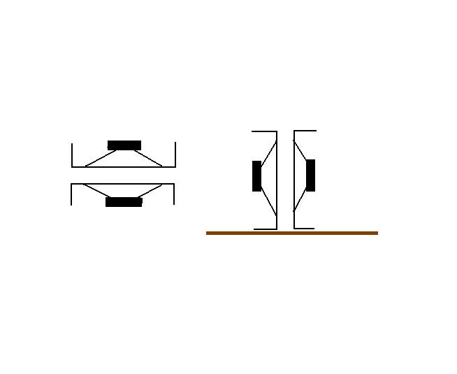

I did a very precise MJK simulation of what the Beyma 21" Nd would be able to offer. It as I said it would fail on a plain baffle. In an H-baffle it would have a lot more performance to do, but would need great EQ. Now Stig-Erik has done double 21" Beymas H-baffle and they are performing. They should do ! But all in all I think that what is revealed is quite in line with my first simulations.

My findings regarding the 21" Beyma is that it cant play below 40 Hz "naked" without severe distortion and noise. The fundamental tone will be lost, all you hear is upper harmonics and wind noise.
In an H-baffle however, things change a lot. In my current H-baffles, 25 Hz is reproduced cleanly up to at least 100 dB SPL, which is very good.
I measured the sensitivity of my H-baffles.... at 100 Hz its a stunning 119 dB / 1 meter / 2.83 V. There is of course some cheating involved, since both 21" drivers are 4 ohm, and driven in parallell (from separate amps). If I was using two 8 ohm drivers, it would still be 116 dB / 1 meter / 2.83 V. That quite amazing I think! The dipole peak is the main explanation for this sky-high sensitivity. The peak is very wide, causing an almost perfect 12 dB/oct roll-off below 100 Hz all the way down to 20 Hz, making EQ very easy.
I have +26 dB of EQ @ 20 Hz, meaning that the sensitivity @ 20 Hz is 93 dB. Not bad!

I think Stig-Erik answered very precise.
As parameters are not very optimal for dipole usage, a bit regardless of baffle size. H-loading is a good way of providing air load and helping with low bass performance and really doubling units I think was both necessary and instrumental in achieving desired results. What one can be asking to is if for instance low drum beats are absolutly optimal compared to lower cone weight units. But I think Stig-Erik will be able to answer this.
