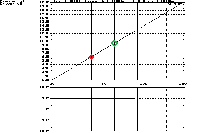

How do you estimate this +6dB respectively +9dB ?
*If* you go by the OB SPL canceling effect, the THD rate - relative to closed box (or infinite baffle) - would depend on frequency response (or more exactly to excursion per SPL) relative to closed box (or IB) - no ? Did I miss something ?

Yes - frequency response will affect distortion. If the response is rising at high frequencies, the higher order distortion components will be amplified. The same goes for the 6 dB per octave loss of dipoles.
My graph below is showing a 6 dB/oct curve, with 2nd and 3rd harmonic of 20 Hz pointed out. As we see, the 2nd harmonic (red dot) is 6 dB higher, and the 3rd (green) ~9.5 db Higher.
