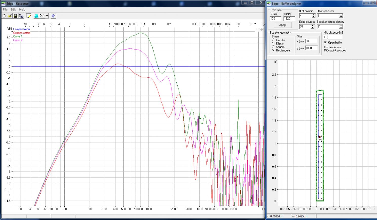

Hey,
and I found some frequency and distortion data on the BG 75 in Dipole-mode. The measurement is shown in a thread at Hifi-Forum in Germany done by Tiki. It was done inside at 12,5 cm distance at aprox. 80 cm of ground an are claimed to be roughly spl-calibrated. Because it´s a number of graphics please click yourselves through them:
Index of /skvf/speaker/linearray/messungen/20060114
To me the distortion behaviour seams not to be perfect but still not critical. OK, there is a rise of THD around 1.5 - 2 kHz though it is not dramatic. And they imo show clearly that crossing the RD 75 at 180 Hz is no problem. But I am not very used to the interpretation of multi-tone measurement.
Those who are interested can find the whole tread from witch the measurements are taken here: http://www.hifi-forum.de/index.php?action=browseT&forum_id=104&thread=5195&back=&sort=&z=1

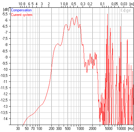

@ sendler, Edge works with an ideal source and is a little over the top sometimes, what makes a simulated line source look much wilder than it acoustical appears to the ear. Obviously the real RD´s are different than the simulation - look at the amount of EQ Stig applied to get it flat. The RD´s don´t need a baffle.
And Edge is free and easy to use: Home of the Edge
