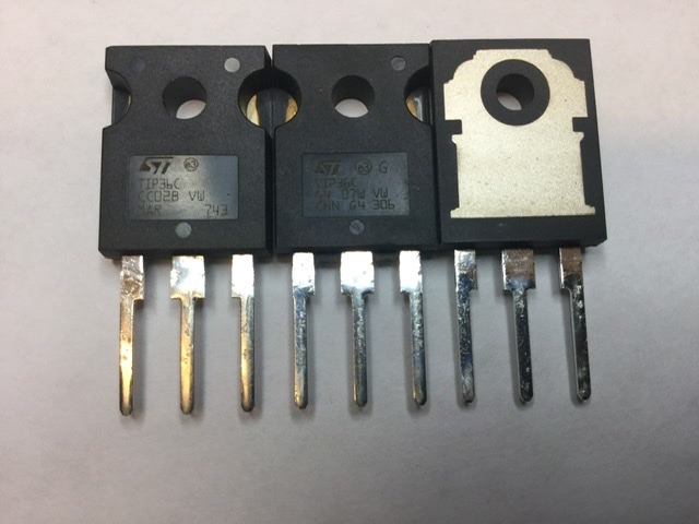

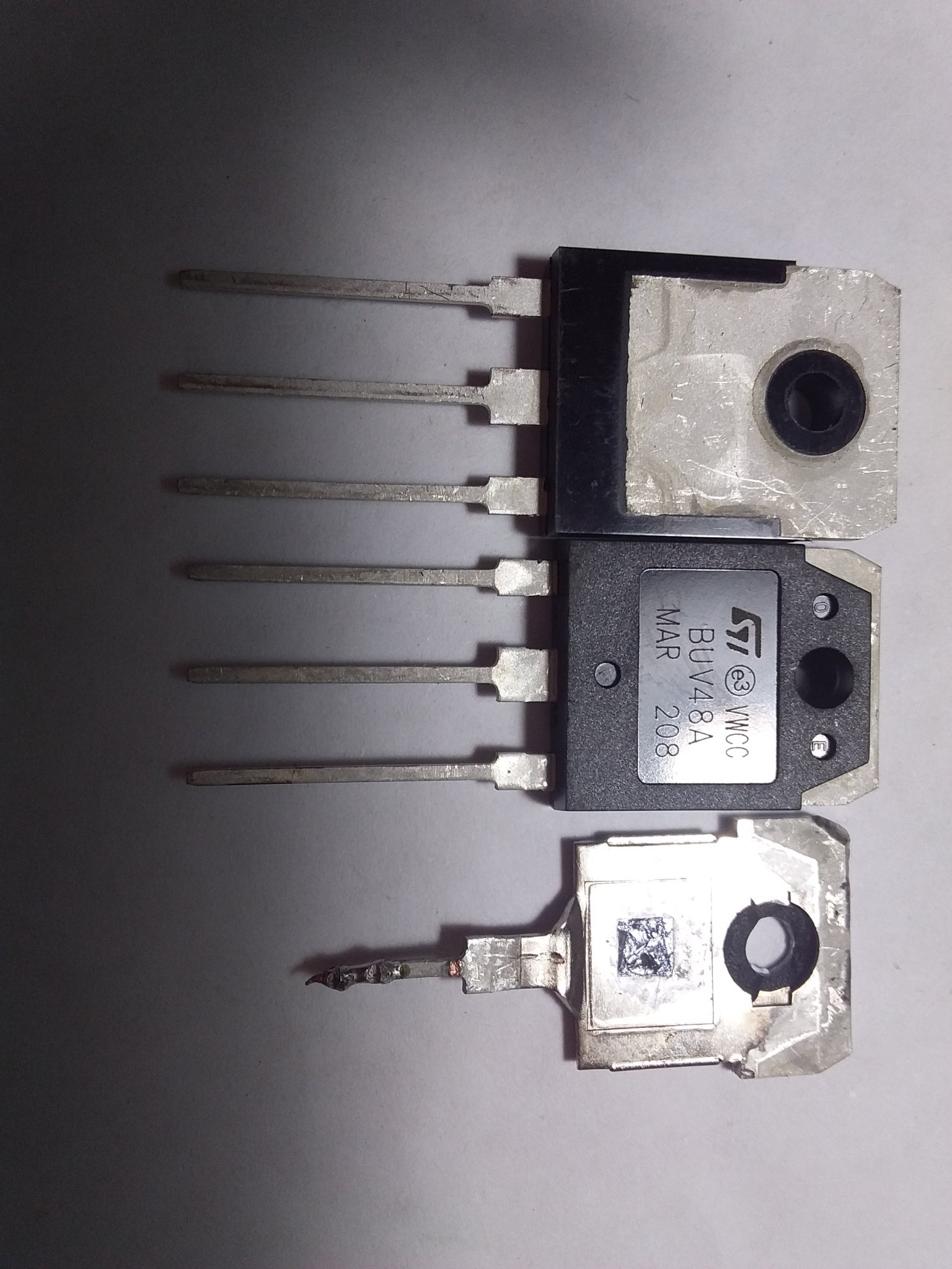

I apologize, you are right, I should provide more information about it, I got the material from a trusted supplier, but when searching for the ST company datasheet I did not find that it is manufactured in this type of encapsulation, so I thought someone from here I could easily recognize if it was counterfeiting or not, or have some information if ST outsources the manufacturing to another company. I took measurements and it seemed to behave well, but the encapsulation caught my attention, Regards

BUV48 would normally be in TO-247, not TO-3P. A TO-3P version would be BUW48. It does NOT look like an ST lead frame. The back side is quite unique - going back all the way to the TO-218 when it was just SGS. The corners are beveled off on the TO-218/3P, but the notches were always there.

That package is all wrong, but the innards dont look like what they put in fakes. It looks like a real OnSemi package. Markings do look like ST. My guess is it’s a re-mark. What’s the hFE on these things like? Real BUV/W48’s are pretty low (20 maybe 30) but linear. If it measures 50, 100 it’s probably really another type being passed off as BUV48. It’s just as common as outright counterfeiting with 2N3055 (or smaller) dies in them - and white goop.Sacrificing a transistor on behalf of everyone so we can observe, what do you think? I do not have another original model to compare its interior, Regards
