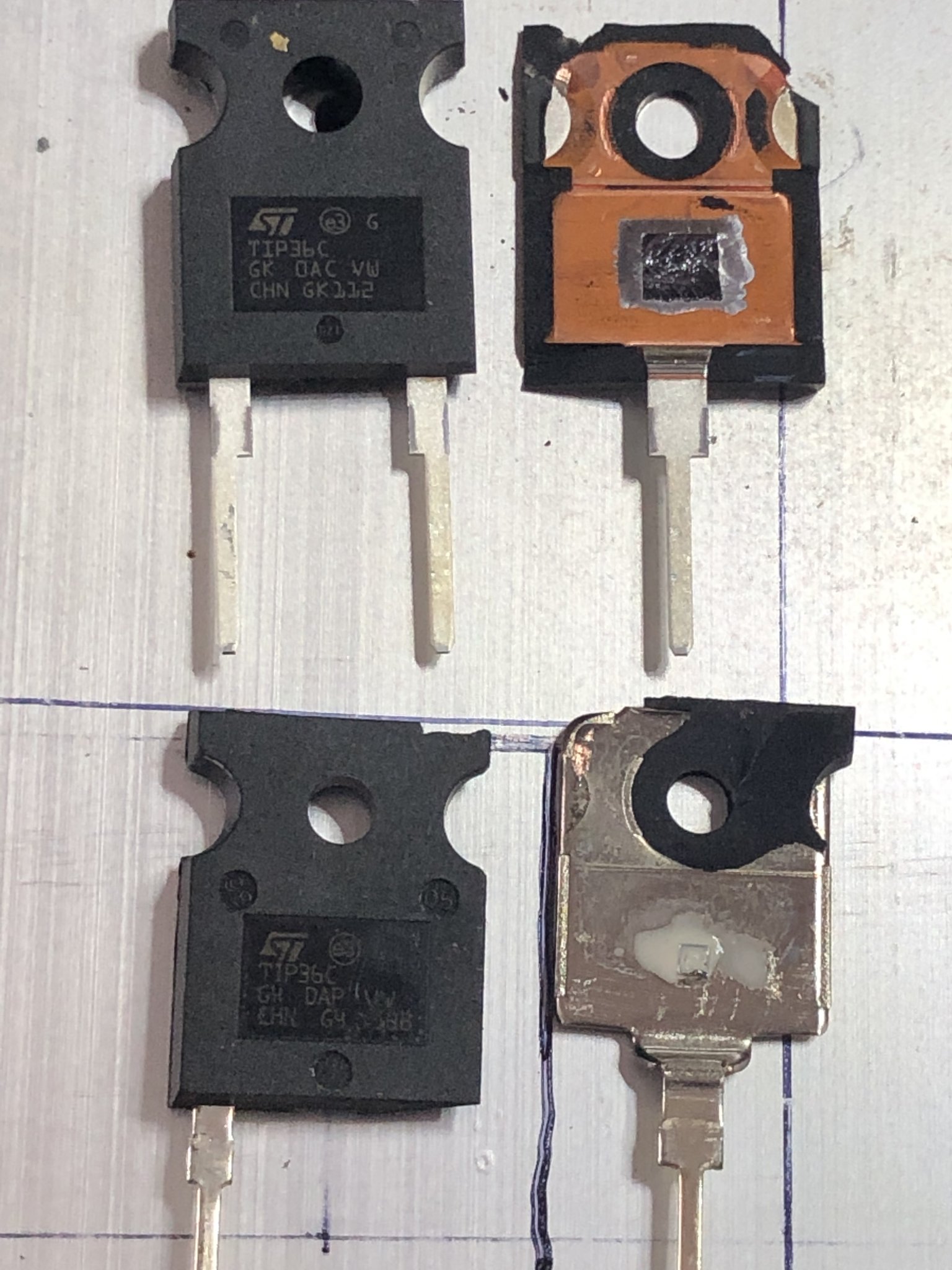

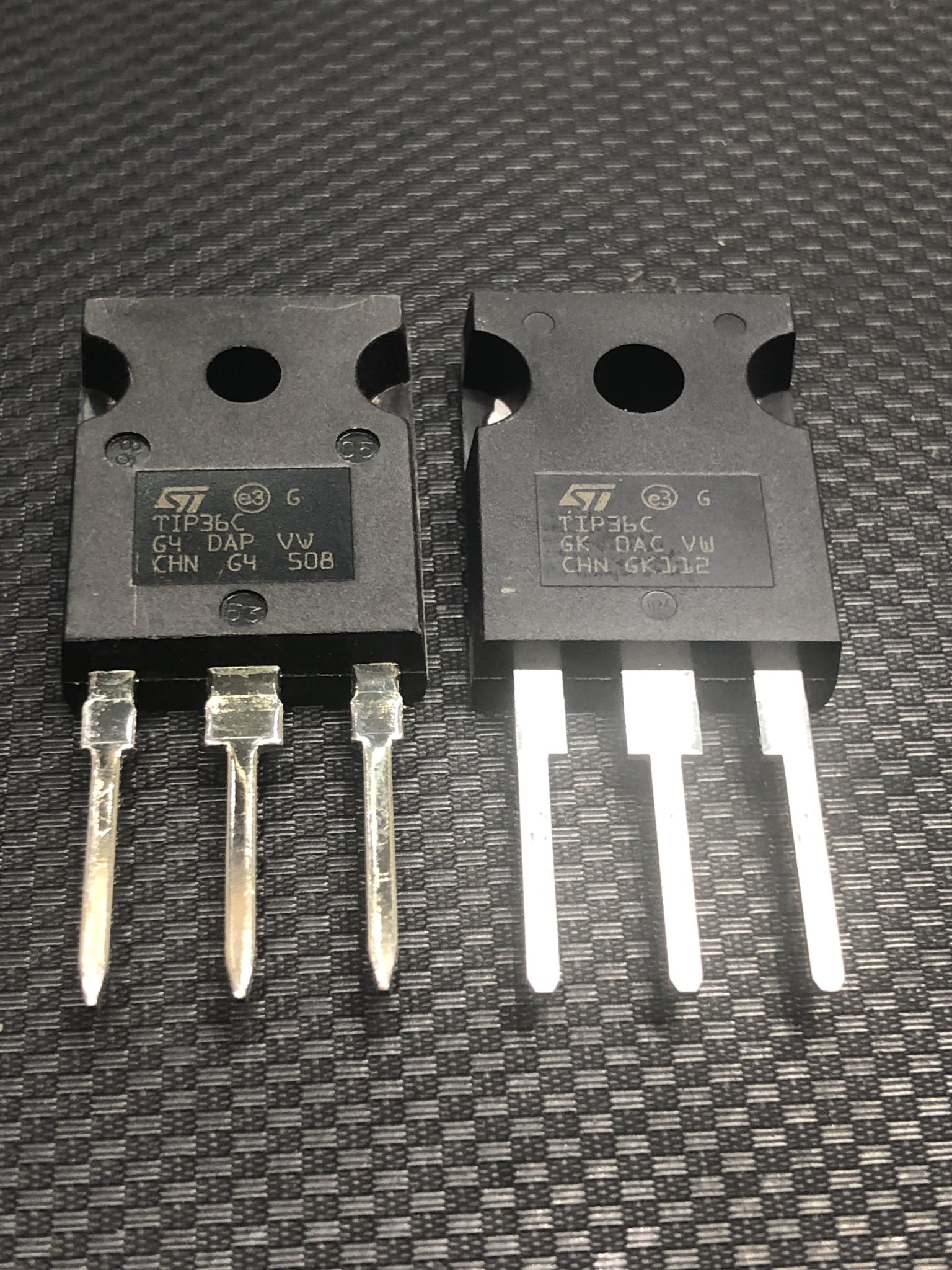

Unfortunately, it is very difficult nowadays to differentiate a fake from a genuine unless it’s a very poor copy. I bought some power transistors from an online source and they were failing in a voltage regulator power supply project. I bought some from an authorised source. I cracked open a genuine and the fake. The telltale sign is obvious. The fake die size is very small.
See the markings they are so closed to the genuine part. The part number is TIP36

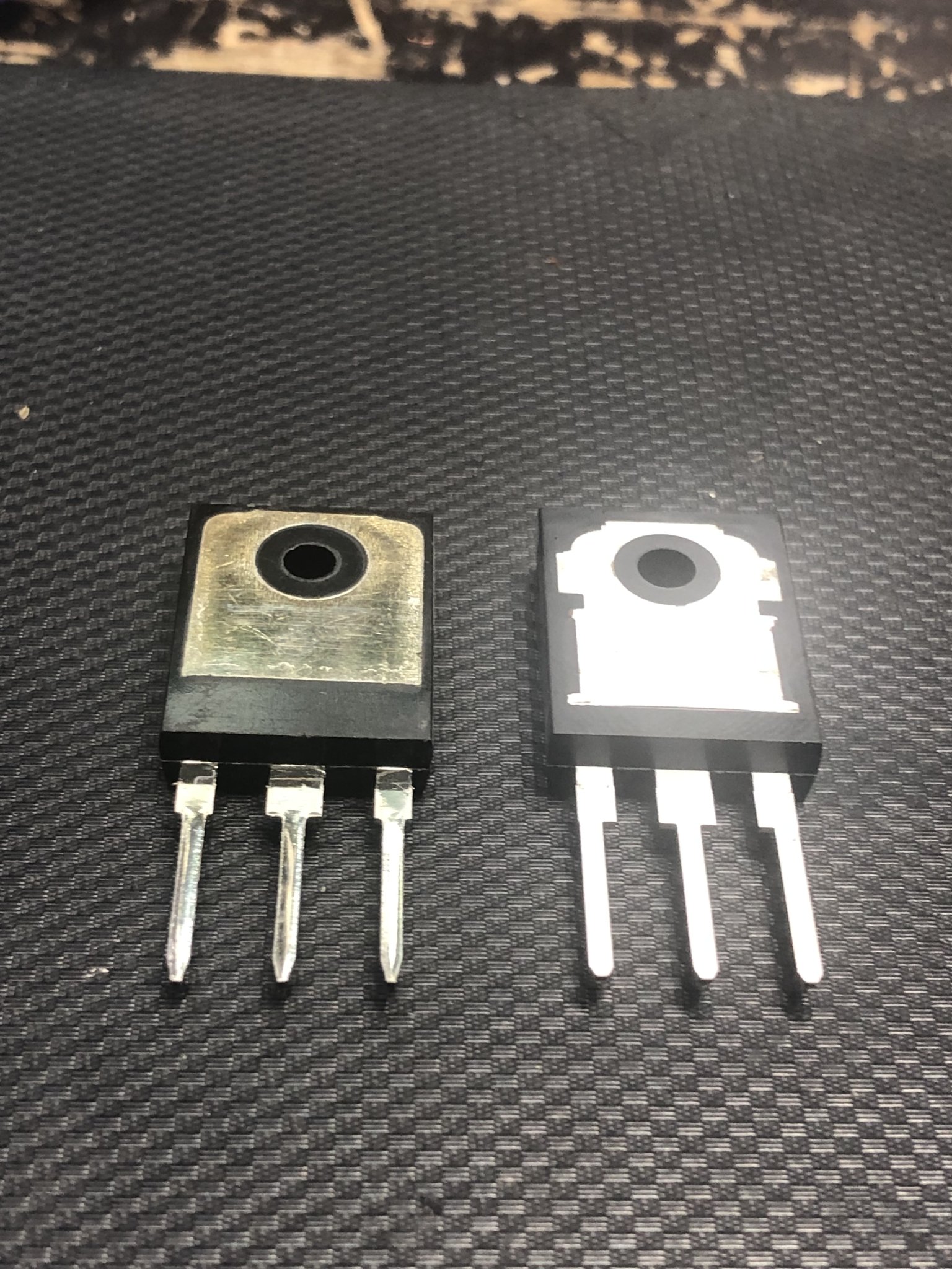

Would you mind to post pictures of the back side? I bet they're not the same. Also the transistor legs aren't identical.Unfortunately, it is very difficult nowadays to differentiate a fake from a genuine unless it’s a very poor copy. I bought some power transistors from an online source and they were failing in a voltage regulator power supply project. I bought some from an authorised source. I cracked open a genuine and the fake. The telltale sign is obvious. The fake die size is very small.

These fake ST transistors are very common. Problem is buying from unauthorised stores, because they tell half of the story. My recommendation is, at first you should check datasheet thoroughly to get an idea of the transistor package then try at surplus houses or offline stores to get such general purpose transistors. Otherwise buy from authorised store.That “Liberty Bell” shaped leadframe is very unique to ST - no need to crack one open. If it doesnt have those notches it’s a fake. Or at least not an ST part.
![twocents :2c: :2c:](https://files.diyaudio.com/forums/images/smilies/twocents.gif)
The fakers probably can’t buy the ST lead frame, and it would cost them money to go get generic ones they can get machined to look like that.
It actually serves a purpose other than making it hard to copy - better adhesion of the mold compound to the lead frame. They have been making it like that for decades.
