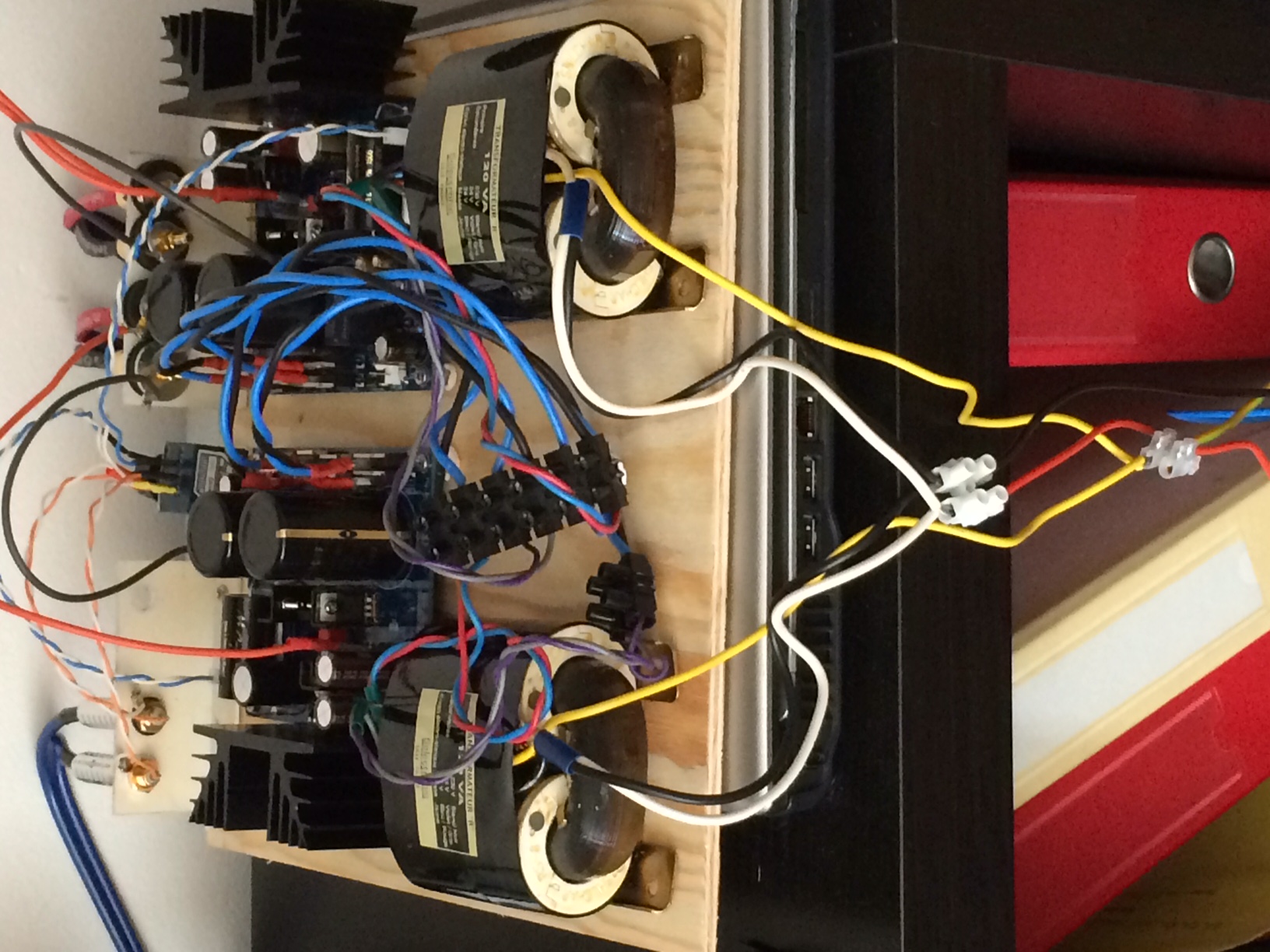

...in tested phase, cabling and case not perfect
... KZ/C9 and plays wonderfully already!

Bom Mouser except:
C12, C30, C32 AMCH
R12 Charcroft Z-foil
C101, C201 Mundorf MLytic AG
C13 Mundorf Supreme
pending Cerafine and the Black Gate
