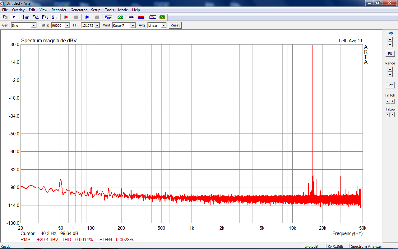

So.. I had been always thinking how far this technology, Mauro's MyRef topology can be extended.. To admit it, this was even more spiced up by the latest developments in Tom's work. Hell, I always wished to do the same.. several current pumps in parallel connected in a bridged config..
Paralleling the pumps is important: recently I had executed a series of stress tests with single (FE style ) current pumps and with the full double pump configuration.
At high output levels and 4 ohm loads the difference is marked.
So without parallel pumps I would not dare to risk bridging. Or rather, it can be done but the results will not be nice.
Then it came that it is so easy, in practice. The Evolution ampifier is a one pcb, stereo channels configuration with paralleled current pumps. One just needs that XLR input connector, drive in antiphase connection the two stereo sides and that's it.

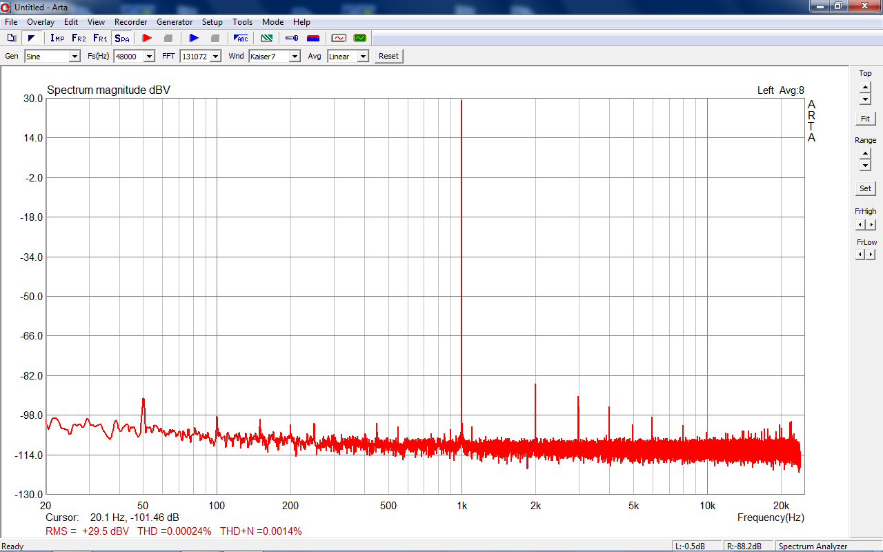

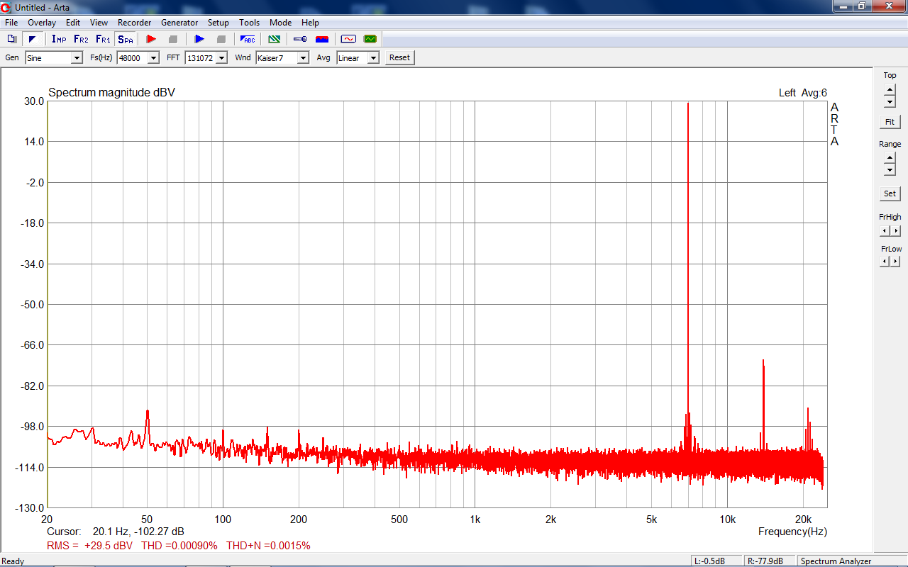

So here there are the test with a 'double barrel' EVO modul as directly connected with two XLR runs to the RTX6001 analyzer.
The analyzer is set to 10V/20dB output drive, and set to the 30dBV (31.6Vrms) input range.
This is just a modest first trial, moderate levels, because I'm using a low DC rails transformer. (+-28V)
The graphs are a bit different from the past format. I wanted to show the real output levels involved, so everything is calibrated to 0dBV reference output (= 1Vrms)
The output is crossed check with a multimeter, when I relieve 29,6dBV I see 30,4Vrms on the multimeter. (should be 30.2)
On 7.5ohm (I have that load, sorry.. it's even nice that it tollerates my tortures) that is ~ 120W.
At this level we are a hair below clipping, with this +-28Vdc transformer.

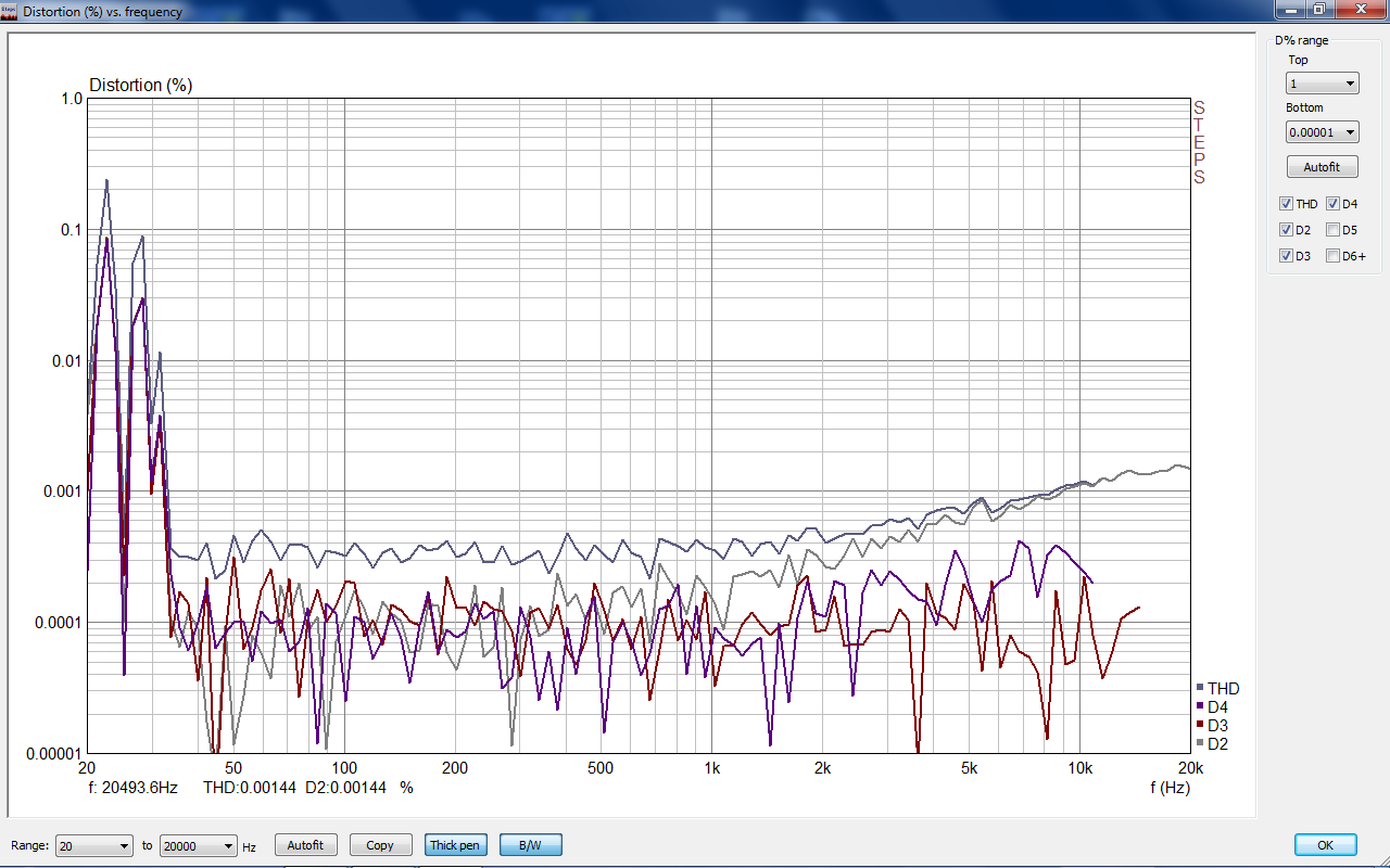

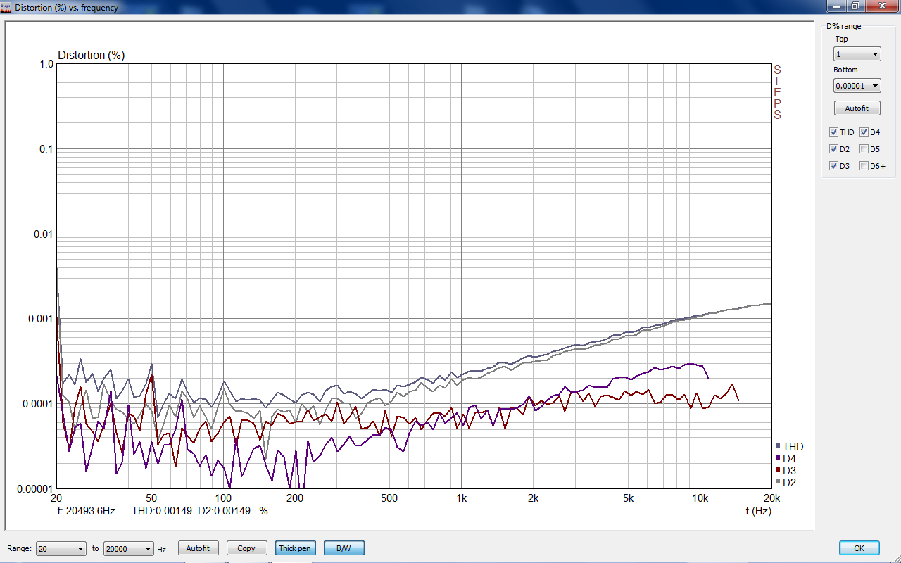

and these are the distortion sweeps with frequency.
The first is a middle value 36W output level.
The second at full throttle, just below clipping. (100W, because of constrictions in the software setting)
(in the low frequency range it does go into clipping, so there are those ugly walls towering.)

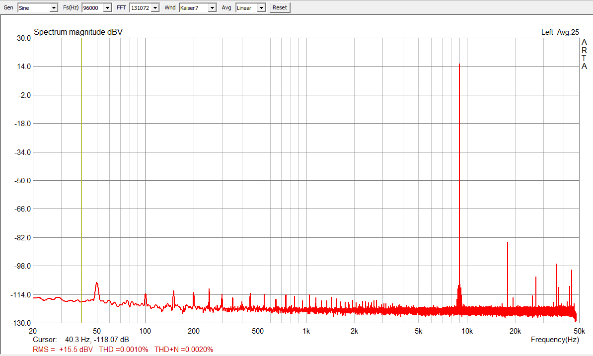

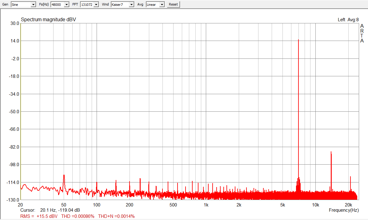

Just last two shots to show that at the usual 5W output level it is measuring almost exactly the same (at that moderate level I could change the RTX6001 output range for a less noisy setting: it does show that even the previous graphs we are limited in the noise floor by the analyser)
