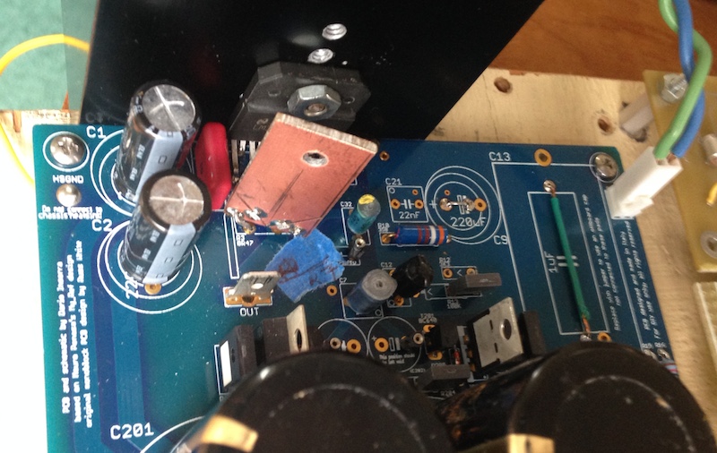

I compared three configurations. First is my old FE with LM318 (no Evo A) and using non-standard caps (C9 is a Jensen axial, C13 is a Mundorf Supreme Silver Oil).
Next is George's recipe for a jfet opamp, in this case using ADA4627 and using jumpers for C9 and C13 (direct coupled).
Finally, the LM318 with a jumper for C13 (direct coupled). Please note that direct coupled can damage equipment. Be careful and test for DC before hooking anything up.
In comparing the LM318 set up to the ADA 4627 set up, it is immediately obvious that they have different character.
My notes say that the LM318 is very pleasant to listen to, musical, warm, without being overly colored. Maybe smooth is the best word. I also found the 318 to be more dynamic than the 4627. But in contrast to the 4627, it is clear that there is a haze above the music and less separation between instruments. When many instruments play together, the individual instruments are unclear, it becomes one massed sound.
The ADA4627 can be described as transparent, clear, uncolored, and present. It has very good instrument separation, even when instruments are playing in mass. There is very little upper haze. On the downside, I found the sound to be sometimes a little clinical, lacking warmth. Since the goal is not to change the music, the 4627 is a clear step forward with strengths that far outweigh the negatives, but of course, I am using an old BOM and may be able to improve the negatives with better matched components.
I also ran the 318 with a C13 jumper to see how much of the difference was due to this change. Overall, I would say that the 318 + jumper was a little cooler and a little less dynamic than with C13, but was closer in character to the 318 with C13 than 4627. Actually, it makes me want to try 4627 with C13 because may be the best of both worlds.
In summary, I find the standard, LM318 FE to be a very enjoyable amp and it remains that way for me. That said, I do feel that the ADA4627 is a noticeable step forward in transparency and, although the listening experience is different, I won't be changing back to LM318 for this system.

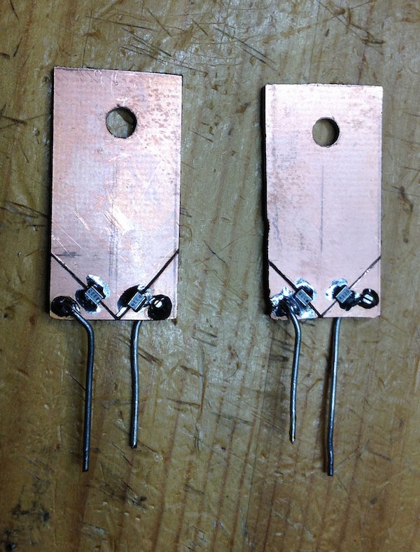

Quad resistors, also known as Quartet resistors or series/parallel resistors have some interesting properties. Starting with a description, a quad resistor replaces a single resistor with 4 resistors of the same value in a combined series/parallel package. In other words, 2 strings of 2 resistors in series and the 2 strings in parallel. That results in a resistor that has the same value as the single resistor, but 4x the power rating. Better than that, the theory says that the quad will have 12 dB less distortion than the single resistor.
Because the power rating is 4 times the single resistor, it is possible to use lower power rating resistors with better specs. In the case of R3, I have chosen to use Susumu KRL current sense resistors, specifically part number KRL2012E-M-R330-F-T5 for the 0R33 value used in evo A. This resistor is a foil resistor that is rated at 1W, 50 ppm/C, and should have very good current noise. Combining these into a Quad resistor will give us 4W power rating and, if we design the pcb properly, we should have a good opportunity for heat transfer.
In the picture, you can see my homemade version. A two sided copper clad board was cut into 15 x 30 mm parts. Near the bottom, I cut two narrow slices out of the copper and soldered the Susumu KRL over the gap. Note that this is a long side solder resistor. Two 1 mm holes were drilled and resistor lead were soldered in place. This was repeated on the back side of the board.
The resistors and leads are as close to the bottom as possible so that inductance is kept small. The height of the board is mainly to give surface area for heat transfer and it works pretty well. There is also a hole near the top so that a heat sink can be attached for additional heat transfer. As it sits here, the pcb runs at between 40 and 45 deg C without additional heat sinks. Of course, the ideal would be to have small pcb made professionally with a gold wash and no solder mask to get in the way of heat transfer.

This is the second project where I have tried Quads and I found them very worthwhile in both cases. The other project was a 15k Quad for the Impasse pre, so that was a thin metal film power SMD, different than the KRL. From that experience, I can say that the Quad approach is important in the sound quality improvement. That said, the KRL is a very nice design for our R3 situation. I researched a bit further and found that Susumu has a design for higher power KRL but will only make them on special order of 5000 or more.
Recycling the Caddock heat sink would be a good idea. I am running my FE with medium sensitivity, 4 Ohm speakers which means more current and heat in R3 than an 8 Ohm speaker. Driving them pretty hard, I am seeing 15 to 20 degree C above ambient on the Quads without heat sink. That is acceptable, but I would like to reduce that further.
If you decide to try it, a two side, 35 um copper clad board is relatively inexpensive and making the cuts for the resistors is easy. I am considering getting some pcb's made in small quantities because the next project to try Quads requires 12 Quads. I mention this only because I have found I can get the pcb for $1.16 each in 70 um copper (good for heat transfer). That gives you a cost reference for the future.

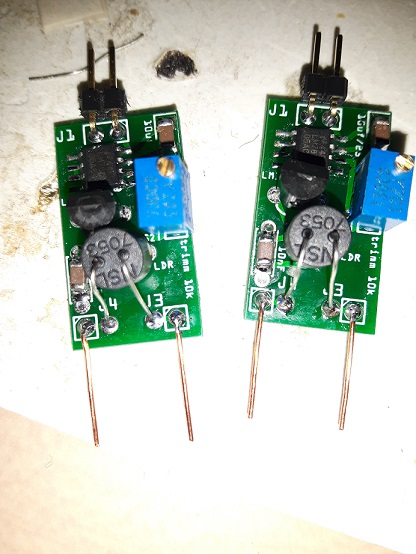

Recently I placed on the R12 an LDR with fixed value (3k3) with a small circuit with a CCS (LM334 + 10K Trimmer) and an external supply that delivers regulated 5V. This personal variation allowed me a tangible increase in listening performance. The fixed LDR replaced a Z-foil.
I am going to place the Z-foils of 47K and 22K (R5, R6, R8, R9) on the pump.
Now that is interesting. That's the first time I have heard of an LDR in a fixed value.
Jac
JacNow that is interesting. That's the first time I have heard of an LDR in a fixed value.
Jac
this is my minipcb freely taken from a proposed circuit found on the web.
I believe the author is just udailey.
I used a 7805 in this version + CCS (LM334) + 10K trimmer. Afterwards I removed the 7805 (I did a supply shunt with a TL431 aside) and then I reduced the minipcb size.
The performance is fantastic.
![LDR fixed.jpg LDR fixed.jpg](https://www.diyaudio.com/community/data/attachments/605/605200-ac1a8ae13a41274518f272a5411f8e5f.jpg)
PS: I also use the LDR in my Lightspeed attenuator (homemade)
