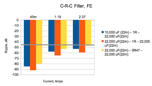

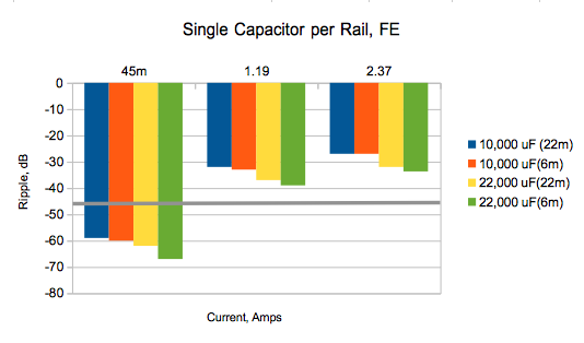

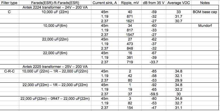

Let me start with the usual caveat. I am often wrong. Please feel free to correct what I am writing or comment.
I have heard about a few people trying larger power supply capacitors (C101, C201) and hearing sound quality improvements. That got me to wondering if it made sense. Since we are flirting with a noise floor in the -120 to -130 dB range, it is possible that power supply ripple could be adding to the noise. The LM3886 datasheet specifies PSRR at 85 dB minimum and 105 to 120 typical, depending on source voltages. Using 85 dB as the worst case, the ripple coming into the LM3886 would need to be -45 dB or lower to be below -130 dB.
I pulled up the Duncan PSU Designer II program and played with some numbers. I used the specs from an Antek 2224 toroidal transformer (24V, 200 VA) and I picked three current sinks to better understand the performance range. For the bottom, I used 45mA which is basically no signal and represents the quietest passages. Using Mauro's 45W into 8 Ohms, I used the 2.37A required for that spec as full power. Of course, most music isn't full power, so I picked about half (1.19A) to represent “normal” music.
For reservoir caps, I chose 10,000 uF from the BOM and 22,000 uF as a natural size about double the standard size.
ESR of a cap is important for two reasons. It has a minor effect on ripple, but it also affects how quickly a cap can react to a transient requirement from the amp. The Vishay base cap in the BOM has a ESR of 22 mOhms. The alternate premium cap (Nichicon LKG) doesn't spec ESR, but I am estimating it at 19 mOhms from the tan delta information. The Mundorf is the expensive option, although far more reasonable than it was 5 years ago. Mundorf doesn't currently publish the ESR spec, but I have an old datasheet from 2012 that uses 6 mOhms for our size.
I ran simulations of the Vishay and Mundorf caps in both sizes. I also ran the Nichicon, but it wasn't very different from the Vishay in this simulation. From the graph, you can see that it isn't easy getting to -45 dB, but it may be OK as long as you reach that level at the lowest current level, that is, a quiet passage in the music.
I also ran some combinations using a C-R-C filter. Of course, the resistor in the filter will reduce rail voltage at higher current levels. To compensate for this, these simulations are run using the Antek 2225 (25V, 200 VA). I would have preferred to go up to 26 V, but the standard steps at Antek are 24, 25, and 28V. Using this transformer, I was able to keep rail voltage within ½ volt of the current system, even at full power. Actually, at the mid current flow (1.19A), rail voltage is a little higher than the current system. As you can see, using a C-R-C filter, it is possible to meet the -45 dB target at all power levels. Also note, that I did this using the lower cost Vishay cap. That may have some negative effects due to it's higher ESR on rail voltage transients, so it may turn out useful to have a premium cap closest to the rails.
Now, you say this all very interesting, but how can you do a CRC filter on the existing boards? Actually, it is possible. Just build a small proto board with the diodes, first capacitor, and resistor. Then solder the output of the proto board into the diode holes that connect directly to the rails with the second capacitor mounted in the normal place on the board. I like the idea of having the second cap on the board and a short path to the LM3886.
This kind of separate board offers some interesting options. For example, you can make a low ESR cap out of paralleling several higher ESR caps. Since their resistance is in parallel, the combined caps ESR combines like parallel resistors. 3 of the Vishay 10,000 uF caps would have 30,000 uF and an ESR of 7mOhms.
Another alternative would be to change the board design to accept a CRC filter, but that would mean a pretty large increase in size.
Jac
