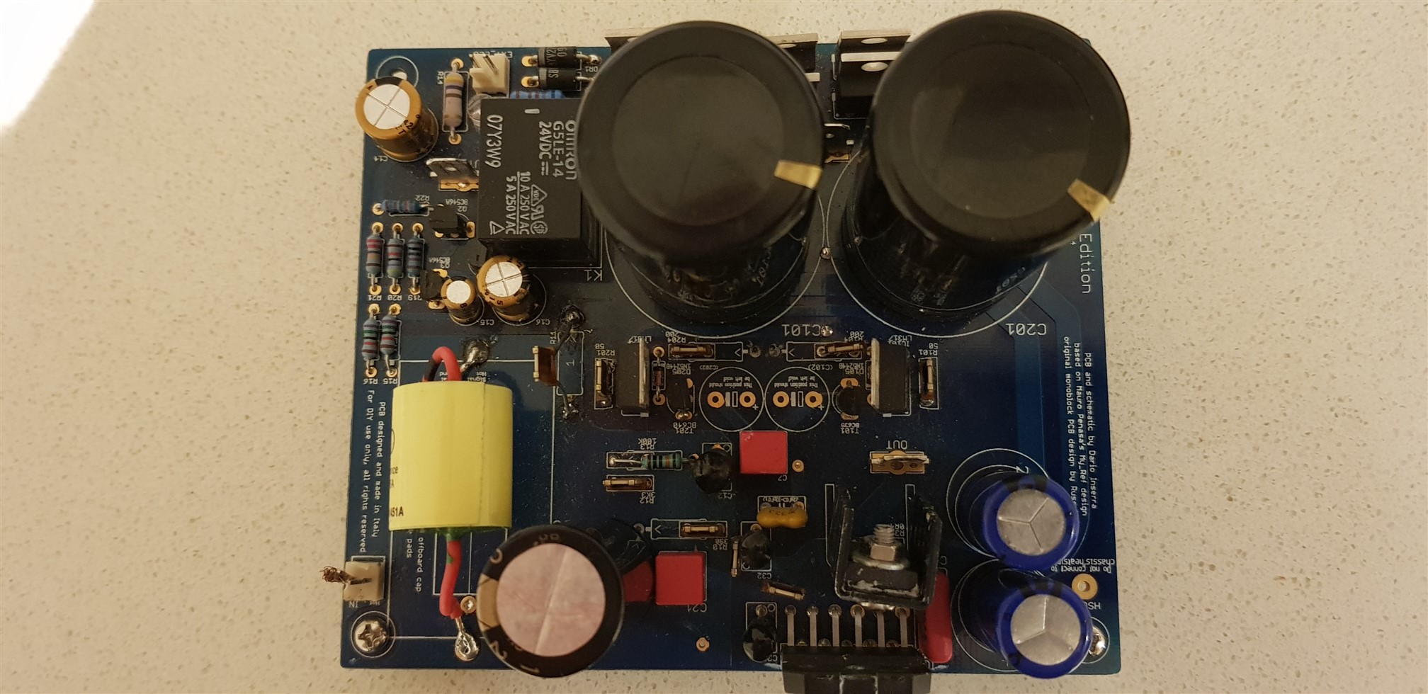

hi here is my pcb
v1.2 as in my archive.
Wow... you have more Bulk metal foils than me.
The input caps... what are they? Auricaps?
And C1, C2?
Did you specs for your loudspeakers?
Did you try your amp with different loudspekers?
Can you describe the differences between MUR820 and HFA08TB60? I don't know how a tube rectifier sounds...![]()
Not easy to do... we go into personal perceptions here, very difficult to find the right words. I don't think the difference in sound is measurable.
Tube rectifiers, in my experience, give a full and warm body to sound; in addition, everything sounds more similar to real sounds, expecially natural/organic sources (human voices, acoustic instruments, etc...). But that's not true for every tube rectifier, just the best sound this way.
Anyway, hexfred diodes sound similar, so by evidence that particular sound is not due to tube technology... then i don't know what exactly is involved here.
The word 'struggling' doesn't sound correct to me referred to the My_Ref FE... I can agree that a better opamp could increase speed and liveness but my My_Ref FE, in my setup, never seemed to 'struggle' at anything...
We're talking in relative terms here. Sure a standard My_ref is not "struggling" to output music when compared to a sub 1000 USD tube amp, except very few that shine in this; but when compared to a good class D power amp or a much higher cost tube/ss power amp i hear a "slower" music, less "push", as if My_ref found it hard to let the music out. A bit hampered. This is much worse if you don't use a good preamp, something like low watt SE power amps.
OPA827 gives My_ref a much easier and clear sound, but you have to test it to understand the difference, as in absolute terms standard My_ref is not so "struggling", but it is in relative terms.
That's why i told Peter he probably doesn't have higher expectations, but different expectations instead, i think he was envisioning a different sound character because he identified My_ref as a Gainclone (that it is, but doesn't sound like). Harmonious and equilibrate sound is not easy to value initially.
last one
Uhmmm... Many z-foils but cheap coupling caps...
Input coupling caps are really important for SQ, maybe one of the most important component. If your preamp has output coupling caps, then you can try bypassing My_ref imput ones, that would be easy and cheap.
If you can't, then you need better caps - nothing worse than Mundorf Supremes IMHO.

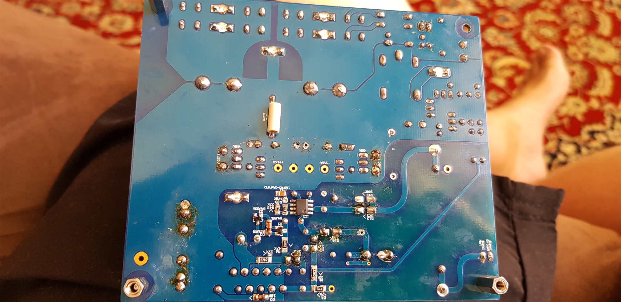

A question of curiosity. On the bottom of your board, there is a white cylinder at J1. Am I assuming correctly that the white is a length of shrink tube or equivalent for insulation?
Jac
I like using Peerless woofers too. The trouble is that their 12" line varies quite a bit in SPL. Some models are as high as 90 dB/W and I've seen other down around 84 dB/W. So depending on which you used, there could be quite a difference volume setting. All of these My_Ref designs are at about 30 dB gain which is slightly higher gain than the old chipamps.com (BrianGT) gainclone. Which gainclone were you referring to? If your standard gainclone needs significantly lower volume setting than the FE, then there may be a problem as Dario suggests. First place to double check would be the values of R7 (12k) and R10 (390R).
