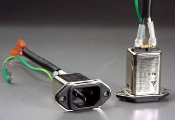

What are your reasons for using or not using EMI filters? Are there times when it makes sense? I am not looking to create an ugly argument here, just trying to understand the choice.
My reason for considering it is that I live near the end of a mains power branch and my mains power is somewhat dirty. I see noise on the mains from DC to as high as my scope can measure (~10 MHz). An EMI filter won't do anything about DC, but I'm curious about the rest.
Jac
Last question: in my amp I use an IEC with EMI filter, it's OK or should EMI filter avoided in power amp like my_ref?
No EMI filter, ti prego..![]()

I use these on all my builds with no ill effect.

Thanks to Troy and anyone else taking time to read my post. After thinking about it, this system uses a surge protector with mild linear high frequency filtering. So I really don't need to add a second EMI filter. And I didn't hear any degradation when I added the surge protector, so I don't think I am losing anything.

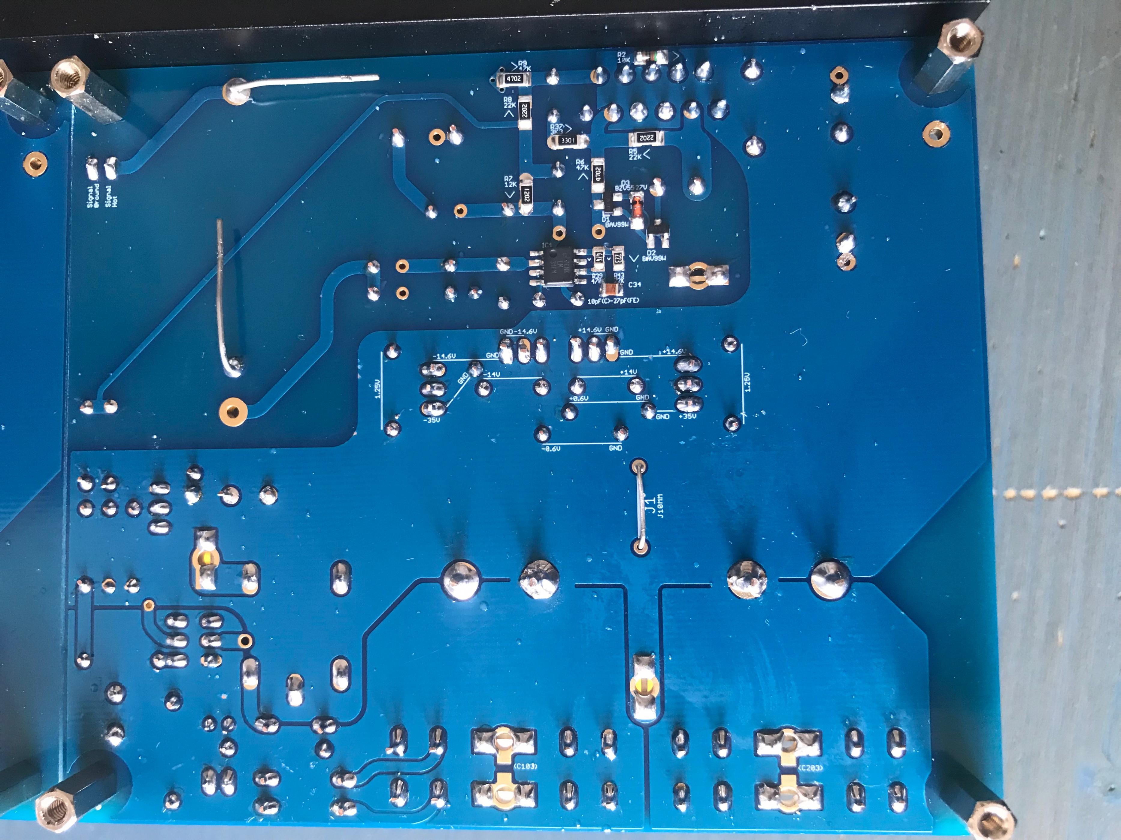

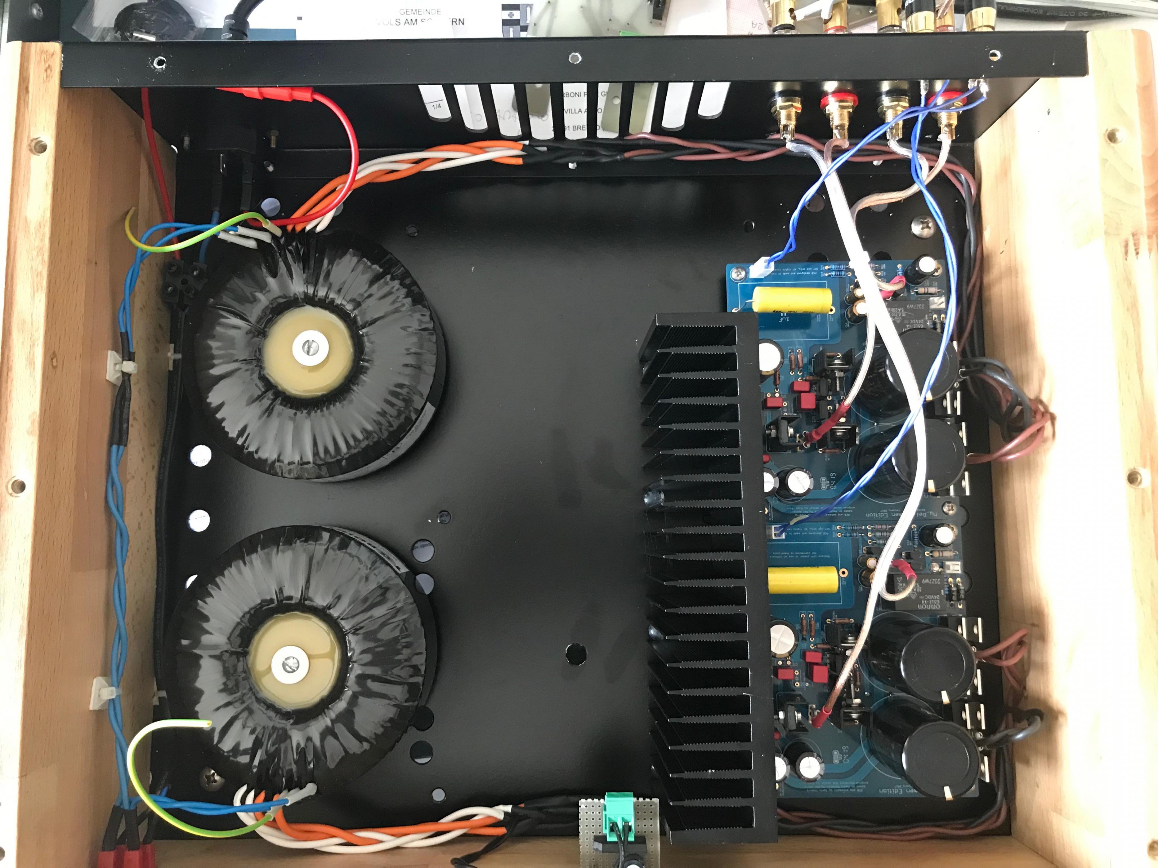

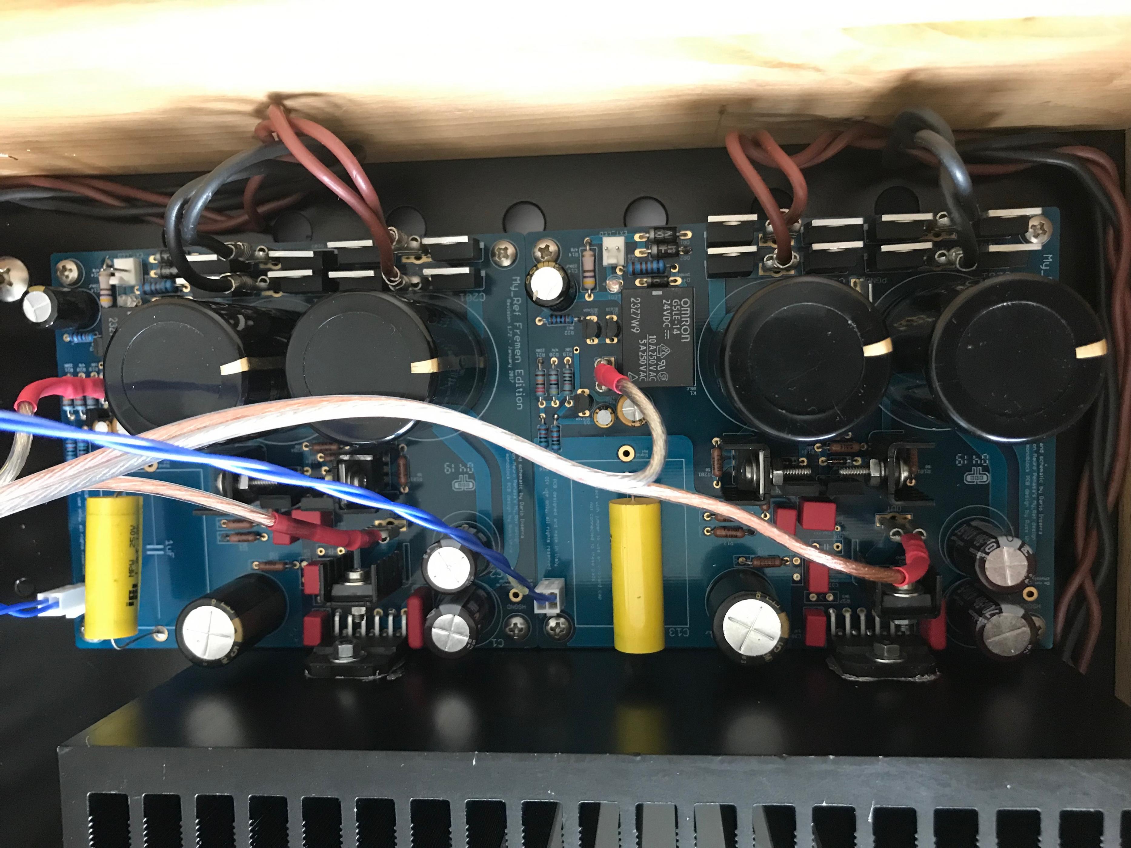

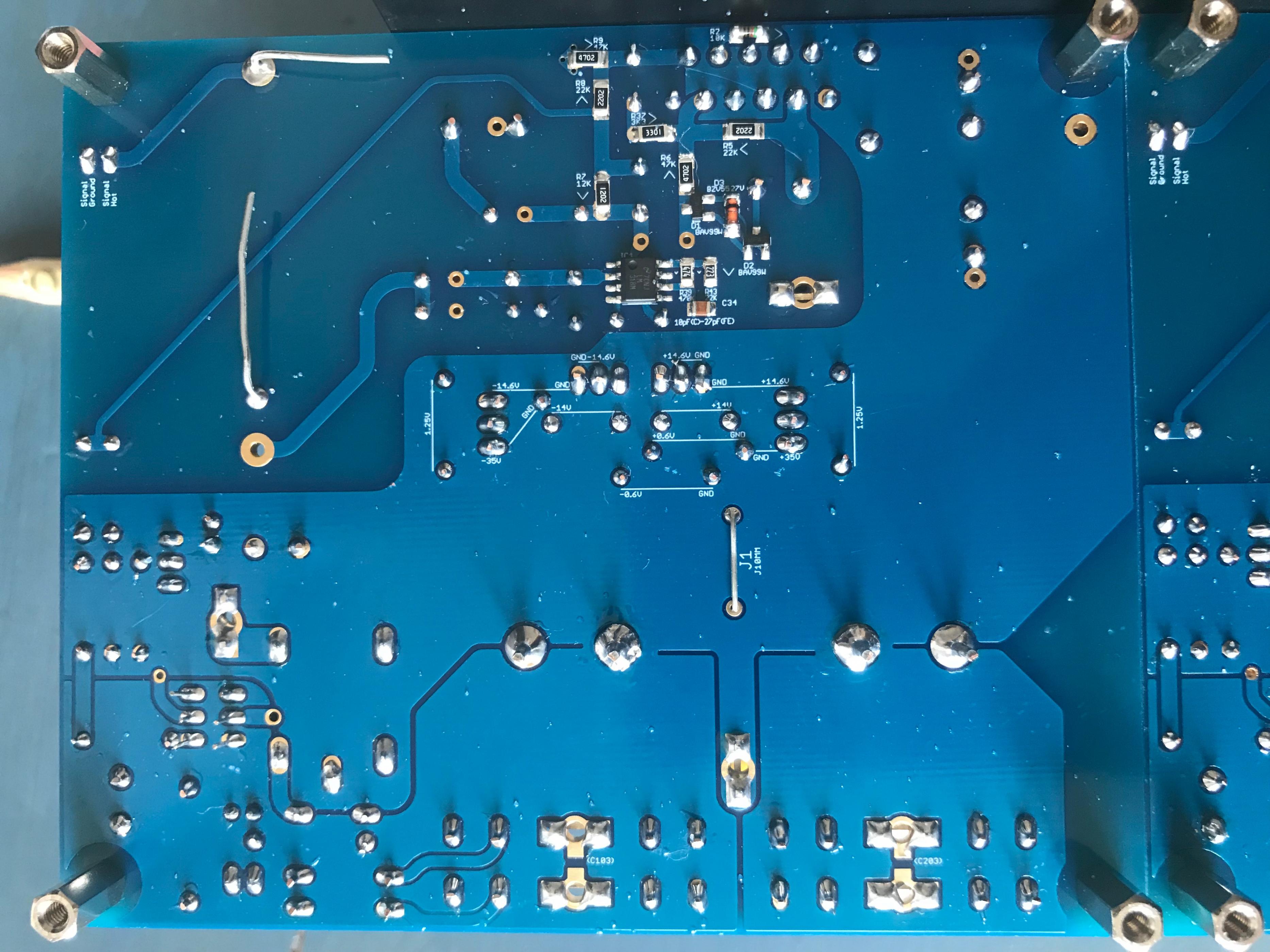

Hi Guys,
here is another builder of My_ref looking for advices.
After power on, relays click and LED is on (1,25A fuse tend to blow most of the times so I went up to 2.5A).
TAs are two Toroidy 25+25V 200VA.
After some hours of burn in, DC offset is around 40mV on one channel and 5mV on the other. After 10 min. the first channel goes down to less than 20mV. DC offset reading is the same both with inputs shorted and open.
Voltage readings on both boards are correct, generally slightly lower than those marked on the boards.
R11 is OK, not open.
PGND not connected yet, boards floating.
The problem? I have no sound at all. If I twiddle with the inputs I can hear crackles.

The pictures show a tidy build. The offset and relay indicate the issue is front end related.
The offset would not be correct if it was LM3886 or feedback loop related.
I recommend you check continuities and resistance values between the input around the LM318. I suspect an open and that is why the signal is not getting through.
Shorting the input should make a small difference unless there is an open or short already.
Sorry for the delay.
Btw, assume you have clipped the leads on the input cap.
I use a transformer instead of the input capacitor. The capacitor does not have to be there, try connecting the signal to both sides of the input cap to see if this helps your troubleshooting.

Argh.. This confirm I'm stupid enough... I connected the input cap exactly to the pad marked with "signal ground" where a writing on the board warns not to connect the cap there....
Thanks Panelhead, you opened my eyes!
Now I have a very nice sound.. and some optimization work ahead to do.
