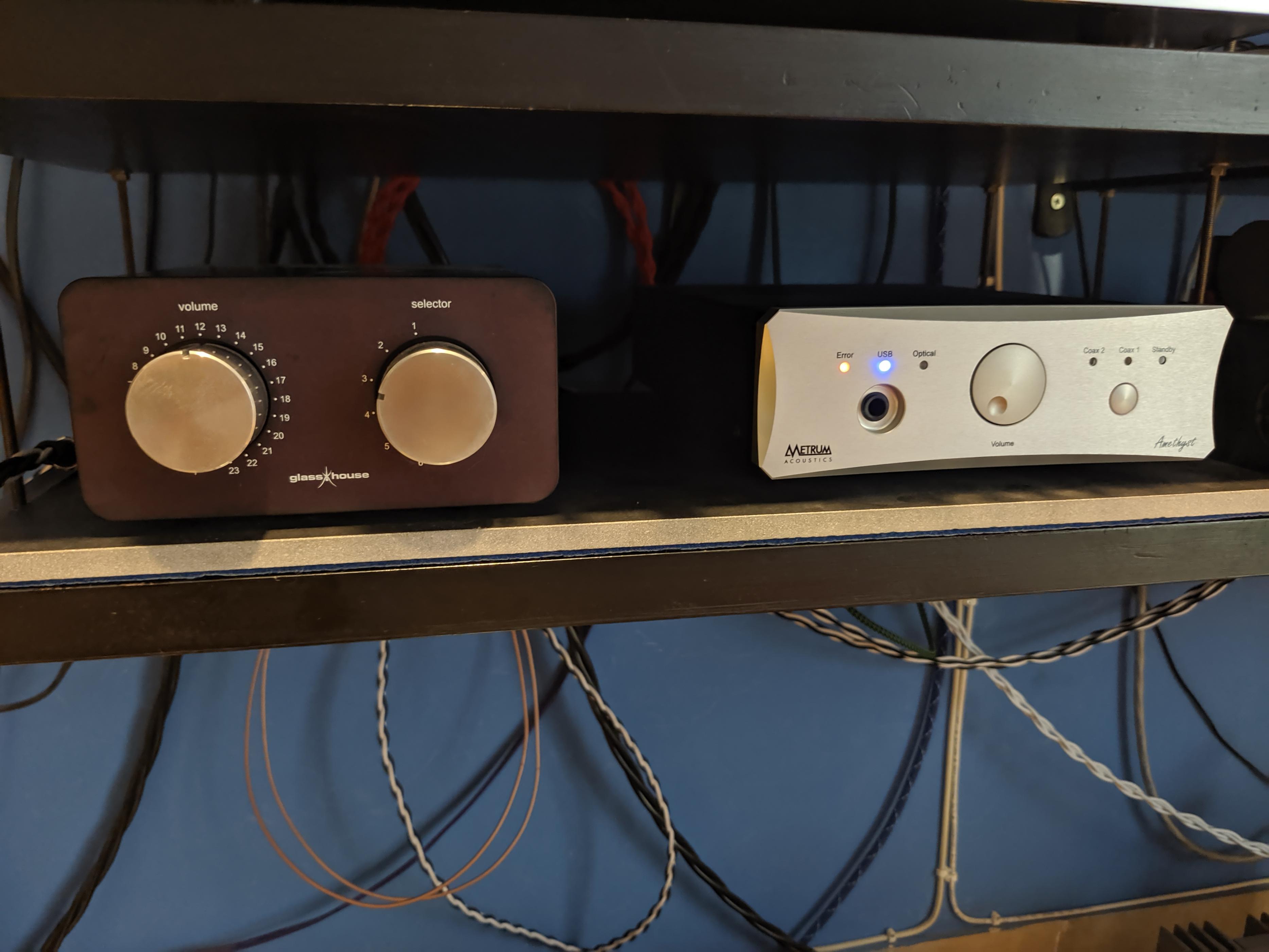

In my stereo system, all the sources (dac, tuner, pre-phono) are connected to a passive TVC transformer from Glasshouse and this is connected to My_Ref Evo A.
In this case, passing the source signal through the passive pre transformers, is DC blocked? Could I safely remove C13?

OK, I really am not an expert on this, but I will try a possible explanation. I hope that others with more knowledge will chip in and improve our knowledge.
My understanding is that, for the small amounts of DC in the normal signal path, the TVC does a great job of isolating DC and can effectively replace C13. Sowter's comment about possibly needing a DC blocking cap to protect the transformer windings probably refers to what happens to a transformer, especially a toroidal transformer, when a higher level of DC is introduced.
When DC is fed into a transformer, there is no inductive reactance because the DC is a constant current. That means that the low resistance of the winding are the only thing resisting the current. The result is high current flow that can damage the winding if the DC voltage is high enough.
If we are feeding the transformer with DC + music (AC signal), the DC causes an offset that can saturate the core for a partial cycle. That can result in noise from the transformer itself. Actually, the worst condition is when the system is on, but there is no AC input. Under this condition, even a small amount of DC will cause core saturation.
The sensitivity to saturation is a function of transformer design. EI transformers can be less sensitive, depending on the gap between the core elements, the E and the I. Toroids, among others, have continuous cores that can't leak off the saturation flux and are easier to saturate.
In sum, the safest way is to keep a DC blocking capacitor, plus your TVC. That said, assuming low DC from your source, using the TVC without a DC blocking cap should provide good DC isolation for normal conditions. Its only under a failure that you would risk damaging components.

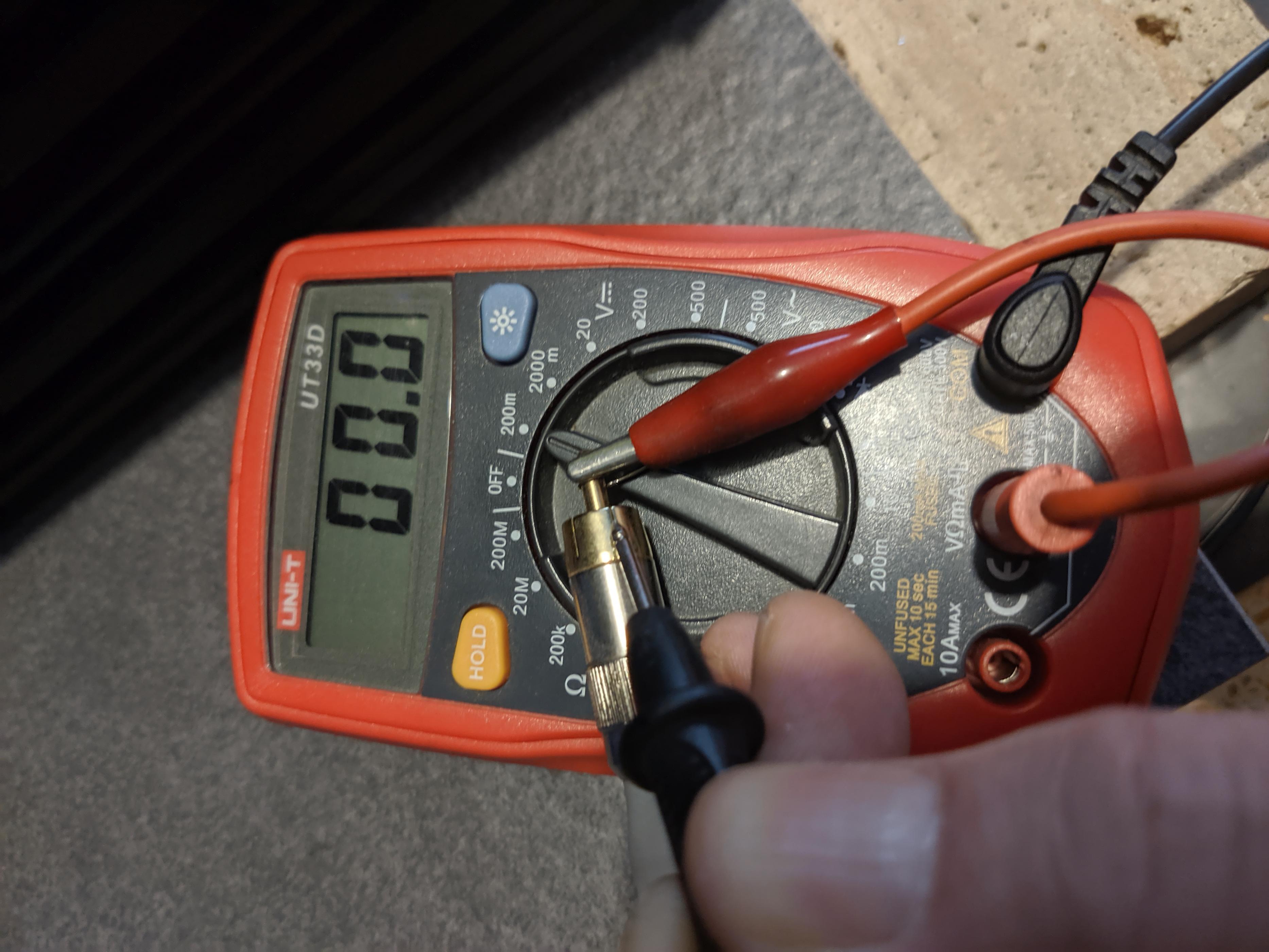

Thanks for explanations. Glasshouse TVC passive preamp employs transformers, not autoformers. These transformers are not toroidal but EI. I suppose they were similar to Promitheus Audio trafos.
Do you can explain how to measure DC? Can I use a simple voltmeter to read the signal output from preamp?
If for security reasons I had to replace C13, in order to reduce colorations, could I use a value less than 1uF?
I have some CDE 940c 3000vdc capacitors 0.01uF and I could try them. In the range of nanofarads I can find better quality and technology capacitors within the appropriate budget and size, I think.
Ciao
Giacinto
That's right. It should be very small because the amplifier increases it by 30 to 1. As I understand your TVC, you won't find any DC at the output of the TVC because the transformer won't pass DC.
A smaller value at C13 will degrade the bass. C13 and R13 form a high pass filter that roll off the bass at about 1.6 Hz (f= 1/2piRC). Mauro chose this to be at a low frequency so that the bass doesn't see much phase change due to the filter.
If you were to use a 0.01 uF at C13, the bass would roll off at about 160 Hz.
Jac
I made a measure, I hope with the right method.
Dac turned on without a music signal connected to the preamplifier. Half-way volume. Voltmeter connected, as shown in the attached image, to the connection cables for the power amplifier (obviously not connected to the power amp).
Measured on both channels 0.00 millivolts, as expected.
If I have not the wrong method, I am happy with this confirmation and I will enjoy the My_Ref without C13.
