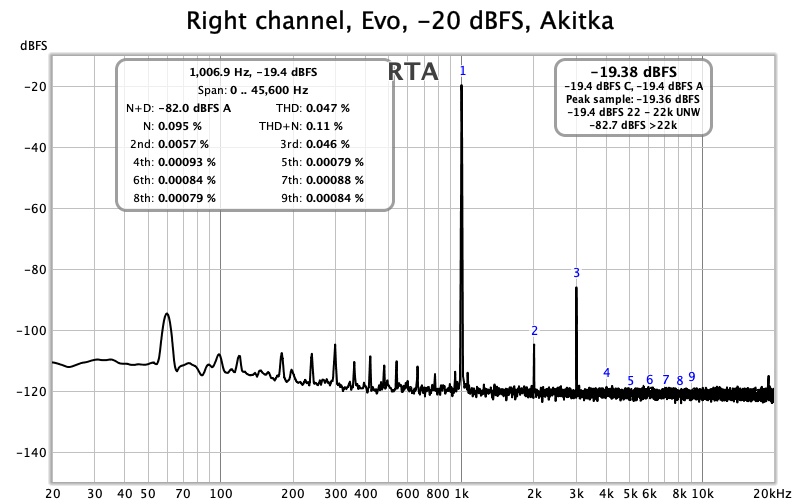

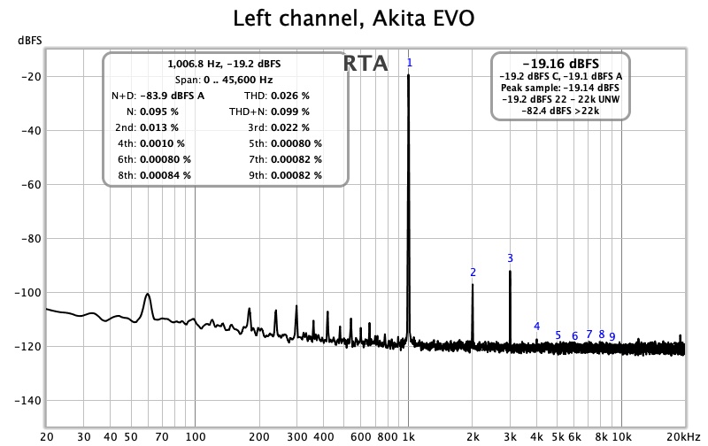

A real Evo measurement
Ran some sweeps with REW. Maybe it is all the years in the attic have baked it. But my Evo, Rev A does not measure as well as the FE.
It is capacitor coupled input, and not transformer like the Fremen.

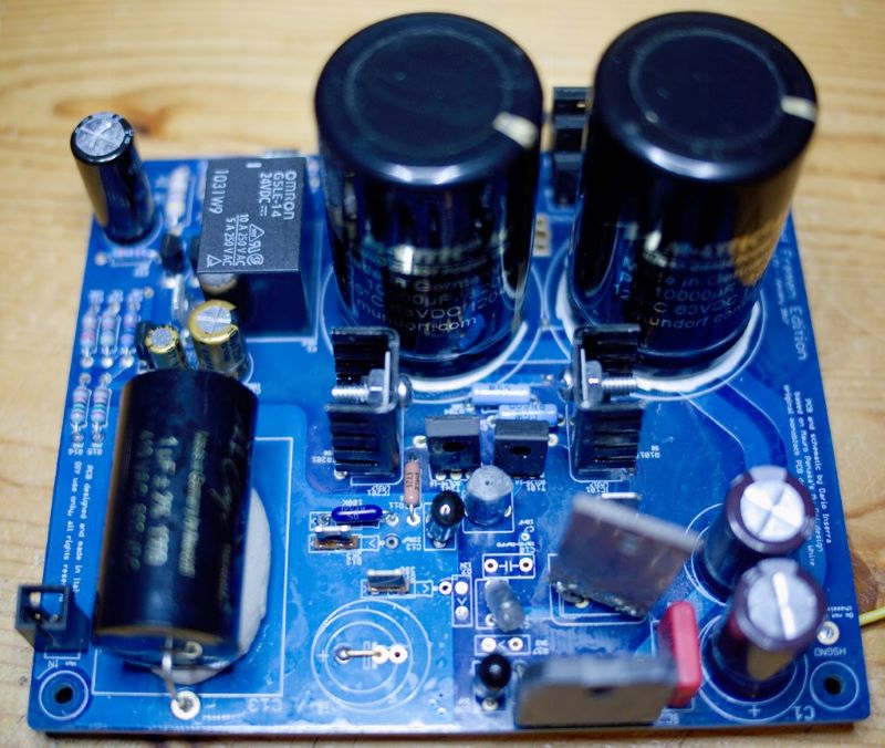

I started this project in 2012 with Fremen Edition RC boards. I planned on trying different components, so I mounted the amp on a piece of scrap plywood and placed it in my living room. Alas, all these years later it is still sitting in my living room on that ugly plywood. I think it is finally time to put the amp in an enclosure and call this project done.
Of course, there were other projects, my LXmini powered by 4 FE's, a couple of tube pre-amps, a Pass F4. In the interim, the plywood FE was upgraded to the V1.5 and later boards and BOM (a nice improvement).
In the last year or so, I have been playing with jfet opamps based on George's work (another nice improvement). This year, I built a pair of r1.72 boards with the new OPA828 opamp and some component optimizing. The last few months, I have been listening and smiling a lot. This is the best sounding amp I have ever heard. It is time to call this project done. Of course, the enclosure is taking longer than I hoped, so I thought I should share the board build, even though it is still sitting on that ugly plywood.
OPA828
George suggested this opamp as he was playing with them in an Evo amp. Per the TI datasheet, “The OPA828 JFET is the next generation OPA627 and OPA827 operational amplifier (opamp), combining high speed with high DC precision and AC performance.”
Compared to the LM318, the OPA828 (mostly standard BOM) moves the image a bit closer with better instrument separation and a deeper sound stage. The OPA828 maintains the nice harmonics from the LM318, but gives clean, natural decay. Overall, I would describe the FE with OPA828 as transparent.

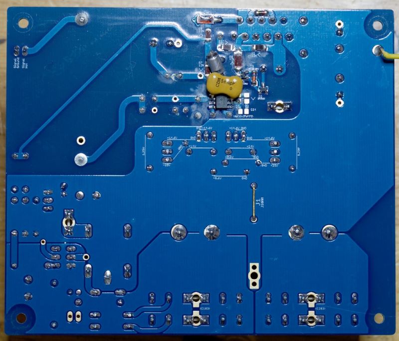

Build Issues
Stability – The other jfet opamps (OPA827. AD4627, and OPA627) are normally stable but will, on occasion, require a 4.7 or 5 pF silver mica cap across pins 2 and 6 of the opamp to restore stability. The OPA828 is a very fast opamp and the silver mica cap is a necessary starting point. However, it still requires even more help to keep it stable. George determined that C32 needs to change from 150 pF to 68 pF which we both confirmed resulted in a stable FE OPA828.
For that 68 pF cap, I tried silver mica, Corning glass CY30, and Rohm polystyrene caps at C32 (68 pF). Of these, the polystyrene cap was by far the smoothest and clearest sounding.
DC Offset
Each of my jfet opamp builds had more DC offset that I wanted. In the worst case, I had about 700 mV DC offset. This problem had me stumped for a while until George mentioned that he didn't have any DC offset problems but only used “no-clean” solder flux. I had been using Kester lead solder with #44 rosin flux.
I removed the opamp and several surrounding SMD resistors, cleaned them and the board carefully, and soldered them again with Chipquik SMD291 No Clean Tack Flux and Mundorf Msolder SilverGold with no clean flux. My new DC offset was 2 mV.
From this single experiment, I can't conclusively say that the flux was my problem, but it is a strong enough case that I recommend you use no clean flux on all SMD components. It appears that, no matter how completely you clean up after soldering, there remains some flux under the SMD components that may cause DC offset.

The Caddock in R3 has been replaced with my homemade quartet resistor using Susumu KRL foil resistors.
I replaced most of the signal path resistors with Texas Components Z foil resistors. The resistors are R5, R6, R7, R8, R9, R10, R12, and R37. Most of these are SMD versions (ASM2575).
Those with sharp eyes will notice that a few of these SMD resistors look big compared to the others. Texas Components doesn't make 47k resistors in the smaller 0805 or 1206 sizes. These 47k resistors are 2010 size which really doesn't fit the pads on the boards. In order to use these, I carefully scraped the solder resist from the trace effectively extending the pad. That gave me the room to solder the bigger 2010 resistors to the appropriate place in the circuit.
Capacitors
In addition to the changes at C32, I am lucky enough to have some of the old stock ERO KP1834 for C7.
I tried several caps at C13. The Mundorf Supreme from the BOM is the most neutral and my favorite for this build. If I was braver, I might have removed C13 and gone DC coupled, but the difference in sound with the Supreme was very small, so elected the safer path.
One reason for going to a jfet opamp is the possibility to remove C9. Although the jfet with C9 in place might be an improvement over the LM318, I think a significant part of the value of the jfet opamps is removing C9.
Summary
In the end, I am really happy with the sound of this amp. The sound stage is deeper and the instruments rendered more realistically than any I have ever heard. Hats off to George for researching this tuning path and a huge thank you for all of the help. Now I have to finish off that enclosure.
