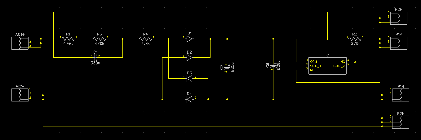

Yes, and no.
With more than 300VA you would need a soft start circuit to use the appropriate fuse.
What blows fuses is transformers' inrush current so, without using soft start you will need an higher rating but have a small added risk.
BTW 1.24A is too much conservative, in fact for my 2x120VA I'm using 1.6A fuses (which will be the new recommended value for up to 2x160VA)
In you case you will need 2A ones or a soft start circuit.

Even if it is clear which are actors involved here, I have some doubts about the scope of the fuse.
My toroid has a built in fuse for temperature protection. So I think that the scope of another fuse is to protect the lm3886.
But the ampli is able to drain (in my case 54W on 6ohm) max 3A for each channel. It means a max current on the primary of 1,25A. If I put a fuse of 2A, the protection is unuseful for LM3886. Isn't it?
Probably as suggested by Dario, the best solution is a soft start circuit.

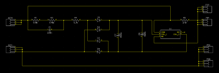

Interesting. I've found I have a pair of 250VA... A grand total of 500VA if I decide to opt for them (hand built ones from an Italian factory). Should I use a soft start too, u think? I have a pair of these , one still to be built.
Instead to use something ready, I preferred to project it by myself. So I dimensioned all components for the specific use case.
I realized the attached circuit. It limits the current on the primary side to max 1,25A. It has already 2 output for 2 trafos.

It is very simple... Yesterday I buyed components on mouser. Next week end I will test it by practice.
if you want I can share also the PCB.
