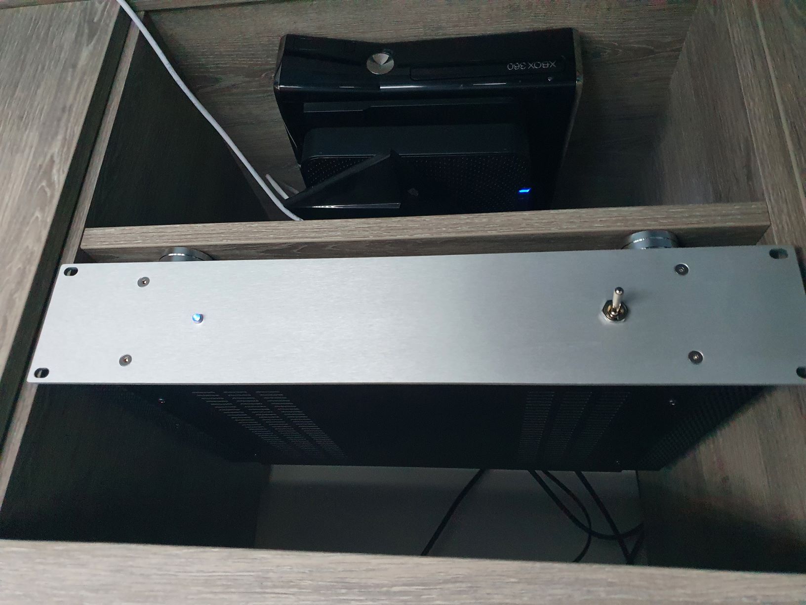

- Because I thought it would look nice I put a flip switch on the front pannel. I'm noticing however that upon turning the amplifier off, I alway get a small shock. I can confirm that the button I grounded via the chasis. There are no shorts from the Live wire to ground. Does this mean this a discharge of static electricity? Rather annoying. Maybe it's best that I switch to a different type of on/off switch?
- The external LED is not powering on. I pressume the voltage is too low (1.7V). I pressume that I can change the value of R23 accomedate a higher voltage?

The way to think about LEDs is current, not voltage. You will want about 2 mA through an LED for good illumination and long life. Select your resistor so that the source voltage - 1.7V gives the current you want.
You don't want to connect the 2 FE board power supplies together, so the LEDs should be on separate circuits. I have often just used one channel with an external LED as a power indicator and soldered the other channel LED to its on-board location.
On the other hand, I built a 4 channel where I brought all 4 LEDs to the front panel in a diamond pattern.
Just realises that 1.7V time two is 3.4V, so the design purpose is probably to add put both external Led connector in parallel.
As Jac already pointed out...no it isn't.
Just use one as front panel power indicator or bring both to the front panel.
Thanks. Fixed it. Put two different color LED's in parallel on a breadboard (3.3V DC). When blue are and red are put in parallel only the red one turns on. Removed the red led from the board and attached the external one. Added a resistor to dim the LED. Works great now.

I saw in the previous pic that PGND is connected to the safety ground, it's not supposed to be, not directly, eventually you can use a ground loop breaker as per tutorial.

Hi there! May I ask what box is that? I'd like to move to a smaller one, I'm running cabriolet but I have a pair of HiFi2000 SLIM LINE 02/350 that are way too big...
Enclosure: Dissipante 02/300B 2U 4mm ARGENTO
Switch: 1 Pole 2 Positions Aviation Type Toggle Switch ON-OFF 250V 15A - Audiophonics
Led: LED Support + Blue LED - Audiophonics
