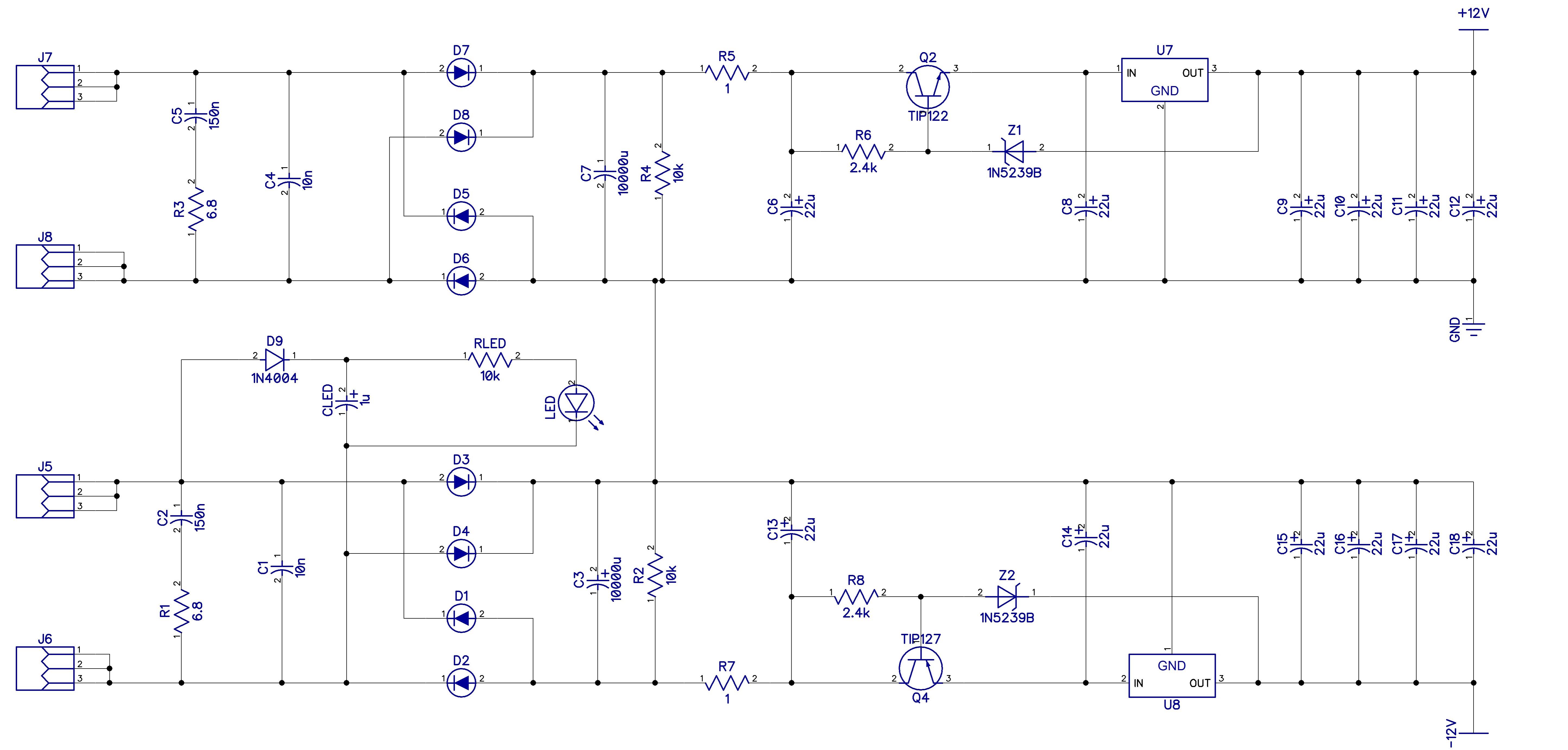

Thanks to you all. I spent the past hours going over the reference voltages, shorts to ground, resistor values. I measured both opamp input voltage delta's, but couldn't find anything out of the ordinary. Next, I took a Sony speaker and behold it plays wonderfull. So it must have been the speaker! ... but wait, I re-atached the audioengine speaker and this one is now also playing perfectly.
The polarity of the input was correct, but I did re-attach the wires. Could a poor contact to the input ground have been the cause? It is only thing I changed. But if that is the case, wouldn't there rather have been no sound at all?
Tomorrow I'll start with soldering board n°2.
VAC AC1|NAC1 is 26V
VAC AC2|NAC2 is 26V
VAC NAC1|NAC2 is 6V
With my basic knowledge I was expecting NAC1|NAC2 to measure at 0V. But I think that was a wrong interpretations of the circuit.

I did not understand the line input AC value, too.. 6V AC?! Should be 24-25-26-27V AC RMS, even, depending on the transformer
VAC AC1|NAC1 is 26V
VAC AC2|NAC2 is 26V
VAC NAC1|NAC2 is 6V
Try to generate a 100mV AC RMS, 370Hz signal on the input, and read the output, unloaded. Should be ~ 3,1V AC RMS.
370 is not a multiple of 50, and still low enough for the meter to be correctly revealed..

Hi all
I'm evaluating the possibility to add a preamp with negative gain between my DAC based on sa9227 + pcm5102a and My_Ref.
My idea is to use this one
Balanced Volume Controller / Line Stage
with some asjustments.
I have enough space in the ampli case also for the preamp board, but not for another trafo. The idea to use the same case is especially to avoid to many connections between DAC - preamp - ampli.
Both channel of preamp needs about 120mA. So I'm thinking to use +14/-14V from one board of My_Ref. Is it possible to extract 2 pin for this? Is there some drawback?
In alternative I could use the output of one trafo, but I have some doubt about the parallel connection. Wdyt?

Alas, I have experience with this. You will need to have a separate power supply for the pre-amp. The onboard +/-14V regulated supply has some headroom, but not 120mA. I found that powering 2 opamps, maybe 20 mA total, would cause stability problems depending on the opamps used.
I'm not completely clear on your trafo idea. The intended trafo layout is one, dual secondary trafo for each channel (mono block). It has proved OK to use a single, dual secondary trafo with the AC+ in parallel to both channels and the AC- on the other secondary feeding both channels in parallel. In other words, the FE board uses a dual bridge psu, so you can't have one secondary powering AC+ and AC-.
Taking an additional parallel circuit from one of the secondaries to power the pre- might work, but I am uncomfortable doing it.
In my own case, I made up a separate power supply with a separate small trafo to power an additional circuit. Something like the link, that is small.

Let me explain better the idea about trafo. In my My_Ref I have 2 trafo, one for each channel. Each trafo has a secondary with 2x24V. So my idea is to connect one trafo to one My_Ref channel and to the preamp.
I know that it is not the best solution for the amply, but I just would avoid "too many connections" in the middle...
Unfortunately I have no space for another trafo in my box.

To restate your idea. On one trafo, one channel of the My_Ref and the pre would be in parallel. I hope someone with more knowledge will jump in here.
You need to use both secondaries for the My_Ref, one for AC+ and one for AC-. I think that means that you would need to have a dual bridge for the pre also. For example, assume that you hooked up the pre and AC+ in parallel on one secondary. The AC+ bridge dumps negative voltage to the My_Ref ground and only has positive voltages. So, you need a dual bridge for the pre, in parallel to the My_Ref to get positive and negative voltage for the pre.
Somebody help me out here. Am I thinking about this correctly?

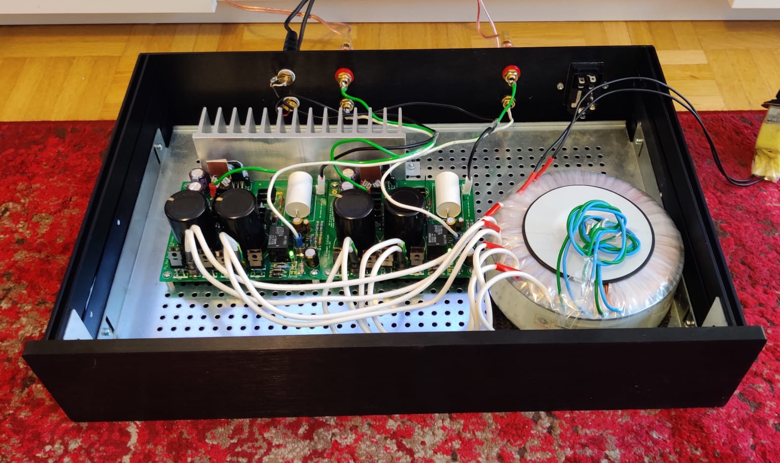

MyRef received a nice case today but i still have two issues to clarify.
1. can't find a power switch long enough to be installed into the 10mm thick panel and also to not need a larger hole than 10mm in diameter (i need to drill myself)
2. Right now the chassis is electrically floating, should i connect it to myref somehow? (heatsink pad maybe?)
Other than that nice sounding amp i have
Heatsink is not big enough and i plan to install a bigger one but as i'm listening to low levels is not getting very hot. The transformer is custom made on a low induction core, I believe is 350VA and is shielded. On a previous config i had 2 independent toroidals but this one sounds better.

I would avoid.
using PS from boards will result in problems, like Jac experienced in the past.
Using secondaries for two loads will possibly work but a lot of noise will affect both, impairing performance, I would prefer a cable and two cabinets...
No, PGND should be left floating or connected to chassis via a loop breaker (see build guide).
A 'floating' heatsink must be connected to safety ground or the HSGND pad on boards (only if each board has a dedicated heatsink).

Pgnd of each amp, to the chassis, possibly a short run.

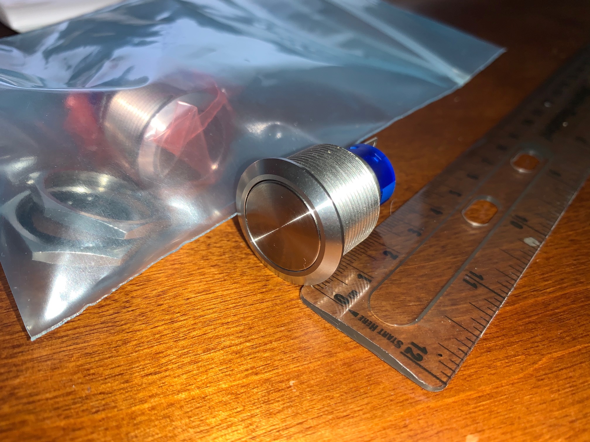

Take a look here: TE Connectivity 5 A Pushbutton Switches | Mouser
These are expensive ,but very nice , you might find similar for less money .
I didn't.... I could work with wood , but not with metal, so I remember I asked a friend to do it for me. These switches are 19mm wide( perfect size for a man finger, but Anti-Vandal series is available in sizes of 16, 19, 22 and 25mm ) drill bits that size are not cheap.
