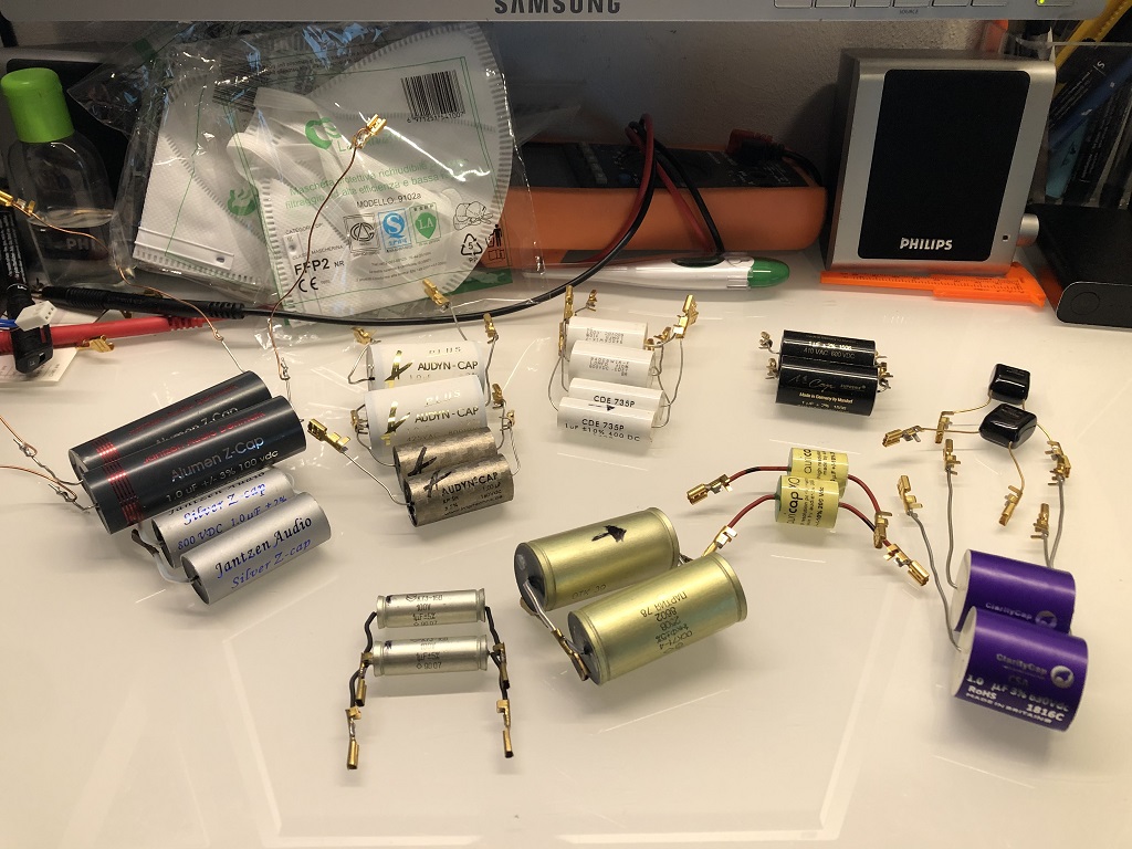

Hi Dario
How do you understand the direction of the segnal in a cup?
Have you never test mundor evo oil?I have the teac UD503 dac/pre and audioquest phanter dbs as rca cable
The mundorf evo oil sound very well ,smouth and fast like a good valve amplifier

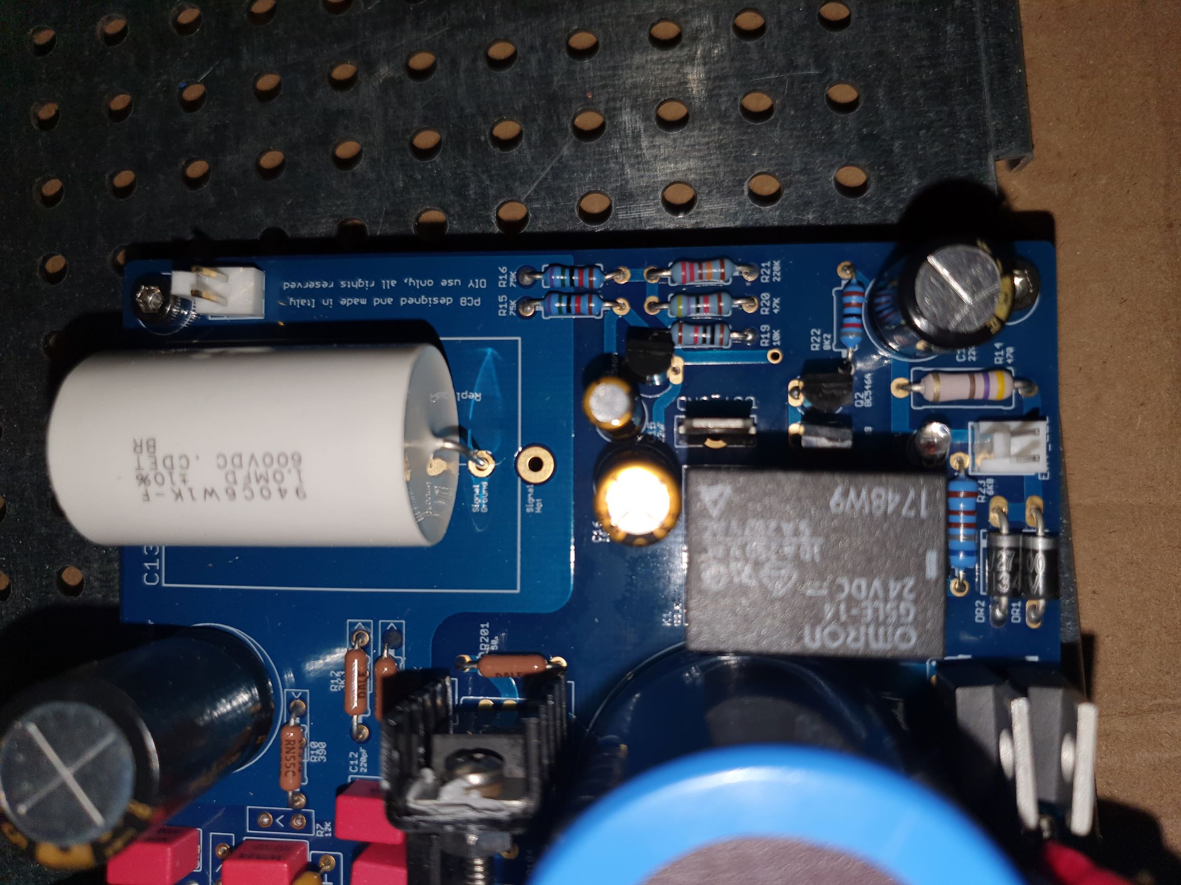

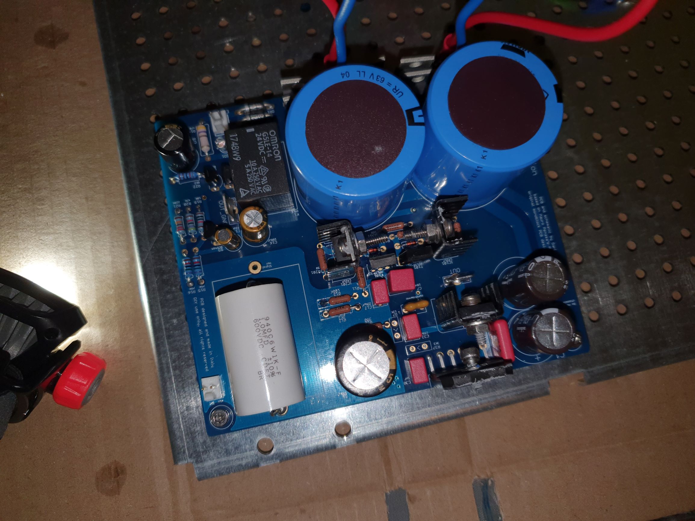

Troubleshooting steps
Hi!
Just hooked up the amplifier to the transformer: relay clicks, led turns on, measured all voltages mentioned in the build guide. They are spot on.
Attach signal-in, generate a 1kHZ sin wave, attach a test speaker ... completely silent ...
What steps do you take for troubleshooting the circuit?
Thanks!
Hi!
Thanks!
I would start from here:
The right direction is related to the outer foil of the capacitor which goes toward the input connector.How do you understand the direction of the segnal in a cup?
Some caps, like Jantzen Alumen or Auricaps have markings for it, other have no markings at all but it is consistent with text direction and finally some are 'random'.
The only (somewhat) reliable method to determine is using an oscilloscope (see on you tube, you'll find plenty of videos) or directly on boards using fastons.
The onboard method is:
- Mount the cap and touch it, you will hear a (very) faint hum.
- Mount the cap the other way, touch it again and compare the resulting hum.
- When hum is less that is the right direction.

You're welcome.Oops ... thanks!!
Let us know if fixing it solves your problem.

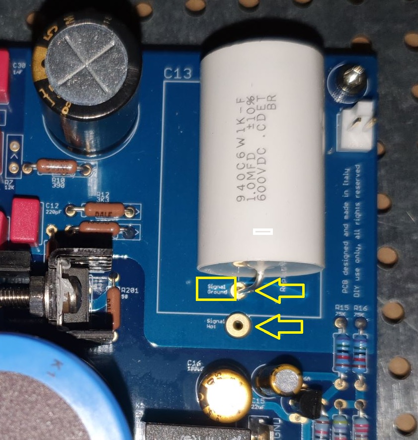

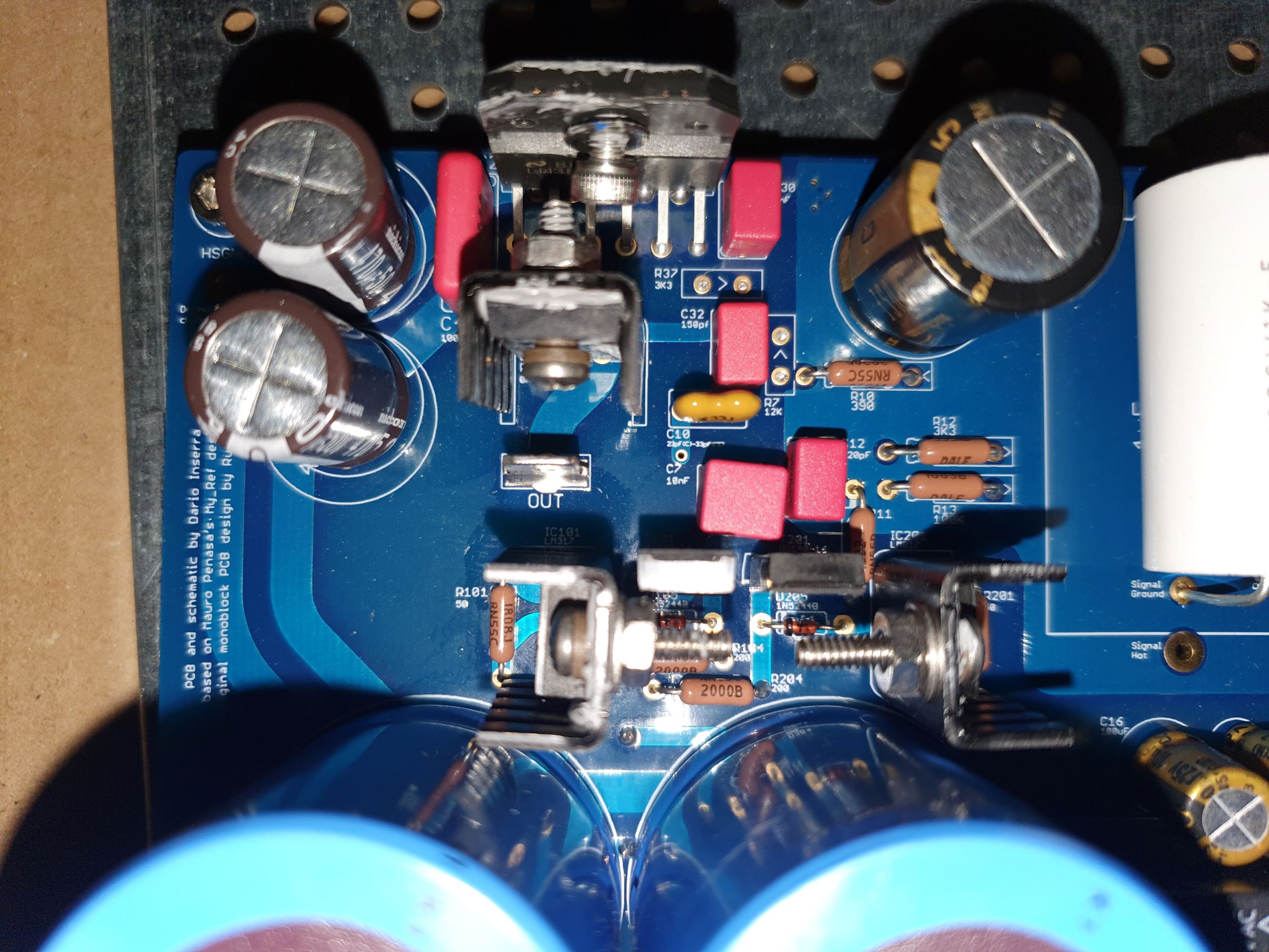

Eagle-eye
Troubleshooting step 2
Good news, after resoldering C13 ... music is playing! However, it's a bit on the quiet side. I attached a small bookshelf speaker (Audioengine A2; 3.8 Ohms), normally attached to a built-in 15 W RMS amplifier. I can put my phone volume on max without it matching the built-in 15W RMS amplifier. I thought the LM3886 was rated at 68W RMS (4 ohm)?
Is this normal? Any measurements I could take?
Try a passive speaker
Not sure how it is connected. Try a passive speaker to check output.
The speakerpair consist of one speaker that contains the amplifier and one that is passive. I'm only using one speaker at the moment: the passive one.

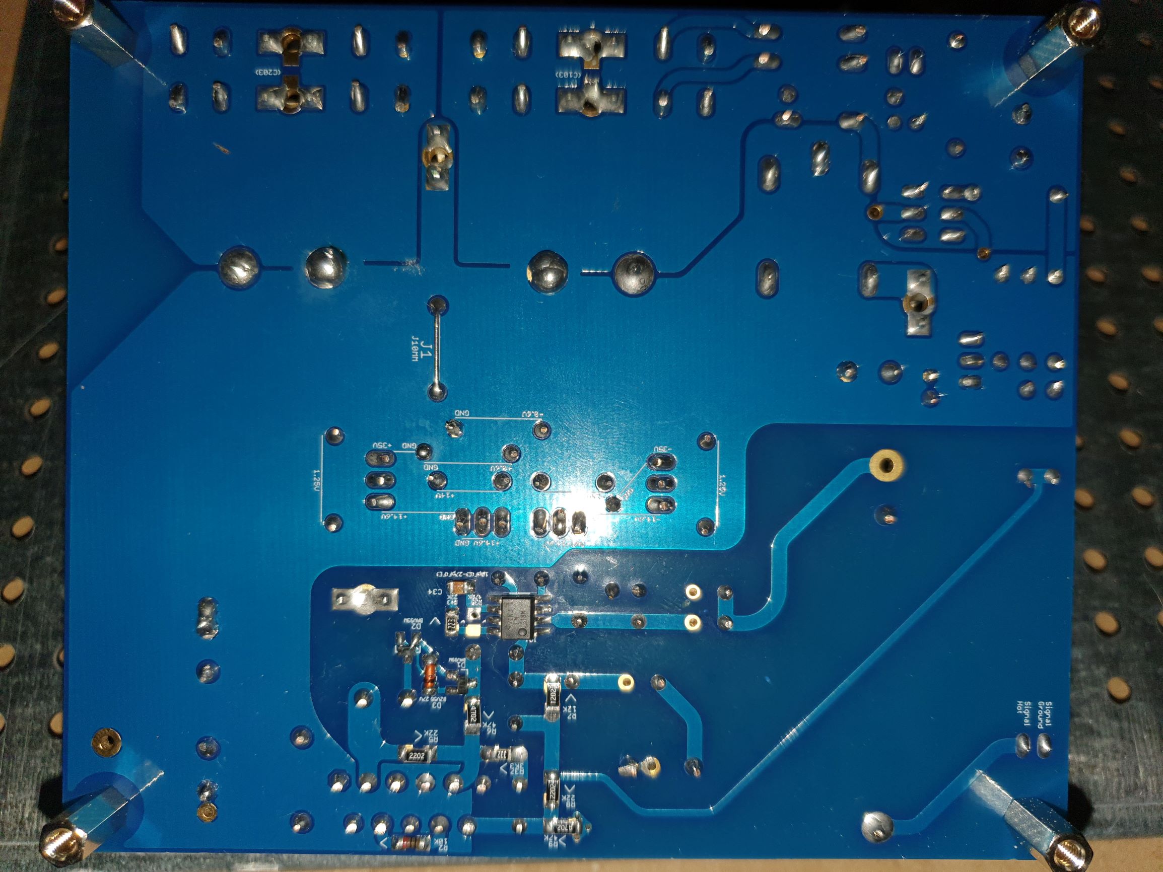

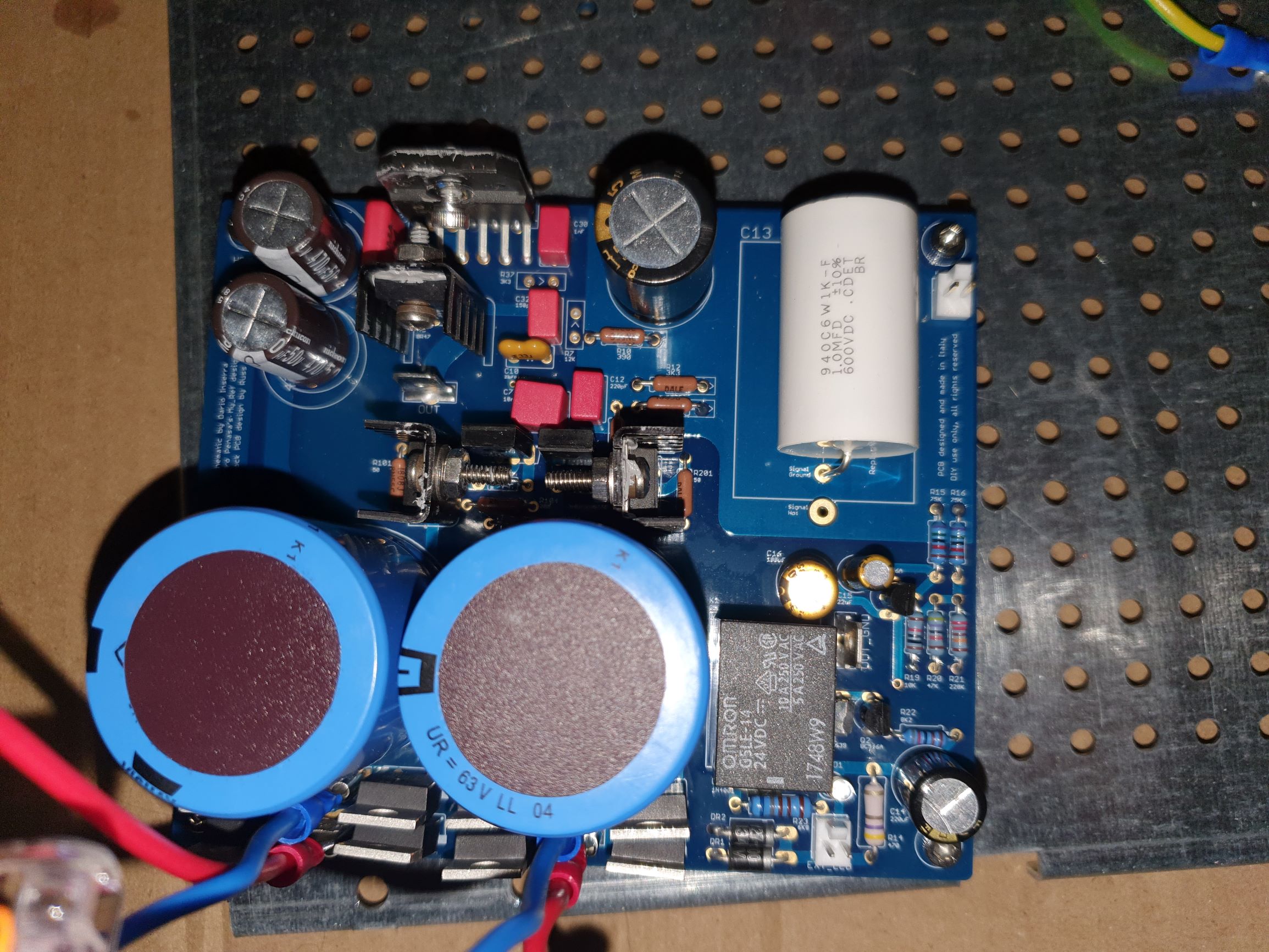

Some observations
Any suggestions on how to systemically approach troubleshooting the board? Or any good guides on howto troubleshoot circuits? I don't have a background in electronics so I'm learning . Many thanks!
- Voltage difference between NAC1/NAC2 of 6,4 VAC RMS. Is that normal?
- With the speaker attached generating a 50Hz sine wave, I can measue a 1,1 Vac RMS over the speaker terminals and only 0,21 Aac RMS at maximum volume.
- When measuring the output terminals voltage difference I can measure 10.6 mV DC. Shorting the inputs does not have any impact on that measurement
Some observations
The relationship between output voltage and amperage sounds normal. Check polarity on input connection. Try bypassing C13.
If not this then gain is all fouled up. The limiter diodes could be reversed or shorted. Feedback values incorrect, or voltage to the LM318 too low
The other thing is that you really don't know the sensitivity of the passive speaker connection or the gain on the built-in amp. It is entirely possible that they designed it with a low sensitivity speaker and a high gain internal amp to compensate.
An example of that sort of thing was the Bose car speakers from the early 2000's. It was cheaper to make a 2 Ohm speaker and mount an amp on the back of it than it was to use a normal speaker and a standard output dash amp.
For what it is worth, most home speakers (85 to 90 dB/W) can be played just fine using an FE with a 10k or higher potentiometer on the input as a volume. The gain of the whole My_Ref series is 30 which is on the higher end of typical home amps.

I would vote for input connection polarity as well...
Though.. I did not understand the line input AC value, too.. 6V AC?! Should be 24-25-26-27V AC RMS, even, depending on the transformer
And we did not hear about the DC voltages, as denominated on the backside on the board at the power supply section..
Though.. If the relay clicks, that is probably OK..
Then. It is on both boards or only one?
The feedback resistor values seem to be OK, as much as I can see..
And if it would be that low gain, because of an error there, it would be oscillating.. So probably not.
Try to generate a 100mV AC RMS, 370Hz signal on the input, and read the output, unloaded. Should be ~ 3,1V AC RMS.
370 is not a multiple of 50, and still low enough for the meter to be correctly revealed..
