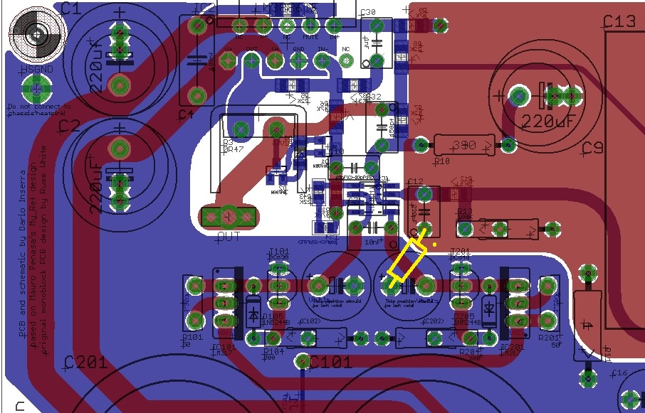

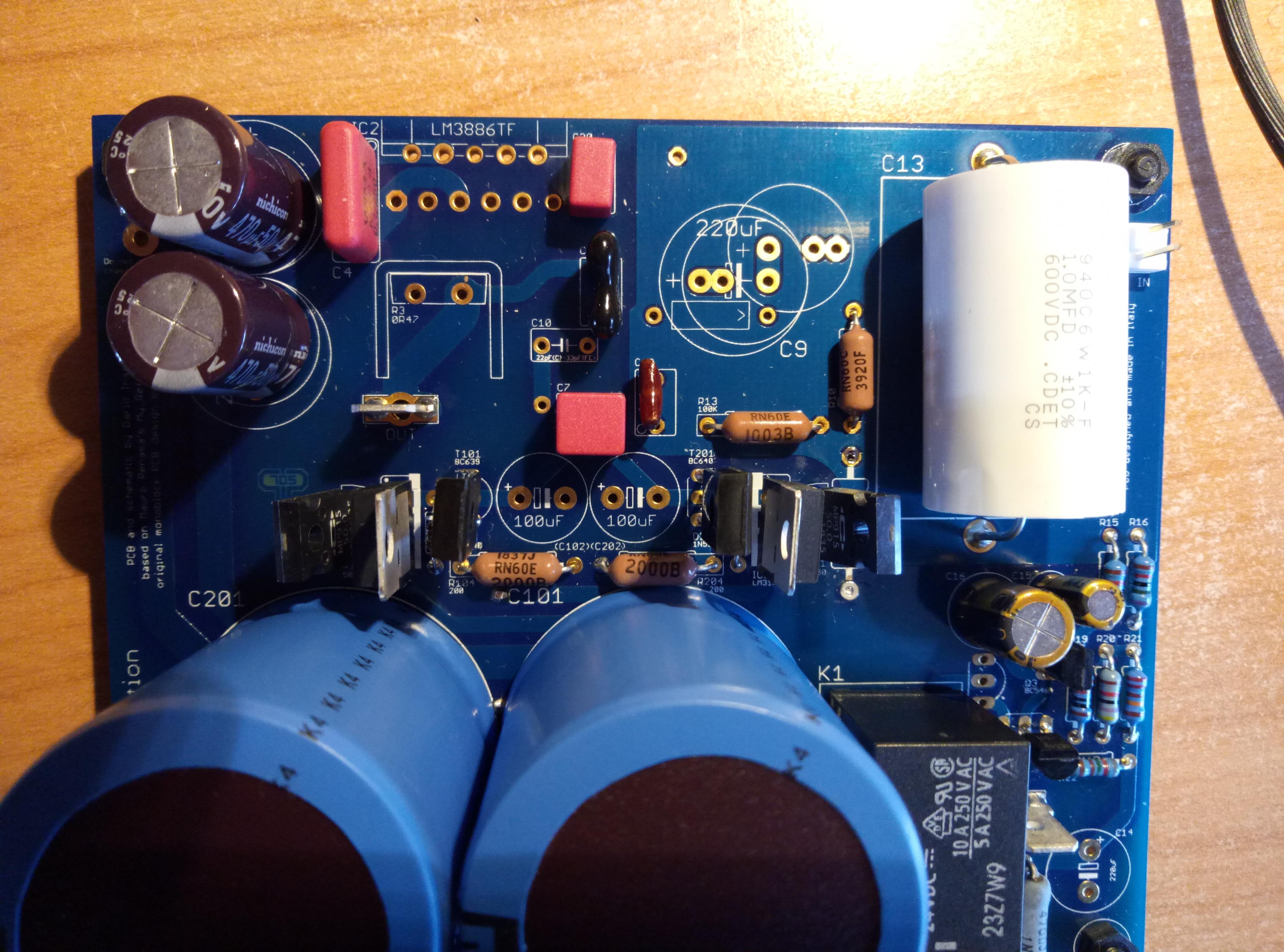

C9 position on Rev 1.0 board
Hello, sorry for the dumb question, where I have to place the 220 uF C9 capacitor on my 1.0 board? it seems in parallel with another one, and another little "resistor-like" seems to be populated, but without any kind of value. One terminal is in common with the + C9 terminal...
Interesting. It should have been marked. What you are looking at is R10, 390R, and you most definitely need it. It is a key part of the gain setting feedback circuit. You said that one terminal is common with +C9. The other terminal should be common with R7. If not, check if its in common with R11 and post again please.

I think I see your 390R running next to your big input cap, C13. Was that one marked R10? I can't see it clearly in the photo. In this early version, we were experimenting with the order of C9 and R10, which are in series. The original version had C9 first, then R10. In that case, C9 would go into the holes just above the "resistor like" component and the higher set of 3 holes would be left empty. In this version, R10 would be in the position that you appear to have it mounted.
The alternate order for C9 and R10 became preferred and later boards don't have the option. If you can, it would be slightly better to remove R10 from its current place and place it in the holes of the "resistor like" component. Then put C9 in the group of 3 holes near the top of the picture. The result should be R10 with its left terminal common with R7 and its right terminal common with the + terminal of C9 (in the upper position). The lower position of C9 would be not used. The right or negative C9 terminal would be connected to the ground plane.
I hope I was able to explain this clear enough. Its hard to describe. Please ask questions if its not clear.
Of course, there are no dumb questions. This one in particular was tricky unless you were around back then. I'm feeling a little bit old.

Hello Jac, no the resistor R10 is already mounted, is the one just near to the C1 capacitor. Having a look at the schematcs it seems like a "capacitor first, resistor second" vs. "resistor first/capacitor second" choice, with the first one that terminates on R 11 1 Ohm resistor before Gnd and the second one directly to Gnd.
Probably I have to populated the marked C9 capacitor place, I've just tested the electrical continuity and it should be correct. Anyone used the Rev 1.0 board, just to have a confirmation about the correctness?
Massimo
Massimo
Jac, but in this case the feedback net terminated directly to ground, not to the 1 Ohm resistor (R 11). By this way the input net and the feedback net won't see the same potential. Is that correct? In all the Dario schematics the feedback net terminates on R 11, not directly to ground (I admit, I'm a little bit confused about it).
Probably I'll go populating the C9 indicated place, it's quite a pity, the unmarked place should have been perfect to try some bypass small capacitor in parallel with the big electrolytic one...
