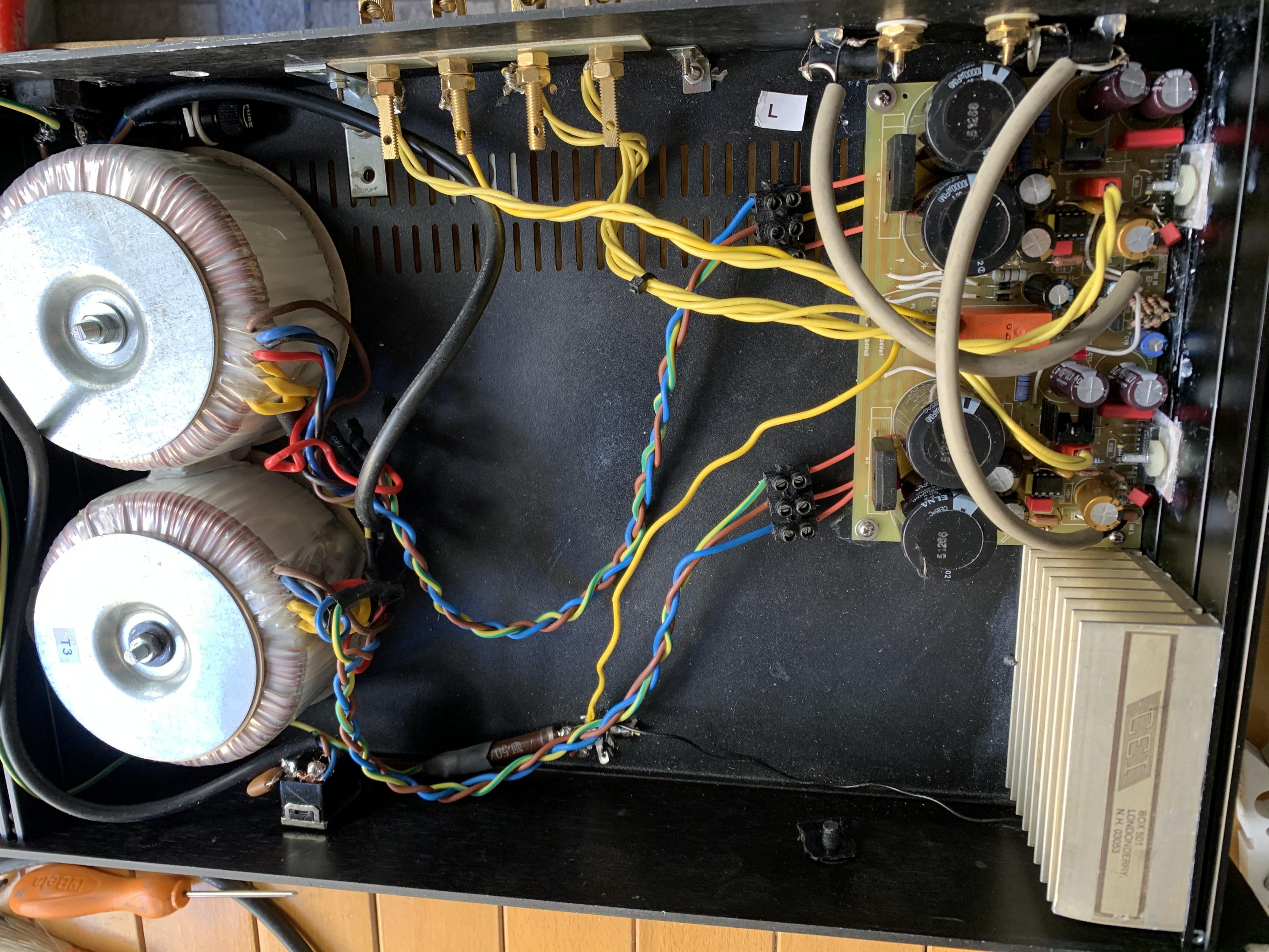

Thank’s to the people writing from many years about Mauro Penasa my_ref amplfier i was encouraged to give new life to a old myref rev A,the original board of Mauro .
I did it just for play with a new toys ,discovering that my_ref isnt a toy amplifier
I have applied the evo A mods,add two big 25 volt 6 ampere surplus talema transformer,and and few better components in the crucial place
My original built of rev A many years ago was’nt so accurate..
It sound now very ,very good.
A lot of detail,armonious and fast
I think that the transformers help the amplifier to play very well at low mid frequency that are fast and articulate
It works with low frequency as 100 watt amplifier,very clean

Very nice, Tonix. That's an innovative approach to the heat sink. These things don't need huge heat sink, but using the side panel and adding an additional remote heat sink is a cool idea.
@thunderchicken,
TONIX amp shows nice principles in the layout, IMO. He as kept his pcbs close to the back panel so that the signal runs from the panel inputs are short and away from the transformers. The My_Ref (FE or not) has pretty good PSRR, so you can run the AC to the transformer close to the pcb, but the farther away, the better.
Alas, I manage to complicate most of my builds, so they aren't good examples to show.
