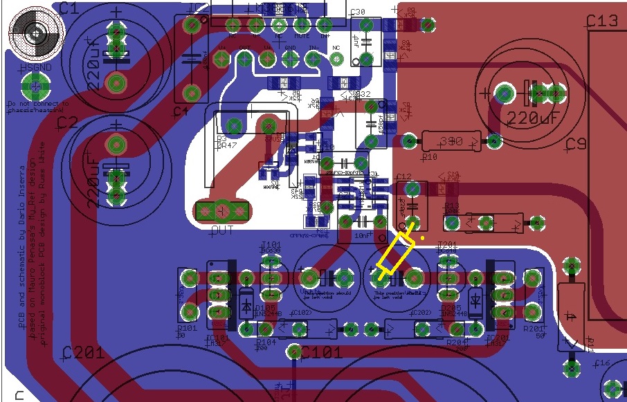

If You have the right value, I would leave the Armtrans..
Also consider two Pana PPS in series.. Like 0805 /50V /220pF..
(Mauro had used like this in his EVO)
And yes, You got it well.
You could also consider my photo..
It's a pain but turns out to be one of the better sounding solutions.. (those are Susumu RS quartetts)

There's also the HRG series from Susumu, a high power 1 watt resistor in 1206 size ...
https://www.mouser.co.uk/datasheet/2/392/n_catalog_partition24_en-948804.pdf
A bit more explanation. Using quads does increase the power rating because it spreads out the power between the 4 resisters, but that is not the usual reason for trying quads in a low power signal like George is doing with his RS quads. The theory suggests that using quads reduces distortion and in some cases, it seems to sound better.
Just using a higher watt resistor, like the HRG, might be better sounding, but not for the same reasons as George's quads. Most likely, the HRG won't sound different than a plain RG because it is a higher watt version of the same technology. The safest bet, for non-heroic solders, is probably the RS. Look here to find too much information about quads.
Quad or Series/Parallel Resistors as an alternative to traditional power resistors
In addition to George's alternative to the Caddock in R3, I have used 1 watt Susumu in a quad configuration on a mini pcb to spread out the heat. These resistors are metal foil SMD and it works pretty well.
KRL3216E-C-R330-F-T1 Susumu | Mouser

Thanks for the input and the links. There seem to be several mechanisms at play here when it comes to resistor performance. This thread includes measurements showing that larger resistors have lower 1/f noise (all else being equal). Presumably this is because they heat up.
High 1/f noise in SM resistors
Similarly, the lower heating will modulate the resistance less, leading to lower distortion. There’s also this from Vishay describing their MELF resistor, which refers to surface area affecting field strength, which leads to lower current noise …
https://www.vishay.com/docs/48111/_melf_venturecraft_en_vmn_ad0409_1607.pdf
The RS resistors have different materials/construction to the RG, which leads to better noise. How all this pans out to what we hear, who knows. I also used quad 1 watt Susumus for R3 following your idea, worked well.

Hey Dan,
I had forgotten that you had played with R3.
As you say, there is a lot going on,some of it contradictory and some not enough information. In the end, you just have to try it.
Thanks for the link. That was a pretty good conversation and I wouldn't have expected the kinds of results he was getting, even at a gain of 800.. Especially at the relatively low resistance values he was measuring. Usually,you think of 1/f noise as something that happens at low frequencies with high resistance.
Let us know if you try the 1 watt HRGs. I'm curious to learn more.

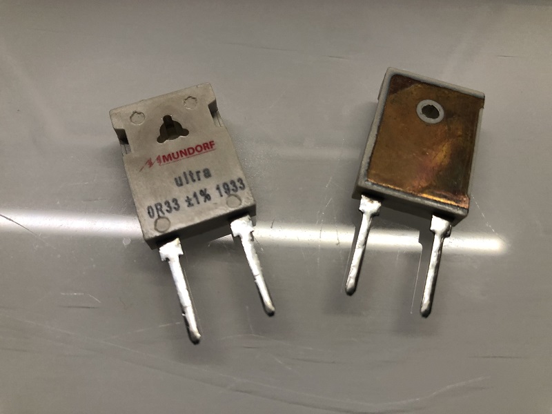

Power resistor for R3
These are possibly the best choice:
Mundorf M-Resist Ultra MREU30 30W Film Resistor | Hifi Collective
Sadly they're TO247 and a major PCB redesign is needed to use them... I will try them in the next weeks.
