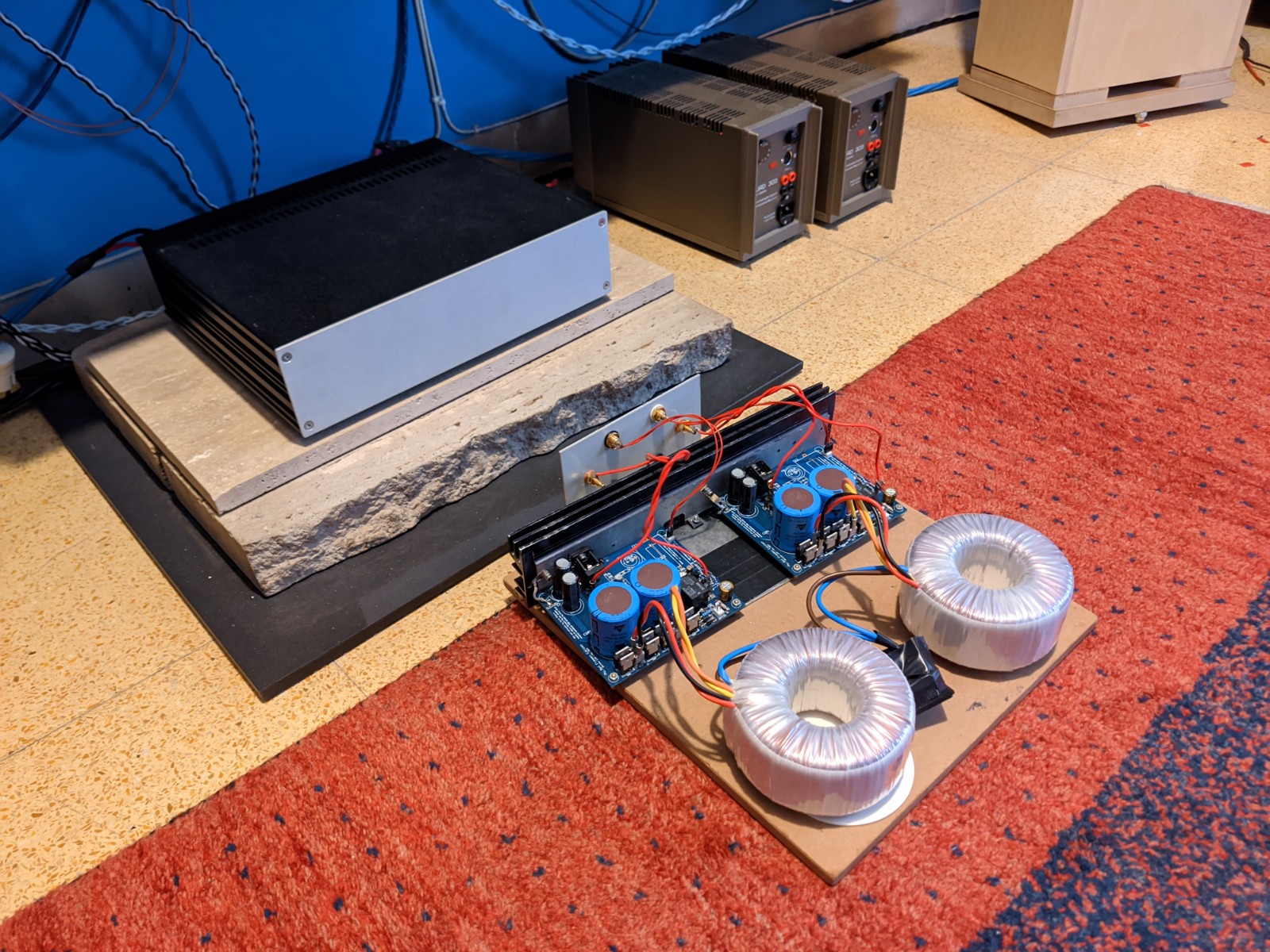

Giacinto,
First, Stay safe. I too am listening to even more music and working on audio projects to keep busy. But if you show nice pictures like that, you will have to say more about what is in them.
I recognize the picture of your FE with George's test board. His test board always looked better than my mess. The speakers look very nice and, of course, DIY. I recognize the Metrum Amythst which you mentioned earlier.
<As an aside, I don't know if you heard, but Metrum is gone. They had a bankruptcy in February. Cees, the brains of Metrum has been bought out more than 1 year ago and now makes DACs as Sonett Digital Audio. I have 3 Metrum DACs, so I have been paying attention.>
I am most curious about the turntables. The one on the left looks like it might be a Denon direct drive? The right one?

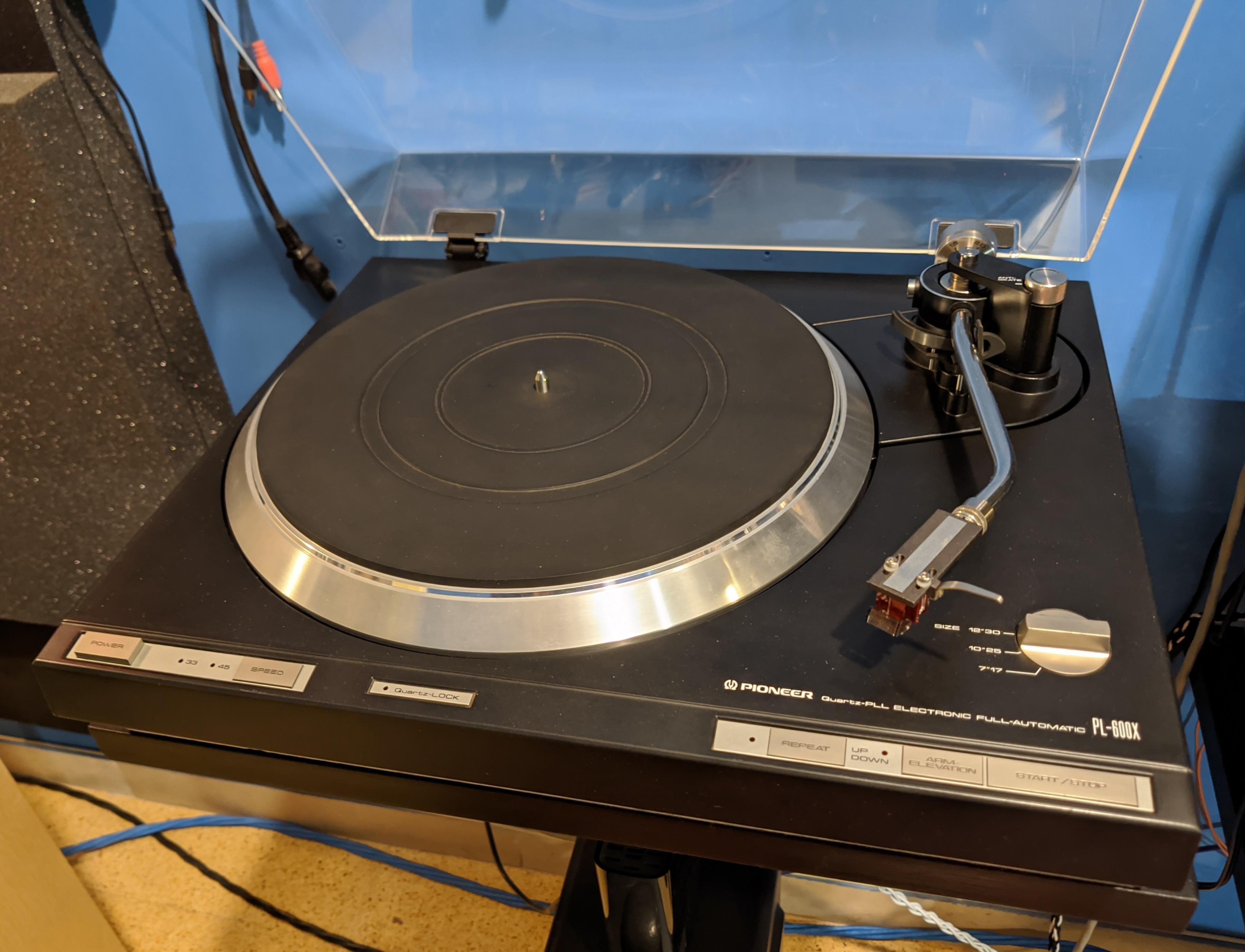

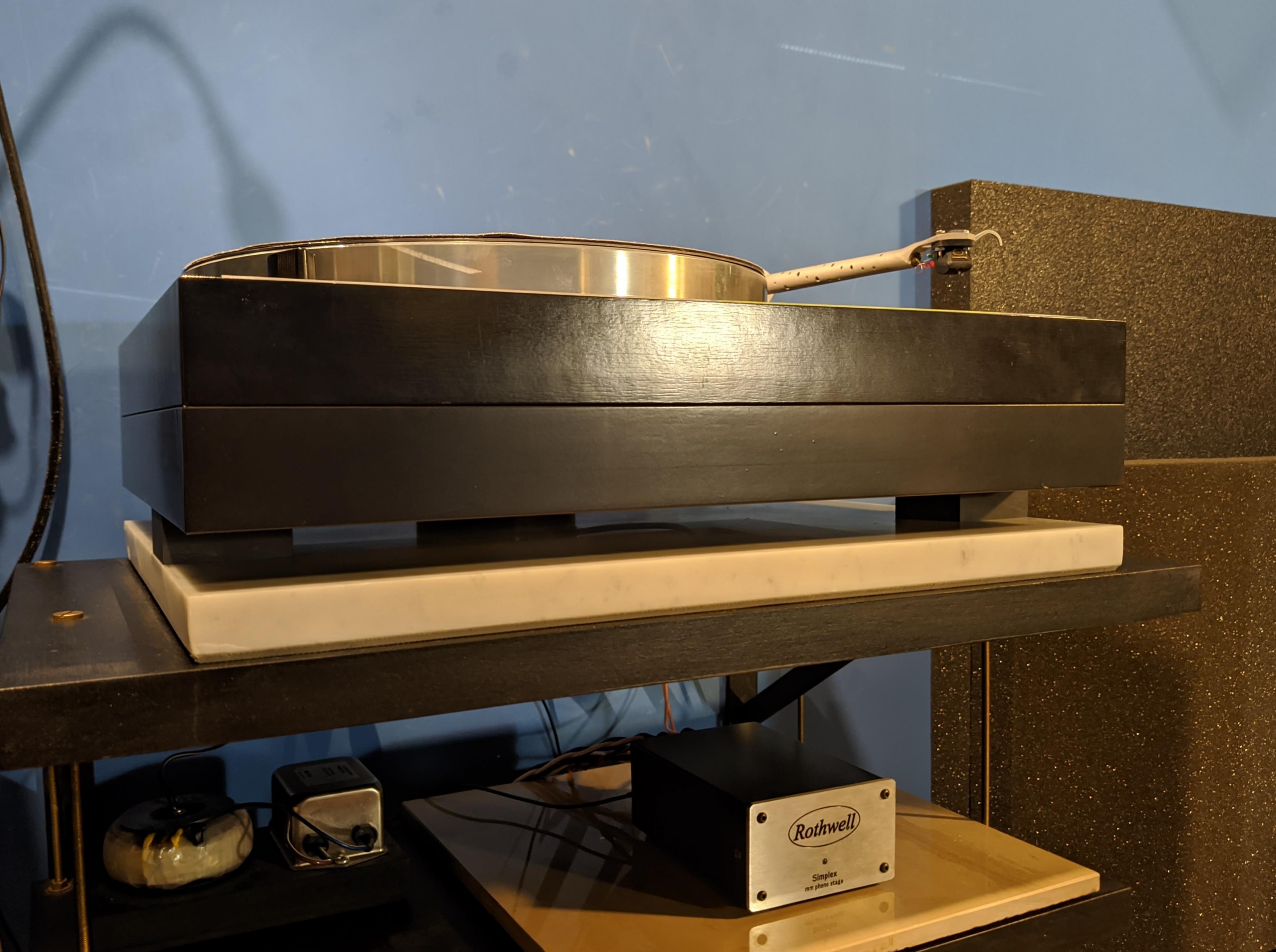

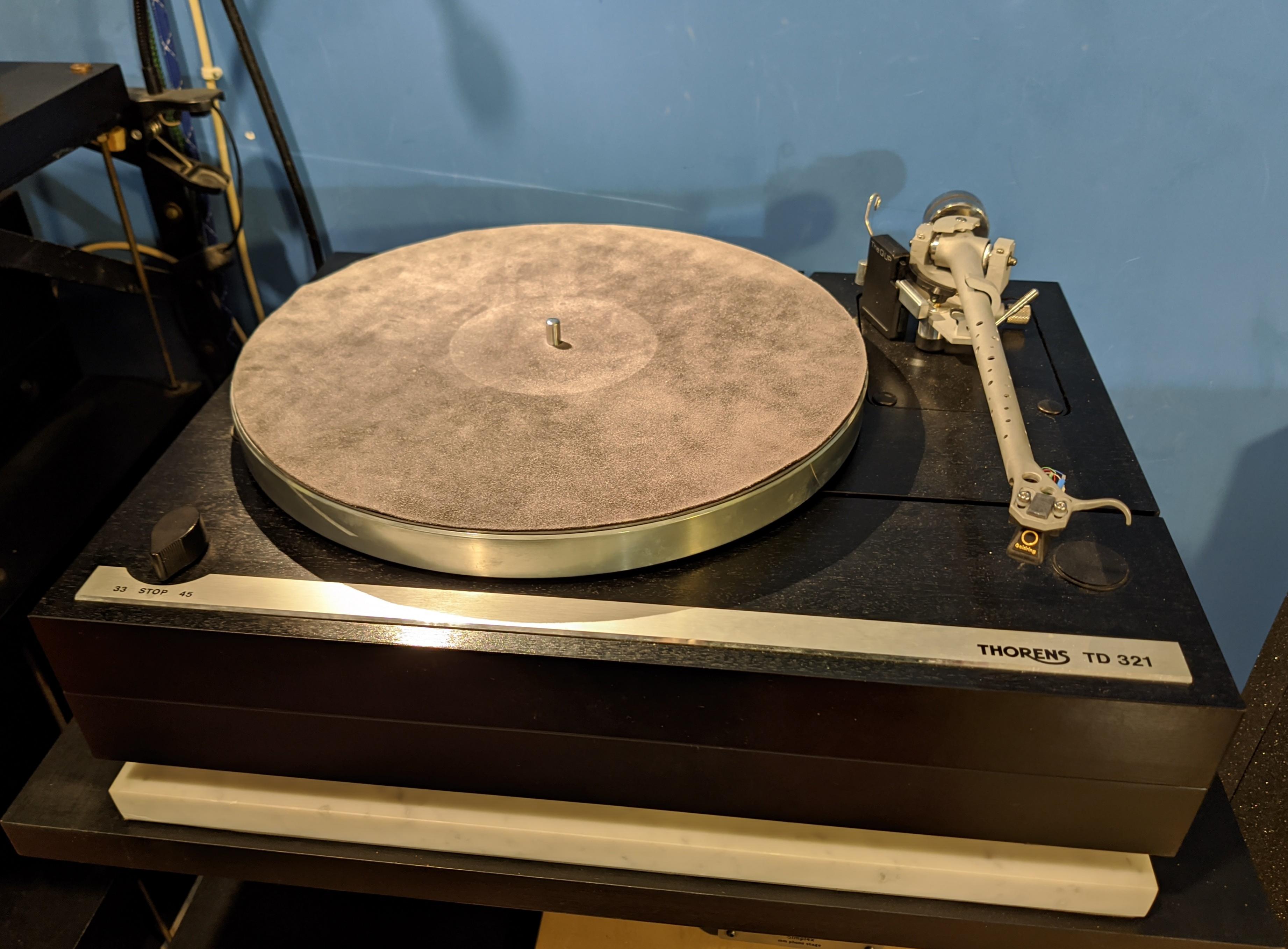

Jac
The direct drive on the left is a Pioneer PL600x. It is perhaps not as fascinating as others, but it has a lot of concreteness. Motor and arm of excellent quality. Suspended frame very effective. Fully automatic, smooth movements, very comfortable to use. With this turntable you put records after records as in teenager afternoons. Play with a Denon DL110.
On the right is my "Frankenthorens". It is a Thorens TD321, replaced the lower cover in very resonant steel with a small anti-resonant plinth (dampened with lead inserts). Graphite, marble and rubber form the basis. Replaced mat: lead + leather. Replaced wall tranformer: toroidal + emi/rf filter. The arm is an Audiomods Classic II. Play with a Goldring 1042.
Both of them really like My_Ref FE. And I apologize for going off topic

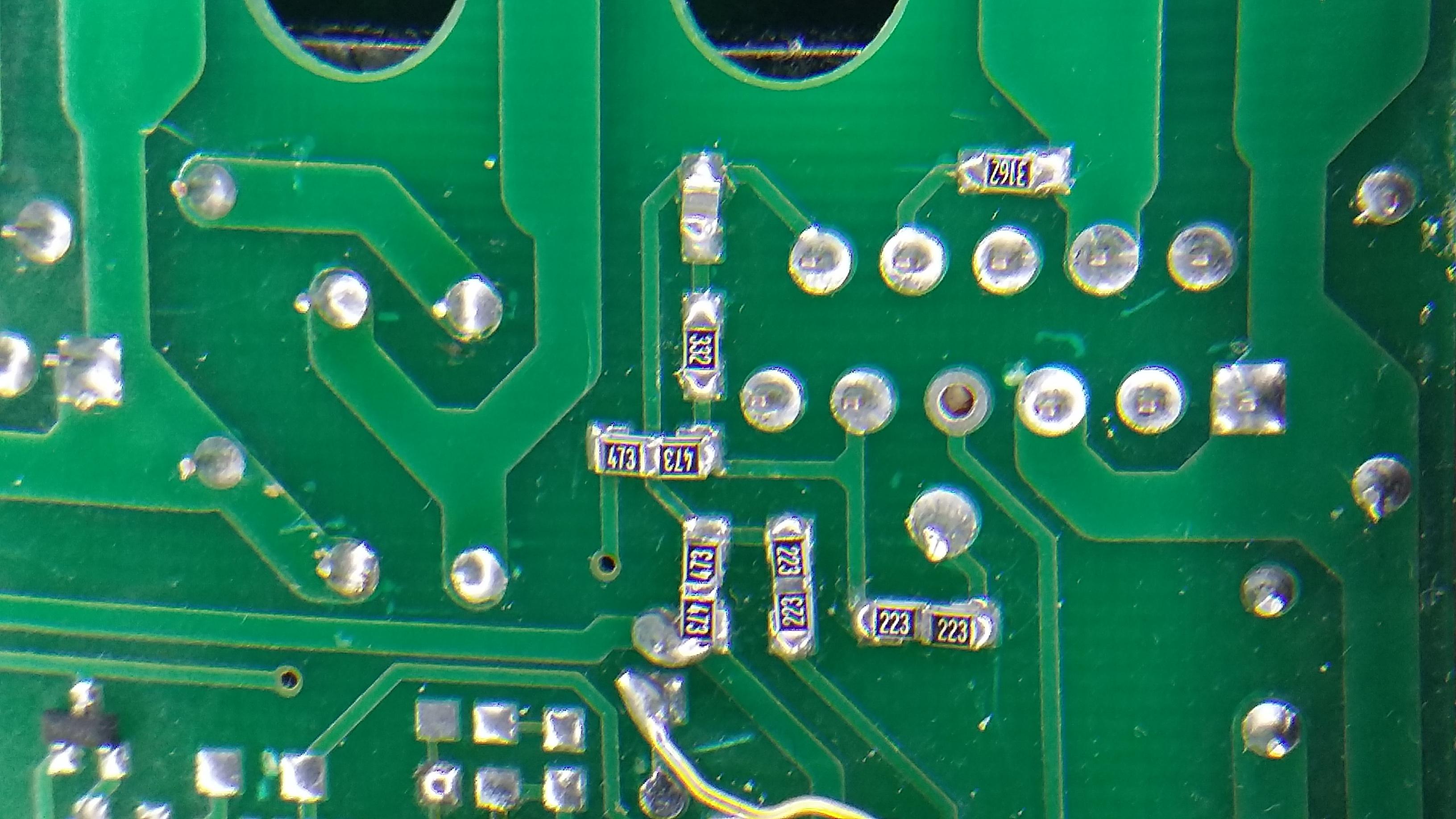

Hi George, noticed this post of yours.While i was preparing my upgrade BOM for Myref noticed Mouser has all values in 1206 package from Rs Audio series.Instead of costly Z-foils in the bridge, we have also found a quite good solution, still with more human cost. The new Susumu RS series for audio.
There are problems: they are available (Mouser) only certain size and parameters (precision).
Though we found that pieces from the same strip are closer to each other less than 0.1 %, in practice (tested with precise benchtop meter)
So they can be used; they also come in 0805 only -- this is a more serious problem.. though.. with a lot of blood swear..t and tears - something like this can be done:
Would be a good idea to replace all smd resistors with Rs audio series?
What do you think Dario?
There's also the HRG series from Susumu, a high power 1 watt resistor in 1206 size ...
That is good news! It could have saved me acrobacies like this ..
thank You for signalling..
