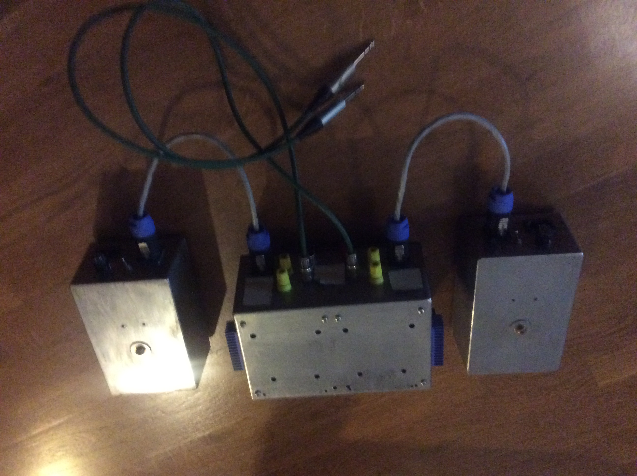

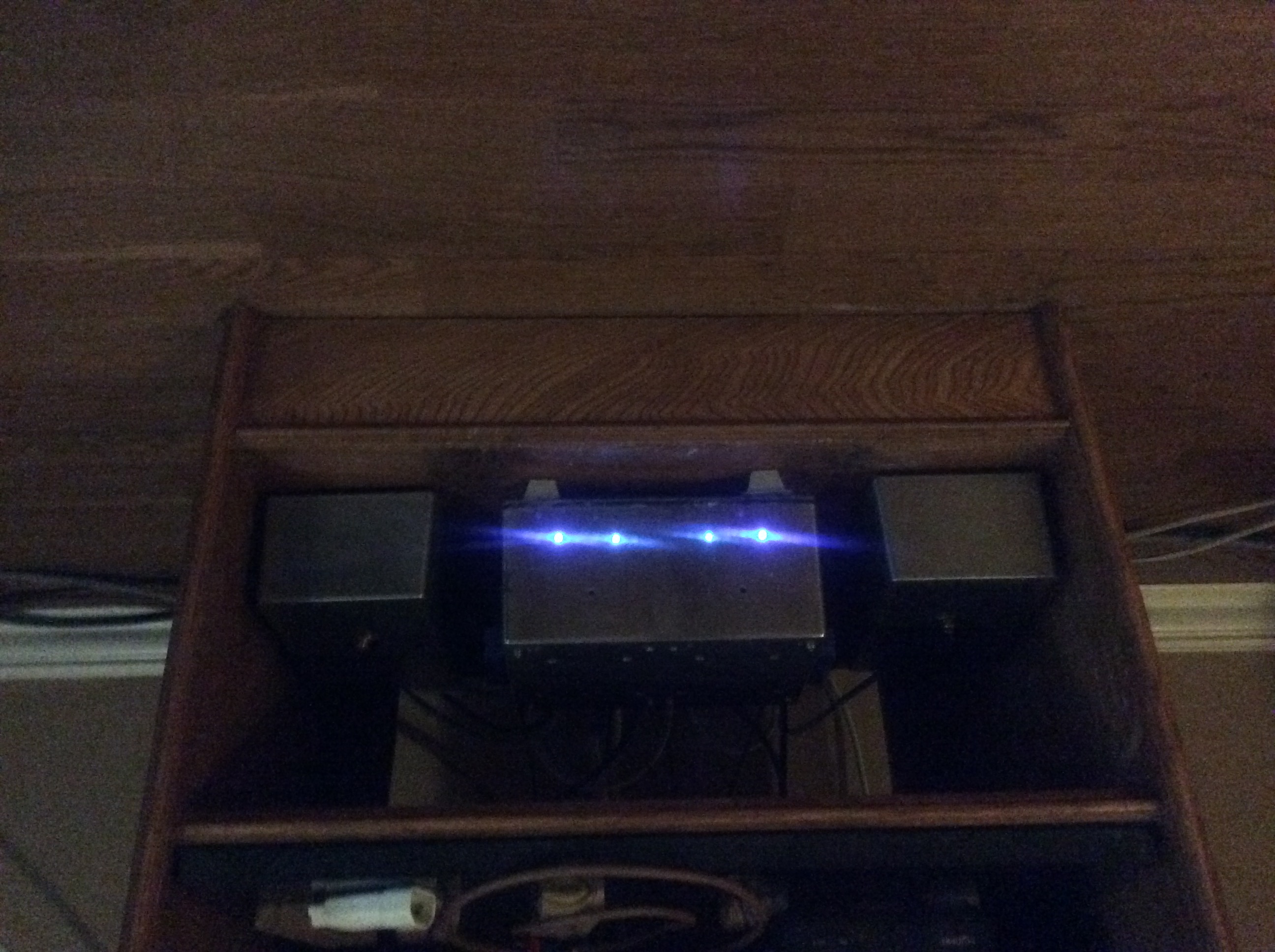

Hooked up and playing music
I was playing around with Micromega Myamps bridged. Like it, but put the FE Evo back this morning.

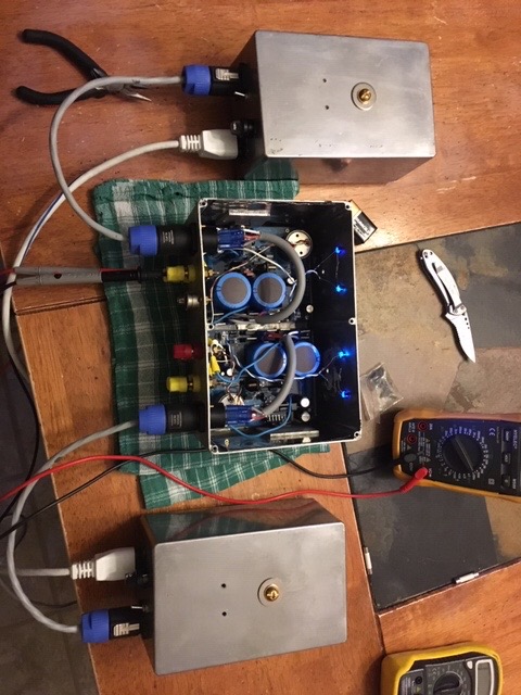

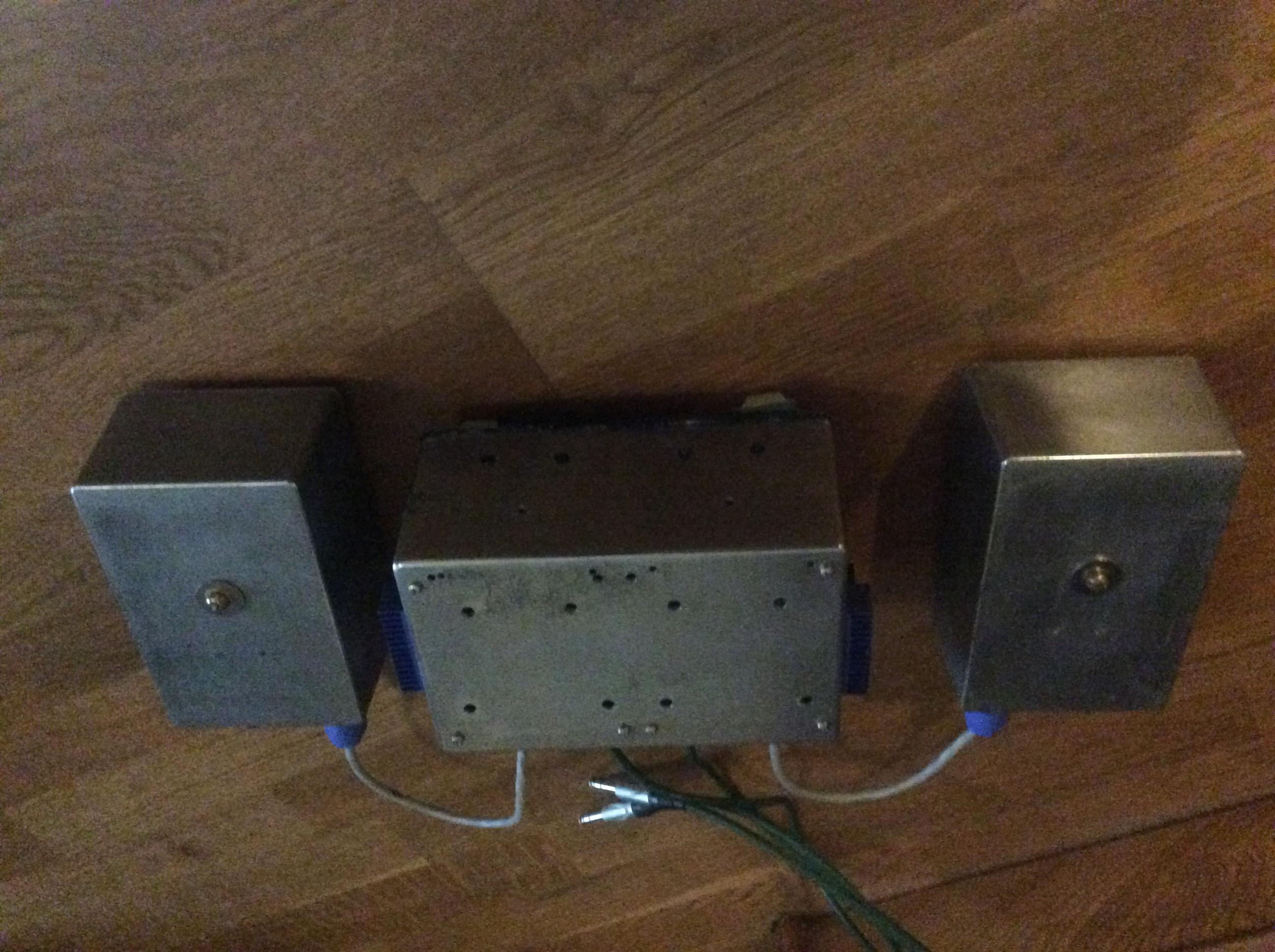

Using three chassis. Both FE boards are in larger box. The power transformer are in the two smaller. I have an old picture of the inside. Will post.
The chassis have housed several projects. I think these are fourth set of power transformers installed.
Nice little knife.

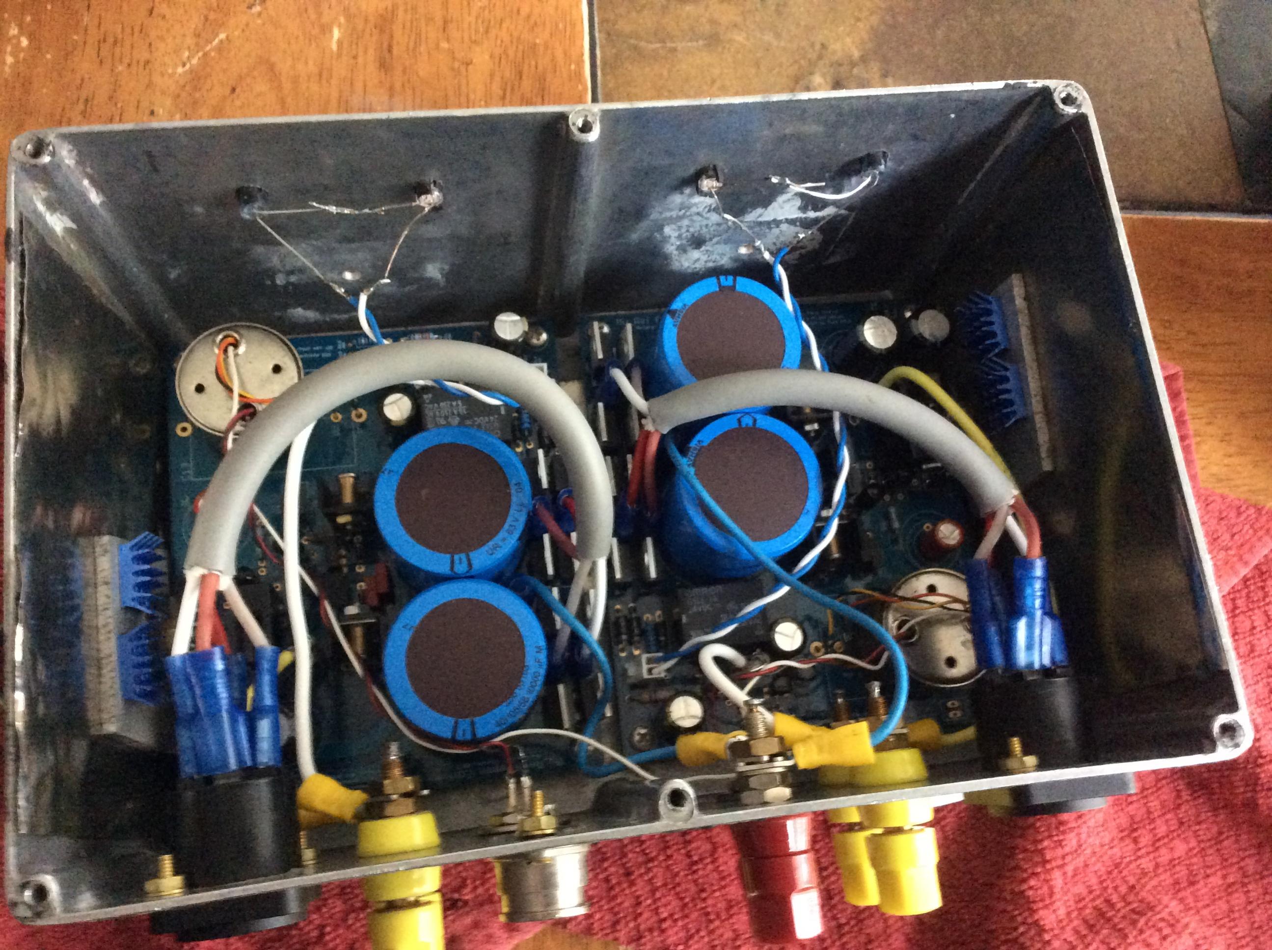

What are the DC connectors between the transformer and main chassis?
And what are the input capacitor? vertical silver cans?
Jac
Those are 4 pole Speakon connectors four the dual winding transformers. Those silver cans are Cinemag 4:1 step down transformers. No coupling caps.
Conversion transformers
They block dc plus;
Convert the balanced output from dac/interface to single ended.
They also do the impedance conversion of Pro to consumer.
And are 4:1 step down to manage overall gain.
Cinemag CMLI 10/600.

Cinemags are very nice. I should have recognized them, but the one I used on another project are the pcb type. Its interesting to see how much better bandwidth the 4:1 Cinemags have compared to the 1:1 Cinemags (my project).
I did my balanced to SE conversion with an opamp and at 1:1.
Jac
Jac
My overall system gain is too high. The speakers are over 100 dB. I listen at mW levels.
Jensen has a 8:1 line input that looks promising. JT-6110K-B. If bridged FE Evo gets built I will try then.

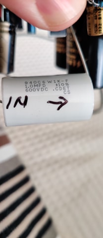

Anyone can help me with what is the correct direction to install the C13 input caps model CDE 940C? Couldn't find this info on this thread or build tutorial. Thanks!
For the my 940C signal follows markings direction.
This could be different from the build tutorial, I'm revising things and now that I have an oscilloscope I'm able to find out the outer foil for sure
