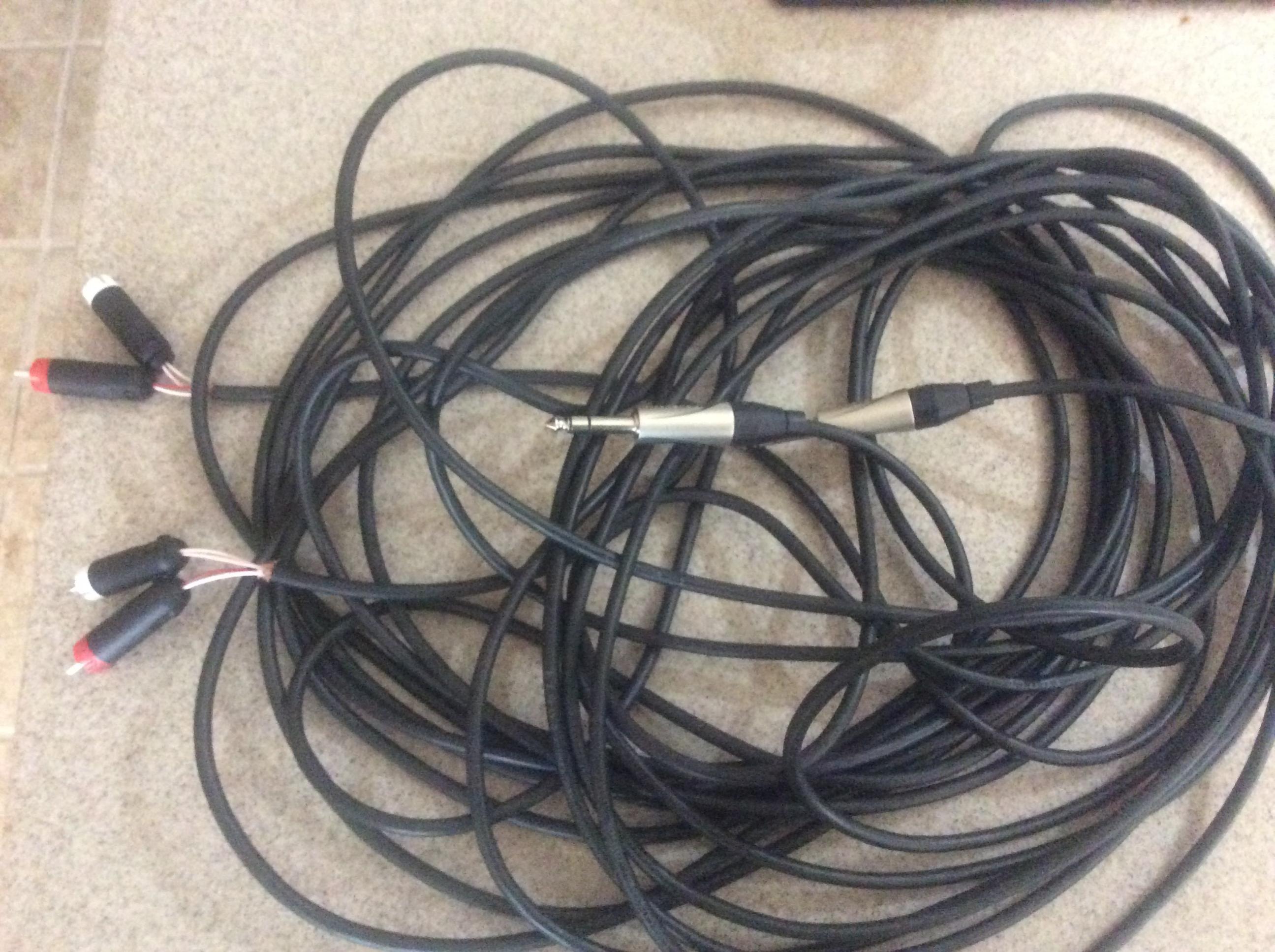

I like Sommer analog cables. Several online sources in Germany. The Red Zilk and Black Zilk microphone cables are my faves. Used to prefer the Carbokab, but the Zilk cables are cheaper, easier to terminate, and may be better. There is a top line SC-Albedo cable but I prefer the Zilk.
Just build some 10 meter cables yesterday. Needed a Star Quad type. Used some Gotham GAC 4/1 quad mic cable I found in the attic. Did not enough Canare Star Quad for two 10 meter runs.
The Gotham was better anyway; thinner, more flexible, and easier to terminate. Has the double served shielding like Mogami. The Canare cable has braided copper shielding. It is a pain to unbraid for connecting to the shield.
I like playing with cables. Cheap when you build your own. Even reuse the connectors and the cabling sometimes.
This is the hillbilly rig cable I built yesterday. It is used to bridge a stereo amp with single ended inputs to a balanced mono. Needed a quad cable for the two RCA connections.
Will build my next amplifier with two FE boards per channel as a balanced mono. WOD.
