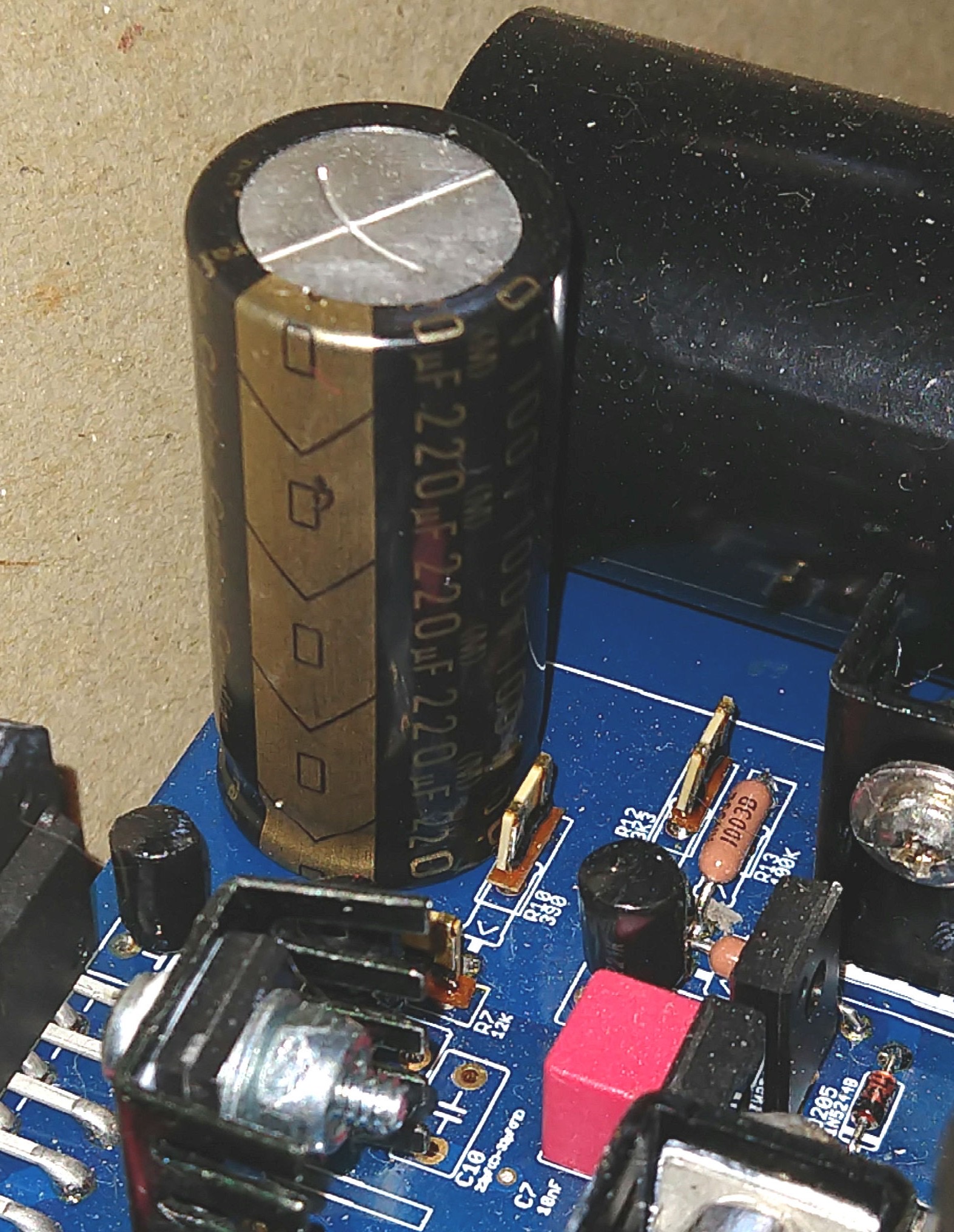

I am getting boards in the current group buy and am looking at the "upgrade" parts.
I cannot find an Elna Cerafine for C9 (220uf/50V) or Black Gates.
What would be a good upgrade equivalent?

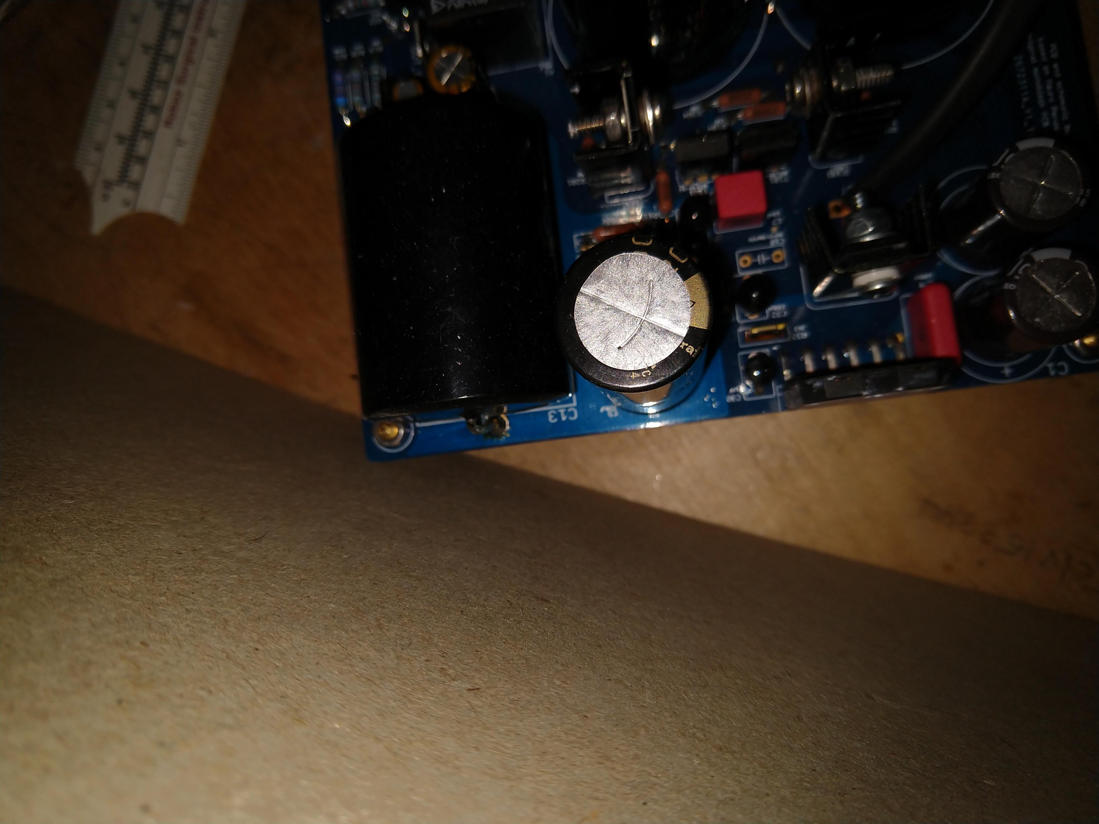

I have used the 200uF 100V cerafines from Parts Connexion on the V1.7+ boards with no issues. They are a slightly larger diameter but there’s enough room for them (see photos of edge of board and placement near R10, a Z-foil). On V1.5 boards it may not fit but it fits fine on V1.05 boards as well.
Pete

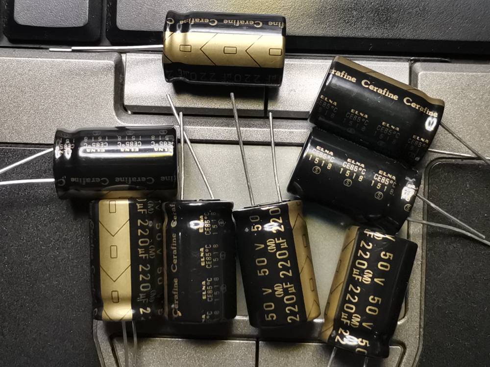

You mean 220uF. 🙂 But yeah, the 100v 220uF Elan Cerafine's are 2mm wider and 15mm taller than the 50v 220uF Cerafine's, and should work out with the new boards I would assume. It's about impossible to find a reliable source for the 50v or 63v ones.
