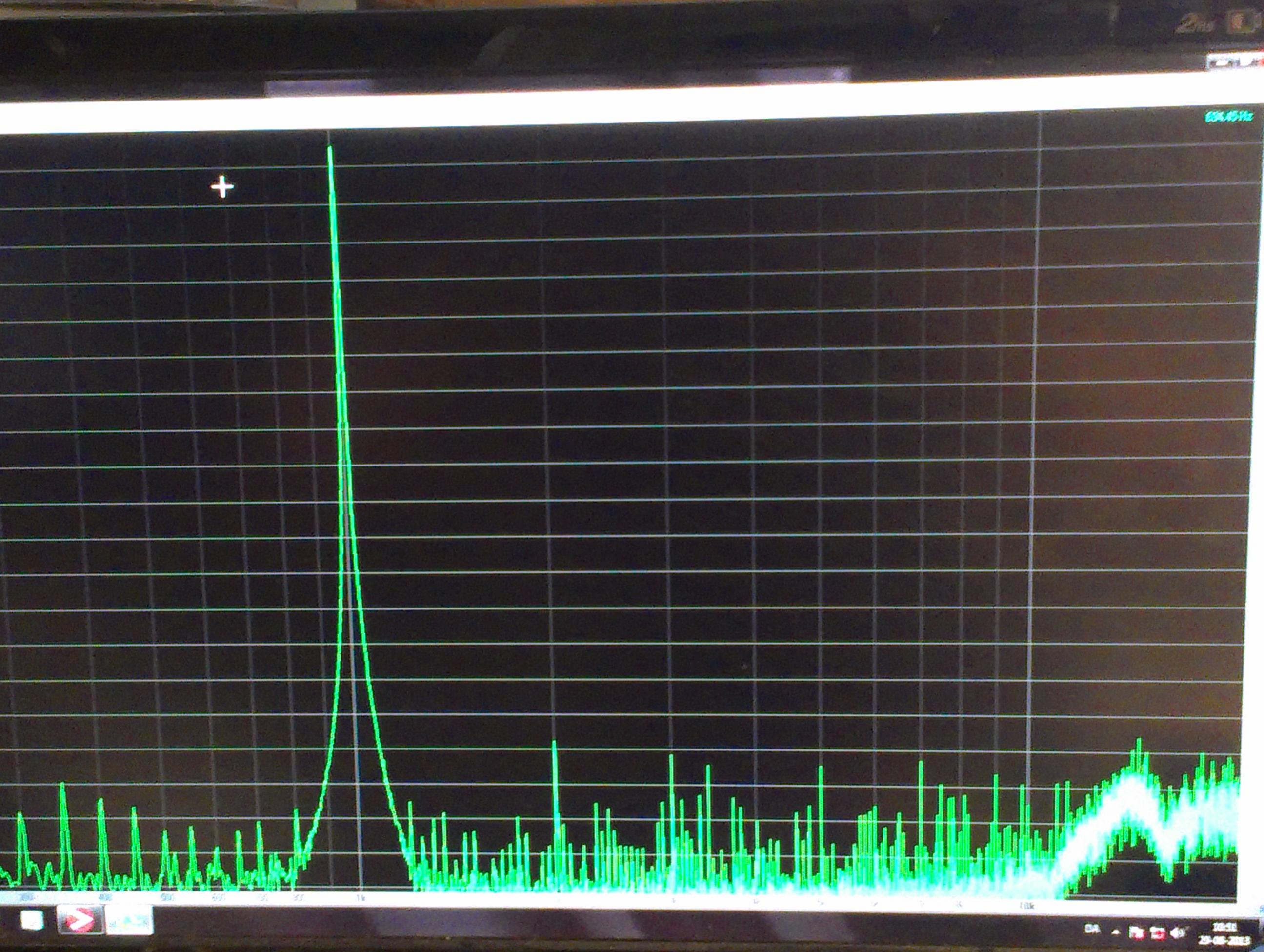

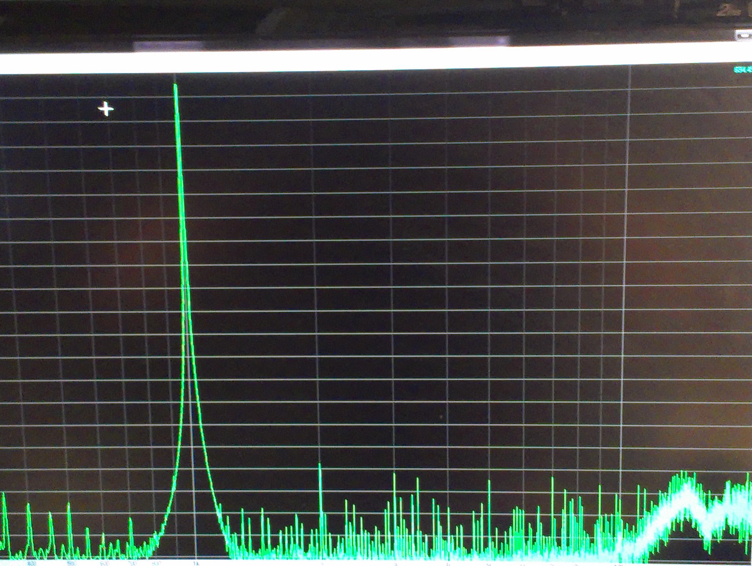

Just a short notice from me.
I just had My-Ref on the measuring table.
Also here incredible results.
There are 6 dB pr. division.
Output from My-Ref JUST under clipping.
The noisefloor is around -108dB.
Actually no trace of harmonic distortion products😀😱

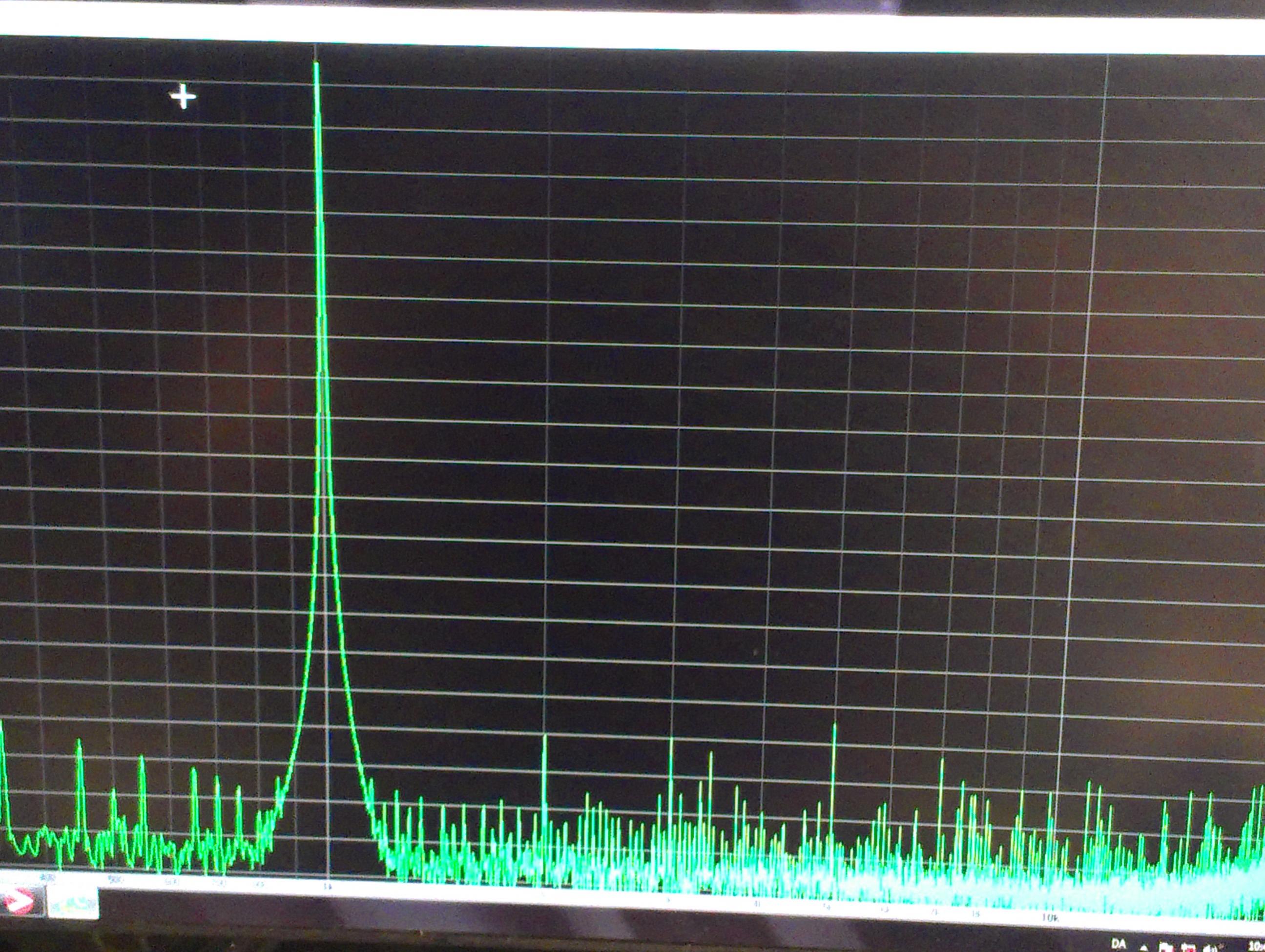

I managed to lower the noisefloor in my measuring system, wich is a computer with M-audio Revolution soundcard and Visual Analyzer software (free!)
The noise floor is now -114 dB and I can now see, that the soundcard has some distotion products around -102 dB see the first pic.
This is a direct connection from output of soundcard to input.
The next picture is the output from My-Ref just before clipping with C101/102 and the last without.
The pictures are not that good, but as I see it there is no difference between the results except som noise over 20 Khz when the My_ref is in the circuit, but this could probably come from the extra wires and the attenuator nessesary to reduce the input to the soundcard when the signal has been amplified by the My_ref.
I can't see the 50Hz to 350Hz spikes.
The odd harmonics of 50Hz are very high. 450, 550, 650, 750, 850
The evens @ 400, 600, are very low.
Looks like there is a lot of hum buzz that could usefully be very significantly reduced.
That might clean up the display above 1kHz.

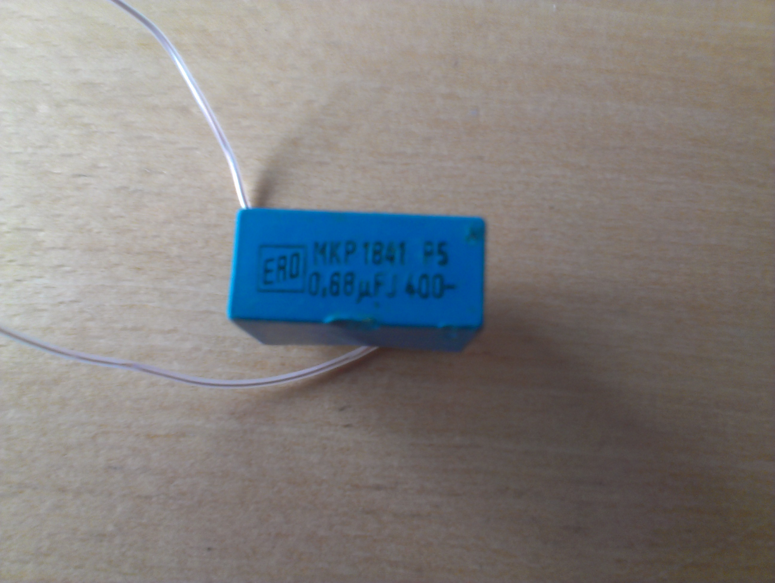

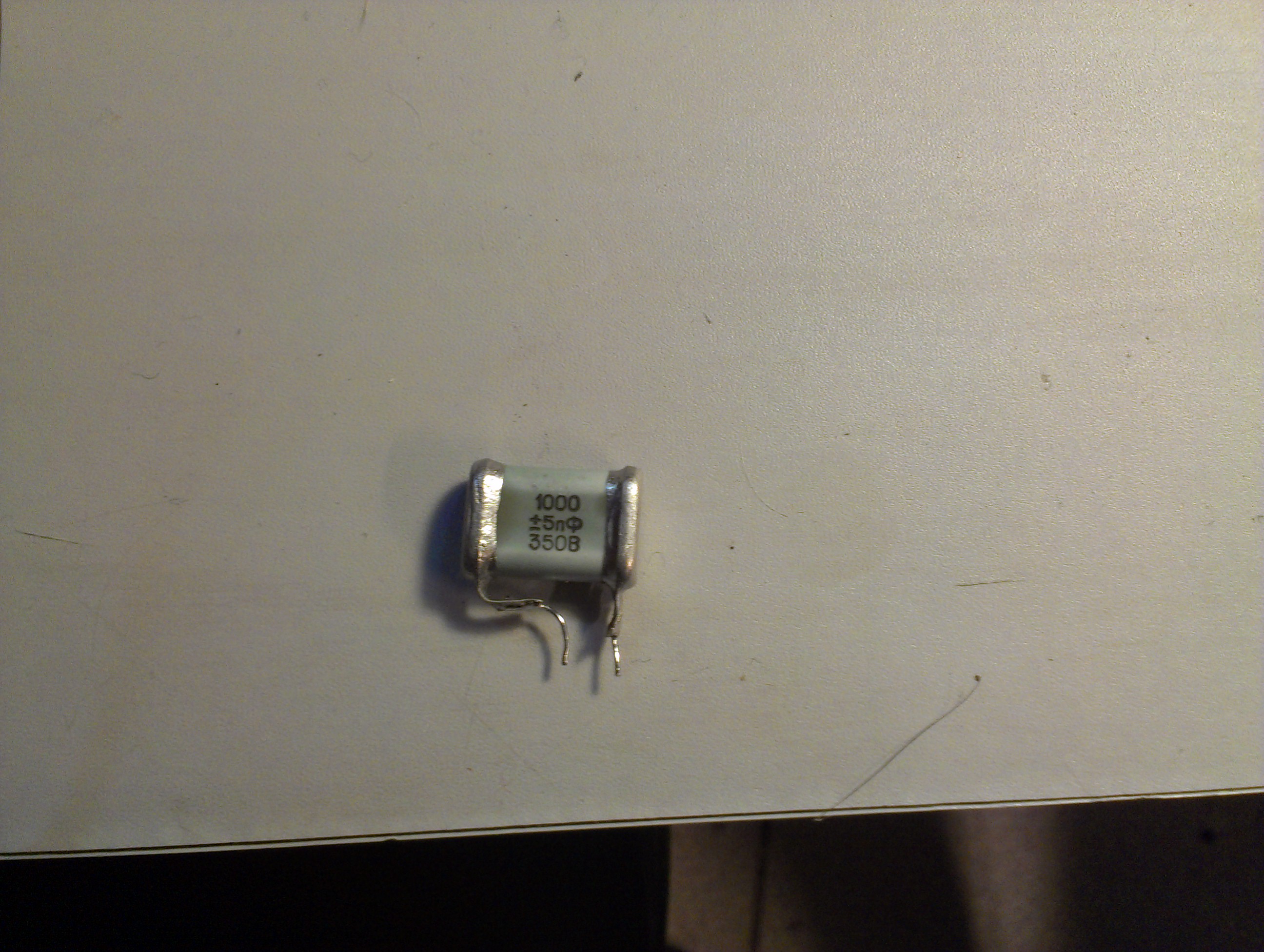

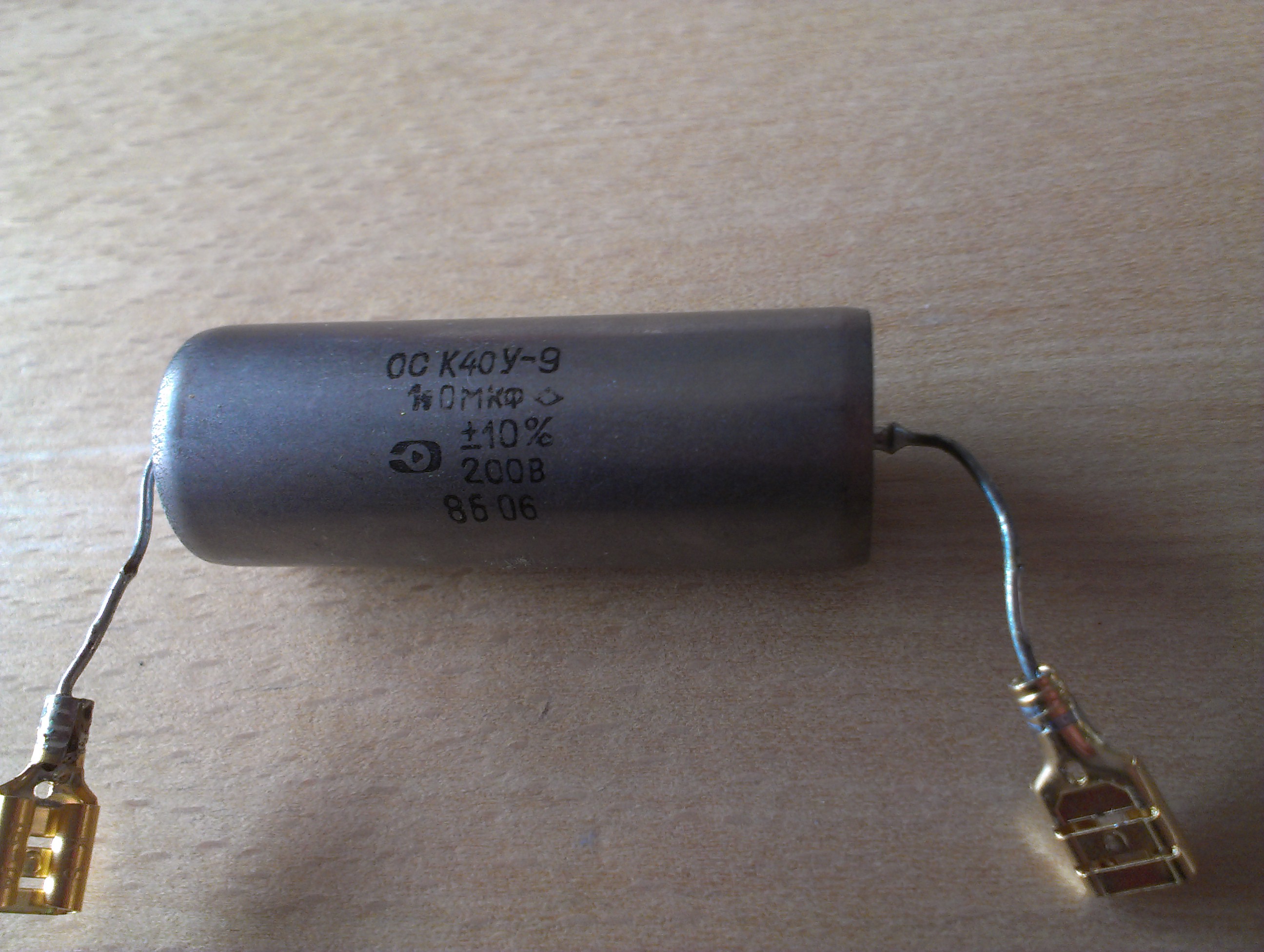

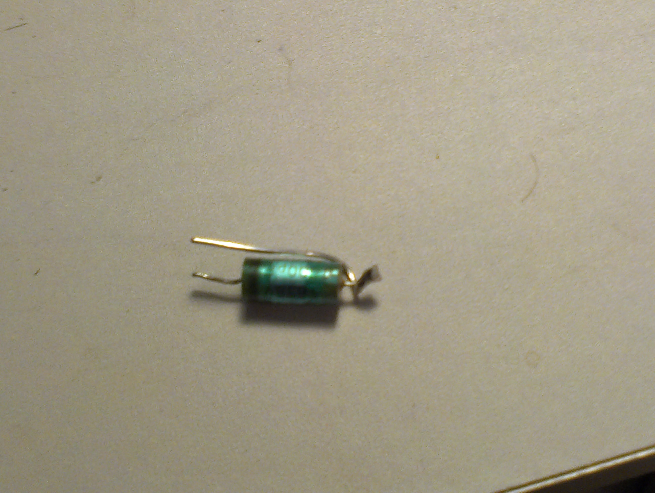

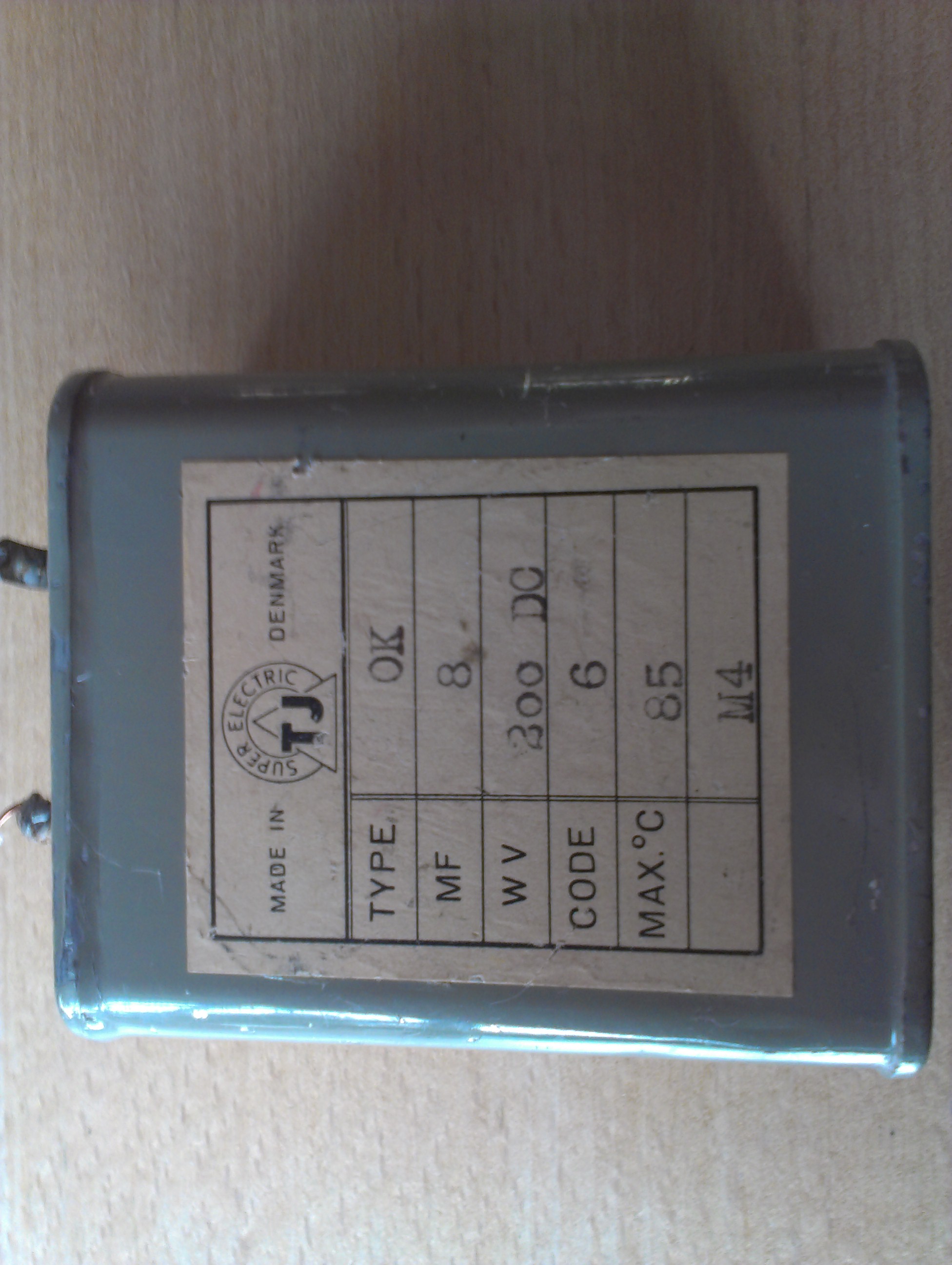

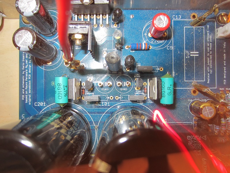

The battle of the exotics
In the last couple of days, I have tried differnet capacitors for C13.
First pic are all the caps.
Then each cap.
My personal ractions to these caps are:
ERO mkp:
Flat image and a little shrilly. Lifeless bass - a no go.

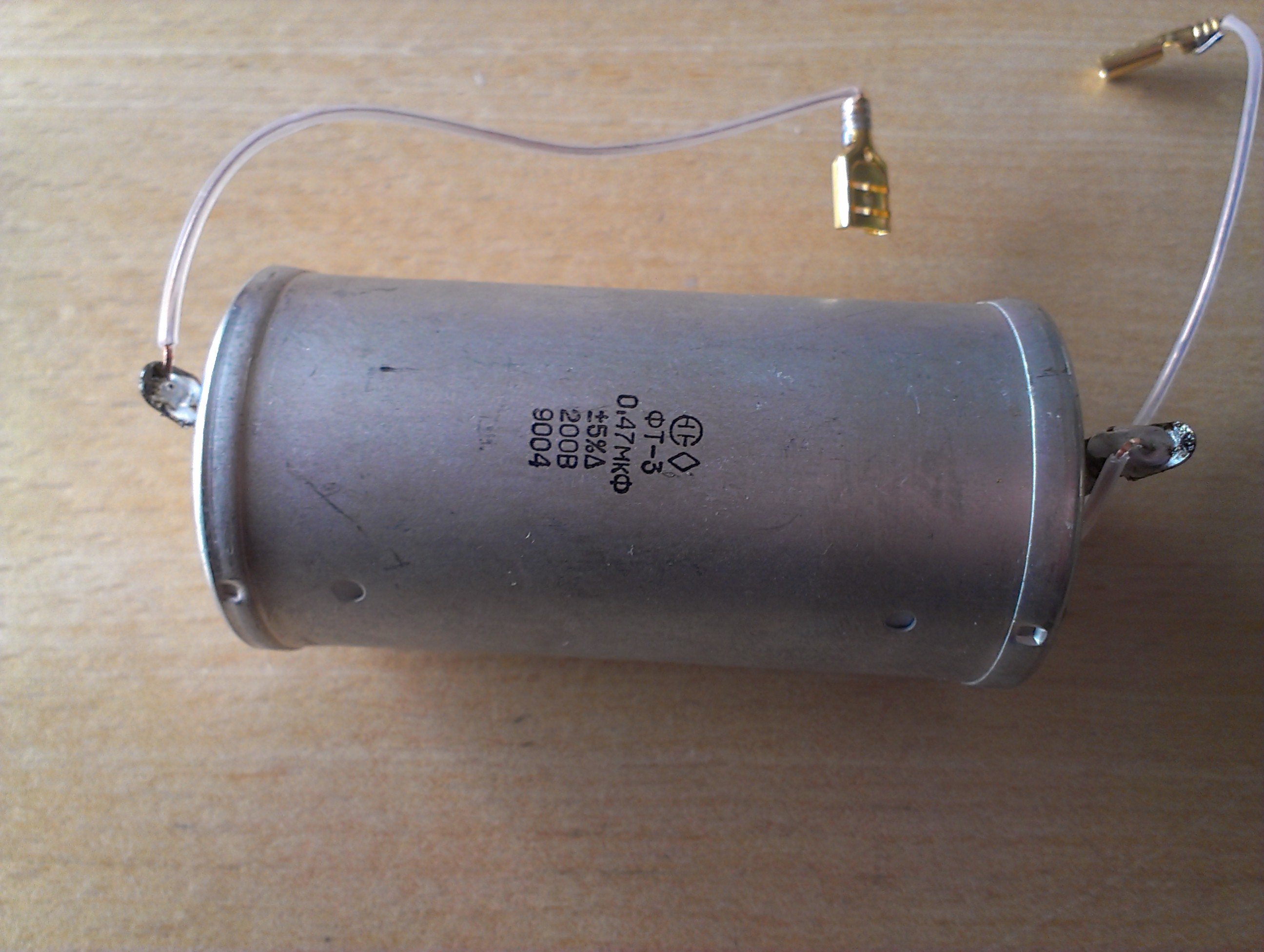

Russian Teflon:
Strange coloration and not very transparent (I had high hopes for this actually). Thin bass. - a no go.

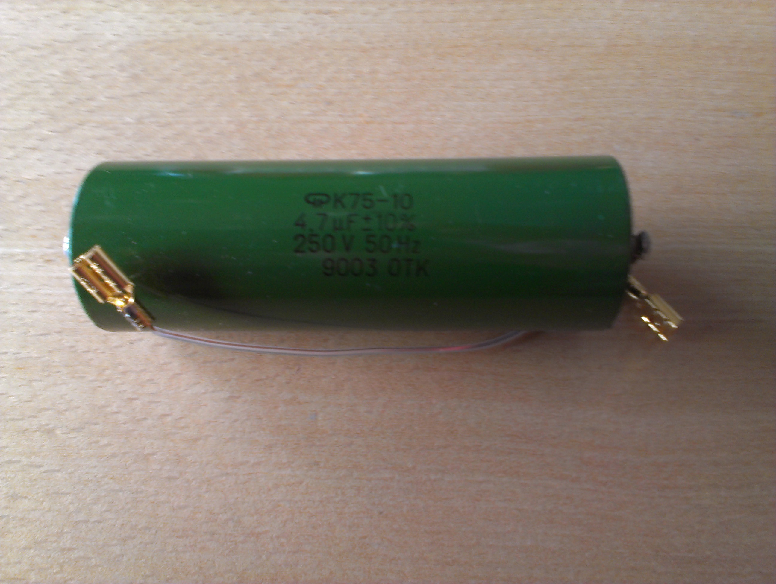

K 75-10:
Very warm and with a big room.Loose in the bass. Not that good seperation and loss of details and transparancy, but a nice presentation.
K 40y-9:
More details than K 75-10 and better separation. Better bass , but still on the soft side Still on the warm side with a broad pensel like presentation.
K 71-4:
Very transparent and nice tonal character, even though a triffle cold sounding. Good depth and separation. High frequencies now comes better through and fast transients are rendered nicely.
T(obias)J(jensen) paper in oil:
This was the big surprise..A little warmer and a little softer in the bass than K 71-4 and with almost the same high frequency detailing and transparency as that.
Difficult to choose between the last two, as they are both very good.
IMHO the best capacitor still is no capacitor, though.
More transparancy, better separation and the best bassdefinition.😛
Then each cap.

Russian Teflon:
K 75-10:

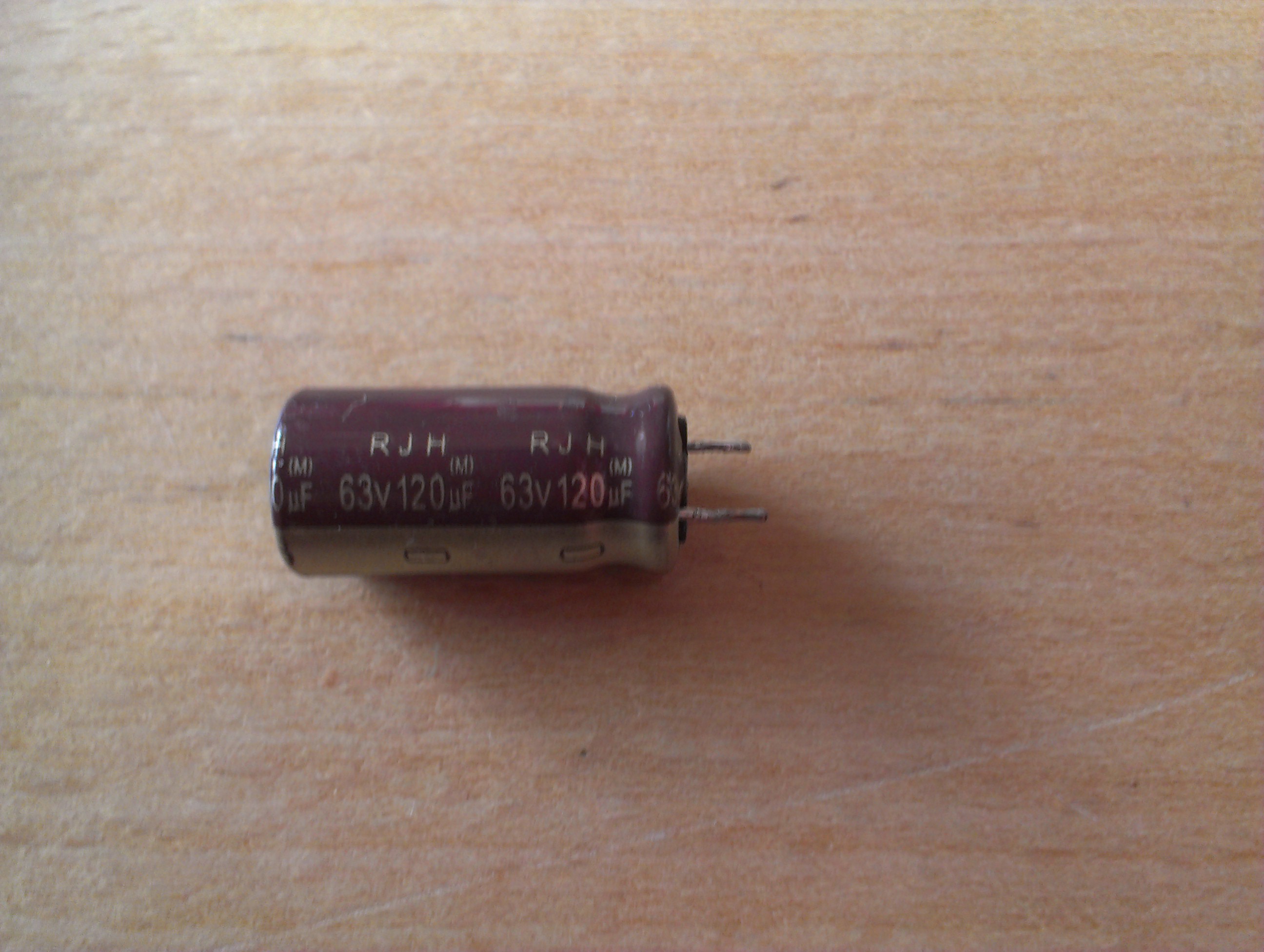

I also had a go on C9.
This is where I think the biggest improvements could be..
I only had a Elma RJH to try:
Smoother and cleaner than the Nichicon FG - more musical BUT at the expence of transients and a too dark overall sound.
Very hard to choose between these two compromises.
I really hope the BG will solve this!!

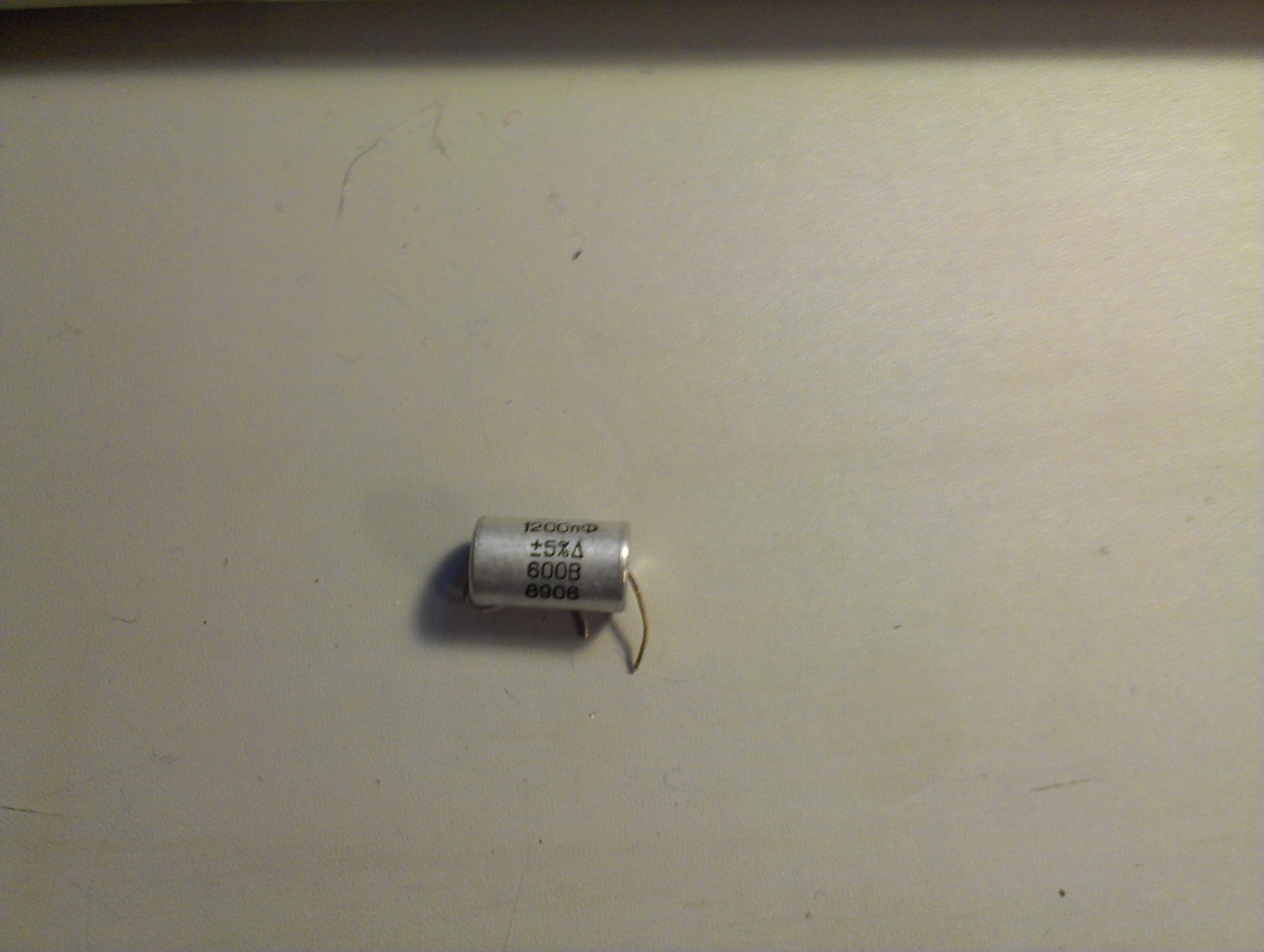

Then there was the two FKP2 C30 and C32. The differences are not big, but:
First i tried some russian Silver Mica, but they were cold and shrilly and thin.
The some russian Teflon, but it was the same strange (not as pronounced) coloration as when used as C13.
I also had some ERO KP1838 (same as KP1834 but axials) and although they were not the correct values (100pF and 1,5nF) they went in.
No stability problems and I can understand why Dario likes these!!
They are natural warmeness with no loss of details and a very good spatial presentation.

Sorry, but my system is not better than this. Probably the noisy computer. For calrity I chose to display from 200 Hz up..I can't see the 50Hz to 350Hz spikes.
But then again -108dB peaks is not "very high" in my view and the harmonic distortion from the soundcard is still the dominat peaks. It still tells , even for a cheap and dirty setup like this, a story of an amplifier with VERY good specifications. All the other amplifiers I have had, having potential of being great amplifiers, have had order of magnitute higher distortion..
Thanks for the additional measuring 🙂
So, at this resolution, it seem the LM318 PSRR is high enough to avoid C102/C202, fine... 🙂
Obviously a more precise measure could change things and soundwise it could be different.

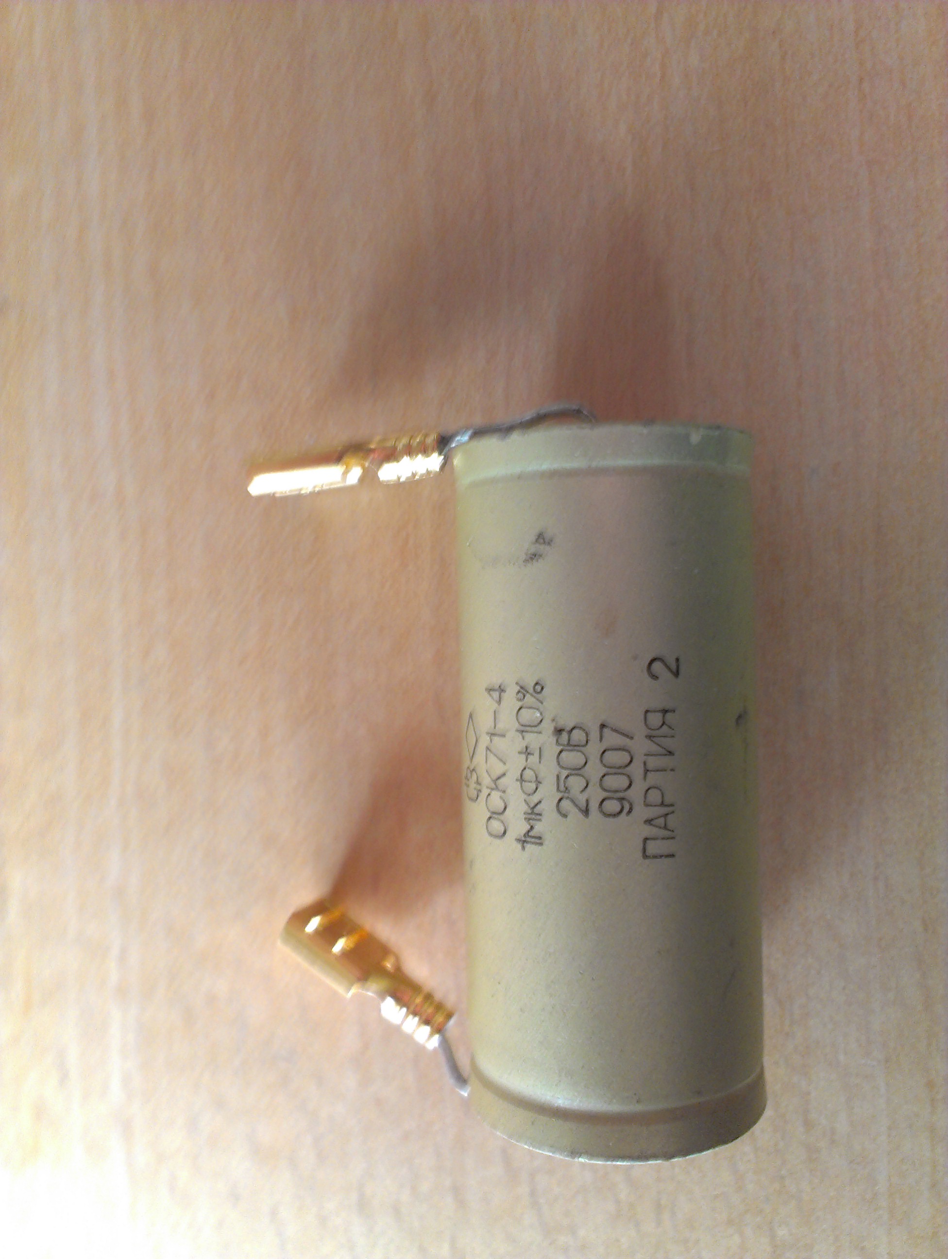

K 71-4:
Obviously best cap is no cap...
Your description of the K71-4 is really similar to mine.

another c13 option
In a previous post I compared the k71-4 to the audyn plus caps and each seemed to have good qualities in one area and lacked in another. The true coppers seemed to have the best of both worlds and I was very pleased. However I received a pair of jantzen silver z caps and have a new favorite.
I have been comparing the audyn true coppers against the jantzen silver z for a couple weeks with a variety of music and have found them both to be quite nice, but the jantzens are winning for several reasons. First and foremost is detail. The TCs are very detailed and I never felt that I was missing any of the music program while listening until I swapped in the silver Zs. The sounds of hands clapping, strings being plucked, horns being played is night and day different. The feeling of being in the room with musician is real with the silver Zs. Every recording since swapping these in has revealed more detail. Aside from the sound these caps are smaller than any of the others I have tried and should be easier to fit on the boards. Also they are easy to get in the US and are much less expensive than the TCs. I give them two thumbs up!

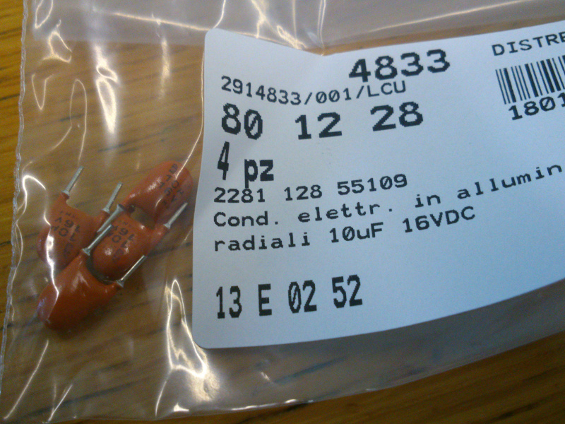

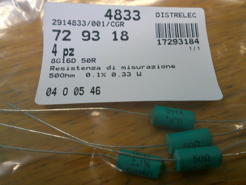

Dario, what are the new 10uF caps for? I assume the 50 ohm resistors are R101/201.

Regarding Rhopoints (or better General Resistance, Rhopoint is the distributor), they are pretty good sounding resistors, better than Mills.
They're detailed, full sounding, relaxed, easy on the ears.
But, when correct direction is used, they're no better than MPs, simply different timbre (thinner), a bit easier to listen to and a bit less detailed.
(See correct direction on pic)
I still consider MPs the best option but those Rhopoints are a fine alternatives, too bad for their price...
New caps are for C102/C202 and resistors for R101, R201, if you read the above passage you already know... 😉
I had some spare time , so I tried the direction trick, and I´ll be damned there is a difference (K71-4).
Not much but it is there.
To my ears when the text on the caps is the same direction as the 1uF text on the pcb, they are right
Russian Teflon:
K 75-10:
K 71-4:

Thank you Kolby. Very nice reviews and you have added some caps (for example, the TJ) that are new to me. Also thanks for the pictures. It is a really good idea that I will try to do so in future.
Overall, I have the same impression as you for the 3 Russian caps. I describe the teflons coloration as oily or slick. It is a strange sound.
The K71-4 is nice, a little cool, but a great cap for any FE build. In my system, K71 and TC were equal but different.
I agree that the K75-10 is warm, but lacking in detail and separation. I have found that the K75-10 bypassed with a small polypropylene cap keeps much of its warmth and adds detail and improves soundstage and sparkle. I am using a 1 uF K75-10 with a 1 nF AMTRANS AMCH. Since your K75 is larger, I'm not sure what size bypass would be best, but since you have the K75, please give it a try with a bypass cap and see what you think.
There is one difference, probably due to system, listener, etc. Like Dario, I don't like the sound of the FE without C13. In my case, the bass is not as deep and the mid-range sounds too forward. Different answers for different people. Isn't DIY fun?

To my ears when the text on the caps is the same direction as the 1uF text on the pcb, they are right.
Koldby
That matches my experience. Same direction for best sound in my system.
