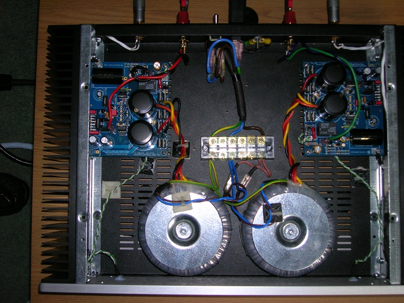

Hi Bob
Thanks for the welcome and yes I’m pretty impressed with the sound that the My Ref FE is making which seems to be improving as things start to settle.
I suspect that those Black gates will need a little time to break in but even as is its sounding great.
A very musical amp
And a nice surprise as I was unsure what to expect sound wise.
All good so far.
A very musical amp
All good so far.
Just curious, are you using sockets this time around or are you soldering/de-soldering?
Tabs and fastons, as usual
Inviato dal mio LT22i usando Tapatalk 4
Hi Bob
Yes 2 x chassis mount fuse holders up by the traffo’s one for each primary. only one cover on at the moment but I’m not going to be plunging my hand (or anything else in there) with it switched on.
Yes I’ve read the comments about putting the fuse between the switch and mains input but those 300VA transformers suck a lot of current at switch on. I’m not wanting to faf around with a soft start and I’ve always worked that way with big traffo’s without issues.
Oh by the way I forgot to mention that I have no switch on/off pops which is nice.
My home mains is newly installed so I’m happy enough with RCD protection should the 15A rated switch short.
Nope only the reckless would go fuse less
So good point well taken
