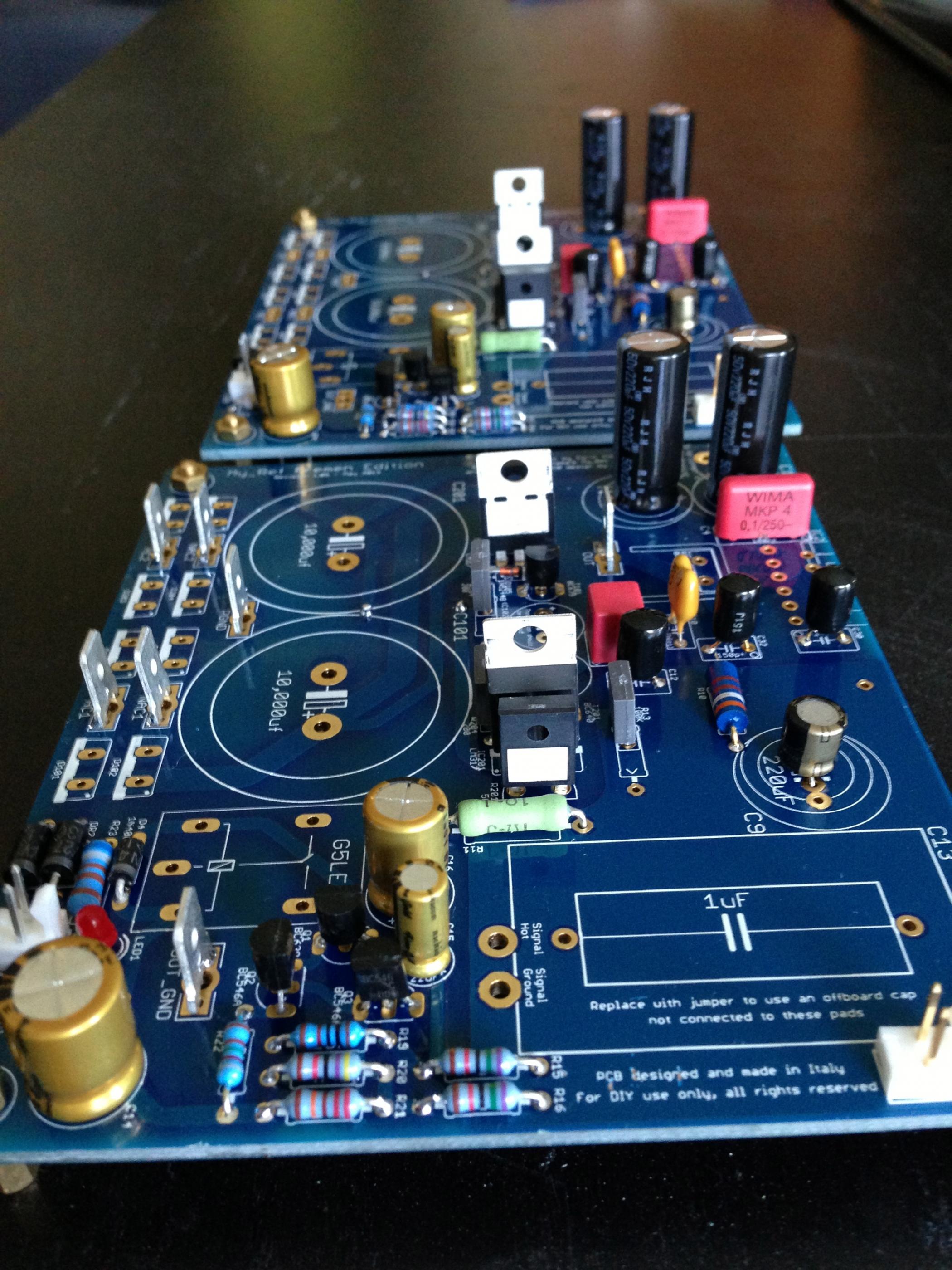

2nd build
So I have almost completed my 2nd pair of amps but to my dismay I ended up not ordering the extra 8- .25" terminals. So close but yet so far.
Also I noticed that there are two different types of On Semi transistors in the BOM:
bc639g tight terminal spacing.
bc639-16zl1g proper terminal spacing.
Im not sure what the difference is but if they are the same the 16zl1g is easier to install.
BC639G is for DC protection circuitry
BC639-16 is for the shunt regulator.
Probably the ZL1G suffix is for bent leads version so BC639G with bent leads became BC639ZL1G
