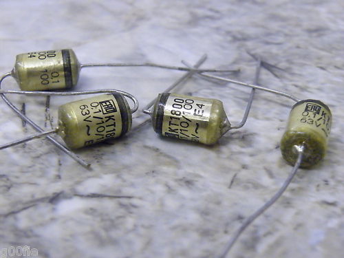

Ps. Got som 100n polystyrene caps from E-bay and tried them instead of the 100n MKP4 decoupling and they stay there...
Can you post a pic/ebay auction?
