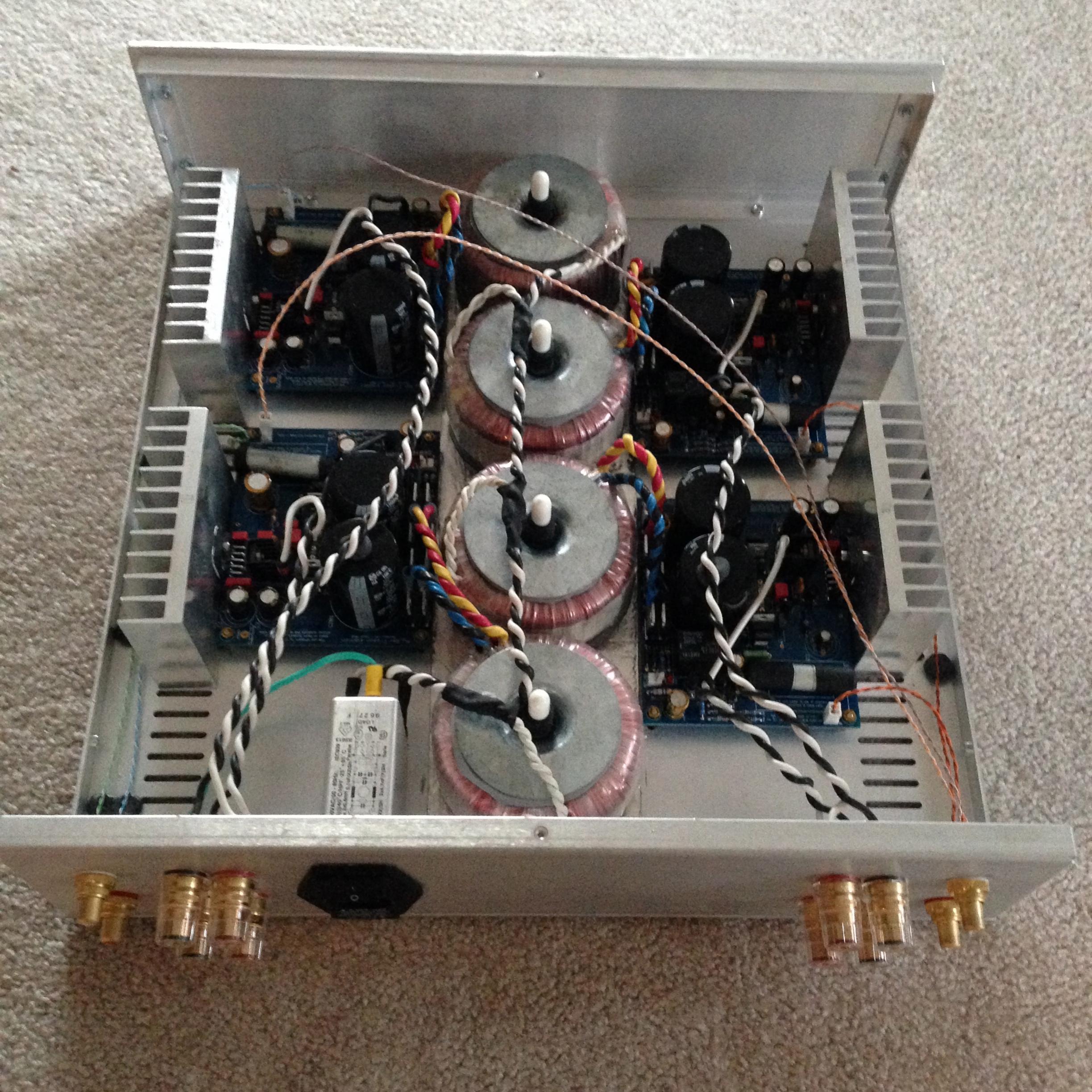

Hi Bob, that's an interesting build you have there. If you get no noise from the transformers when they are so close to the boards, then I should have no problem making mine monoblock's.
It's my understanding that the strongest field comes perpendicular from the "Doughnut Hole" at the core of a toroid transformer. I tried to locate that over the PS section of the FE boards. It's still extremely close to the signal elements - but there doesn't appear to be a problem.
If your monoblocks have the transformer mounted to the bottom plate of your chassis, that can only aid in defeating any interference.
Cheers Bob, I had planned to mount the transformer on the bottom plate. I was going to order two new ones but I have decided to re-use the enclosure and 22v 300Va transformer I already have. I have ordered another identical enclosure for the other monoblock along with an extra back panel for the original enclosure. This means I now only need to buy a second transformer and that's everything taken care of.

I still don't understand the "extra shield" on the Antek units. When they are connected to earth ground a horrible hum is created. I just left that connection open.
Bob, that's an interesting minimalistic placement of boards, connectors, trafos, etc. - the bulk of the weight is contributed by the trafos, I expect.
Regarding the hum, it depends on how the earth wire to the shield is connected - in some cases, it creates a half-turn winding on the trafo that can contribute a significant hum (probably of the order of 100s of mV).
In this respect, the waist-belt copper-foil shield on EI trafos is better - almost any Earth connection to the band doesn't create an additional parasitic winding on the core.

The extra shield produced a hum so strong that it could possibly cause speaker damage. I'll investigate further when the amp gets back.
