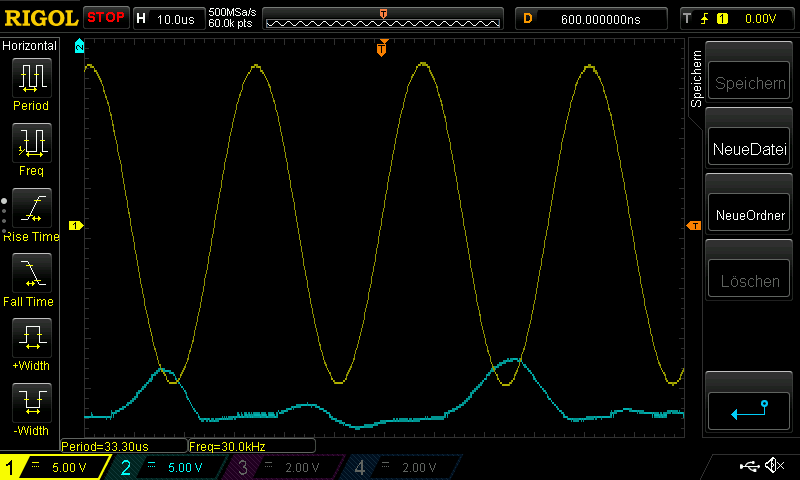

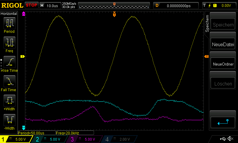

OK, I tried with less, the power supply was also too weak. Now I powered from regulator board with 40V, at 30kHz and with 60pF in the miller, with 470/150 and 390/680 I get this from the 15003s from 1.3V sine input which equals 130W into 8R with 1uF added (the blue trace is the output of the regulator board):

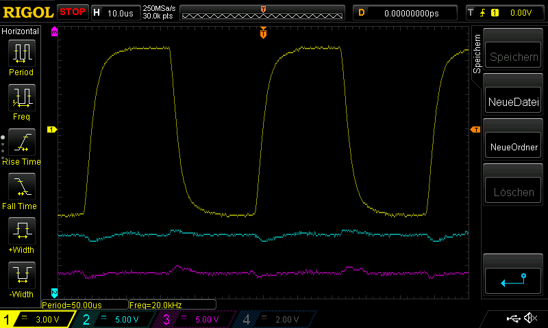

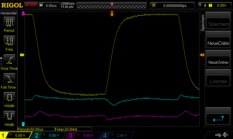

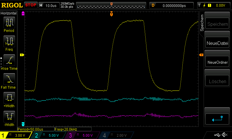

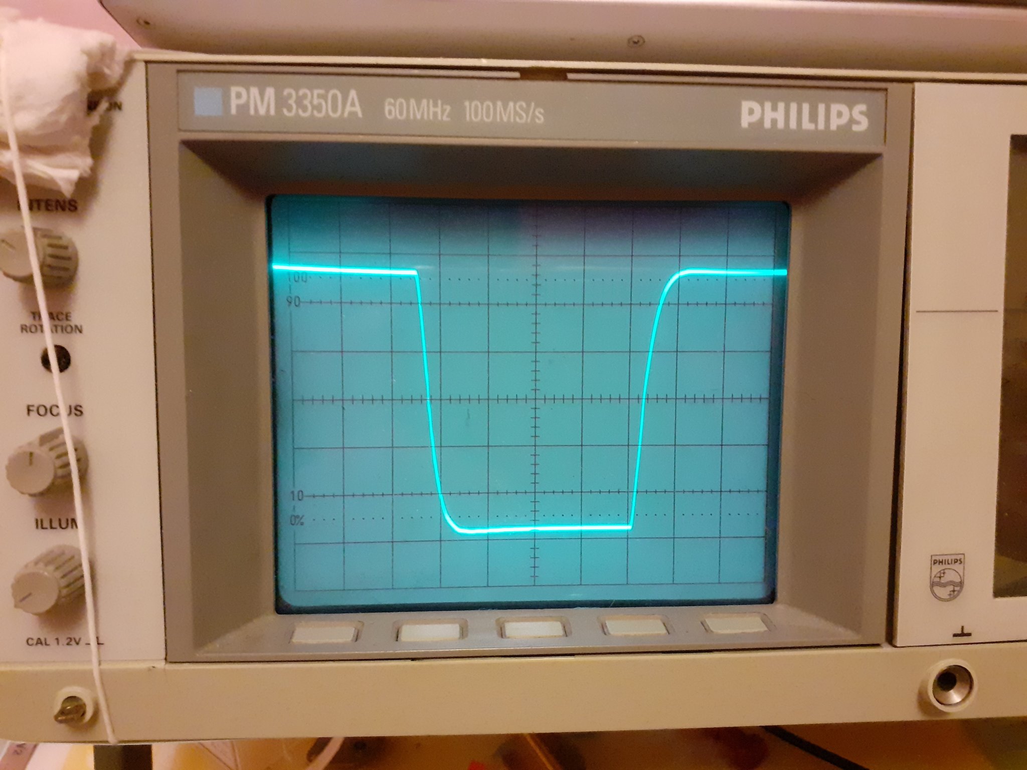

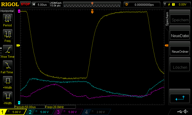

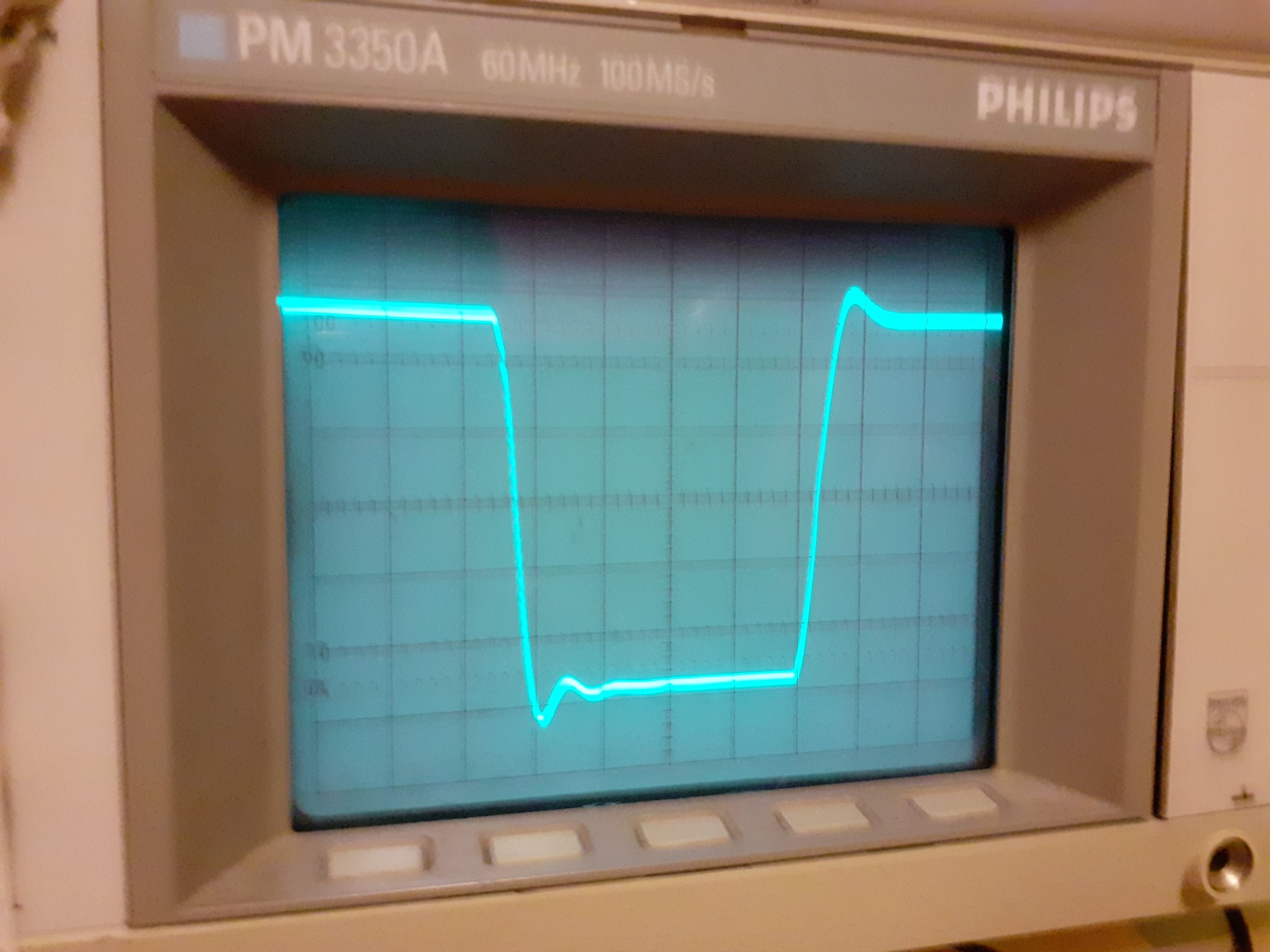

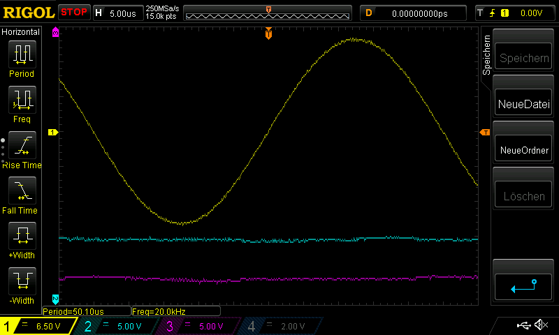

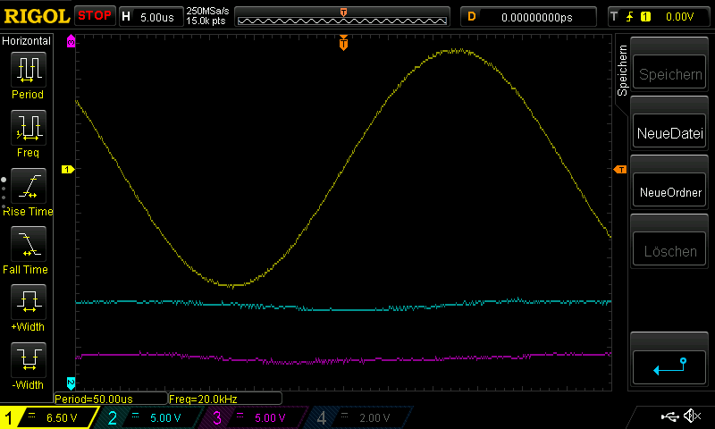

Here some of my scope shots: 01 is the Naim board with the Naim regulator board, 02 is my clone (with 15003s) on the Naim regulator, 03 is my clone on Jeff's inverted regulator circuit. Values are 39pF, bias across 2 emitter resistors was set to 7.2mV, compensation network with standard resistor values. The blue trace is the positive supply rail, purple is the negative supply rail, yellow is at the output with speaker cable connected, 8R load and 1uF in parallel. The Naim regulator shows flat supply rails, the inverted regulator board shows some minor wobble (the Naim regulator only starts to wobble a bit if I go further up to 1.5 or 1.6V input).
I don't think R25 changes the sound. It's only for idle Bias current (my schematic shows it's 2k7. But I don't think I used 2k7). If you use degeneration resistors. it solves most of the oscillation problems. Do you use? If you use and you can test, try 22ohm degeneration resistors. Oscillation can start, control it. I know that THD decrease with 22ohm value. for 10-15ohm oscillation really starts then R5&C5 will be really necessary.

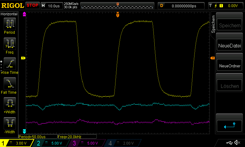

do you observe any difference in sound with regulator?And here a 0.5V square wave of 20kHz into the same 8R / 1uF load:

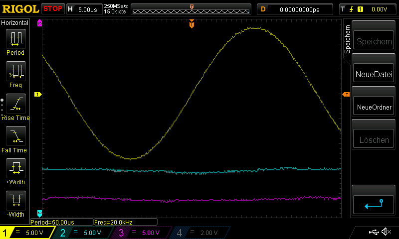

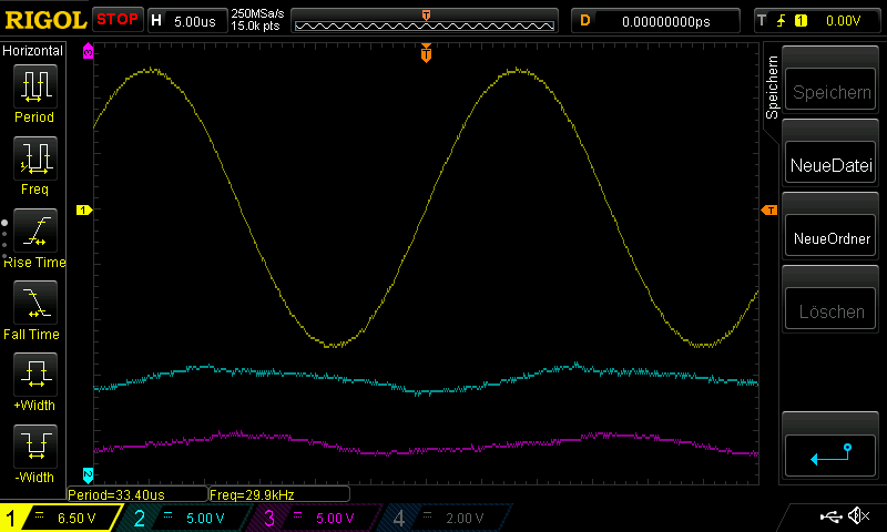

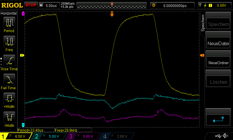

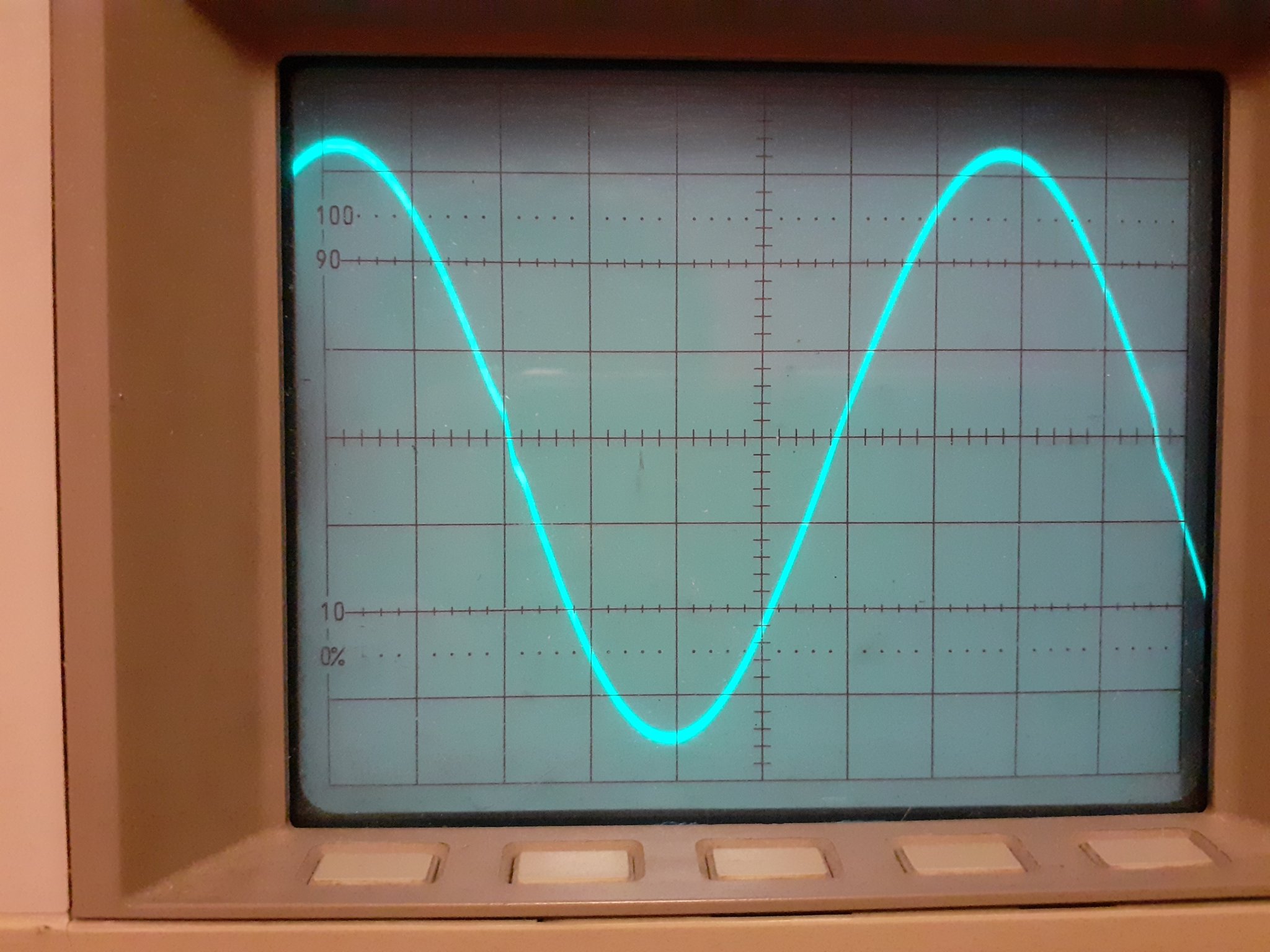

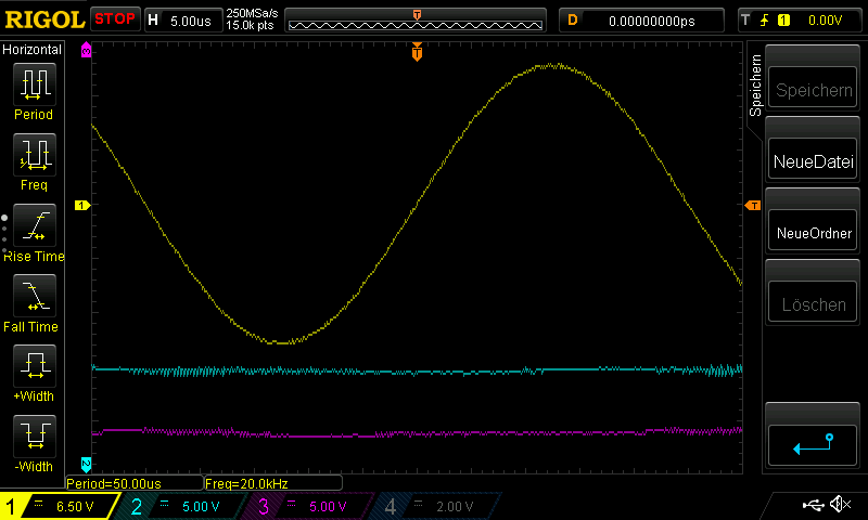

I also don't use degeneration resistors. I made some tests with my BUV21s: I can confirm Cristobools values of 39pF, 150/470 and 1K/680, and as he said the BIAS needs to be cranked up - in order to get rid of cross over distortion I needed 70mV idle - way too high, but the signal looks fine up to 30kHz and up to 130W into 8R/1uF:
And here with normal bias (7.2mV) at reduced power (1V input). Very faint cross over distortion is visible from 15kHz as Cristobool said, but as it appears only at higher power and frequency I guess a stronger driver should solve the distortion (first pictures with Naim regulator, second pictures with Jeff's inverted regulator):
This is probably why some clones using the BUV21 use MJ15032/33
